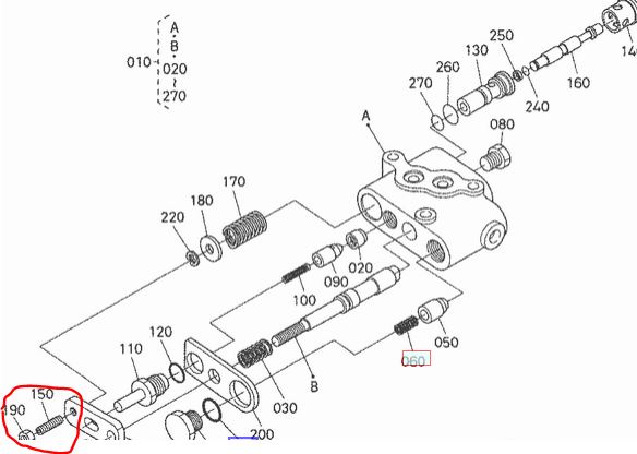

I finally got around to doing mine... :ashamed: :eek: I bump mine up from 2250 to 2400psi... with just turning the nut that holds the shim in :thumbsup: (no drips, no oil, no mess) and took less then 5 minutes. I added 200+ pounds (tooth bar and grapple) and didn't want to lose too much lifting power.
Photos of the gauge and which nut to turn are shown in this thread: (third post)

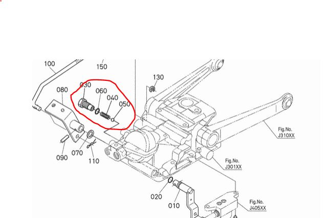

I cant say on the L3130, but on the L3400 there is a plug with a spring and ball. This is the pressure relief. By shimming the spring with washers, it makes it harder to open. Thus generating more PSI to open and return back to tank. Check your operators manual, it may say.
   / Bump up lift capacity of L3400/LA463 Loader #140
I have a Kubota 3130 w/ L513 loader, I would like to bump up the lifting pressure. where is the adjustment for this?
Best check your pressure first. I bumped up my l3130 because it was close to 1000# low. I put it at 2600# and it of course made a huge difference.
Your loader is of course the weaker one so you are not going to make perform miracles.
The pressure relief is under your right foot. Your loader supply hoses come from the valve. Just take out the 22 or 24 mm nut and the whole relief valve comes out. The shims should be between the nut and the spring.
