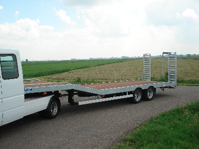

We convert Mercedes Sprinter and similar vehicles to air brakes and 5th wheel, and build 5th wheel trailers.
Couple of months ago, a customer complained about a trailer we built for him. Its a 5 ton gross weight trailer, 1500kg rated 5th wheel and 2x 1800kg (3600 pound) axles. and ultra low 255/50 B12 Trelleborg tires.
He wanted a price for a new trailer, but he'd rather sacrifice the deck height, to put 14" tires under it, because he thought the Trelleborg balloon tires were too small and fragile. He thought his trailer was up, because the frame also cracked.
Then a warning light lighted up in the back of my head, and i asked him what they did with the trailer... Hmm nothing special really, our guys that make sports fields use it to haul the MF 4200 series farm tractor (4000 kg ? ) and scraper/grader (1000 kg ?) and rotavator (700 kg ?) and a 400 liter fuel tank and a trailer mounted boom crane (600kg) to the job...
While he was talking, he realised that he -MIGHT- be overloading that trailer, as the Net load rating is 3500 kg while he was taking allmost 190% of that....
We made the customer an offer for a trailer like attached below: with air suspension, air brakes, ABS, and 2x 3500 kg axles:
My point is, what would happen if he used a bumper pull trailer with the same light duty 1800 kg torsion axles, overloaded by 180% ??? He wouldnt be able to live and tell !!!
Carrying trailers more than twice the weight of the truck, gooseneck is definately the way to go !!!
Another safe way is a turntable steered 2 or 3 axle trailer, but that is just a b*tch to back up, when you have to steer on mirrors instead of direct sight.

Ive just stolen the design of that trailer . I was going to do a knock off of the H&H Speed loader Goose but have changed my mind . You still can use the trucks deck space on yours as the trailer deck takes it's place .
