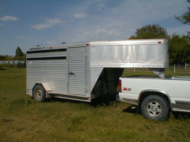

Here are the promised pictures of my little gooseneck horse trailer on my half ton truck.
Tonight I had to leave 4H a little early. I was boxed in with a trailer in front of me, one on either side, and a fence behind me. I jackknifed the trailer past 90 degrees to squeeze between the two trailers on either side of me and was able to get out with about 6 inches to spare on either side. I couldn't have done that with a bumper pull.
This is all relative. It depends on how close the trailers were parked on either side of you, how far back the fence was, the length of your rig, the length of the rigs parked alongside, etc.
Depending on all the above factors in some cases a BP would be better, in other situations a GN would get you out. Like Reg said, it depends on the geometry of the particular situation. A blanket statement can't be made that one type is more maneuverable than the other in all situations.
