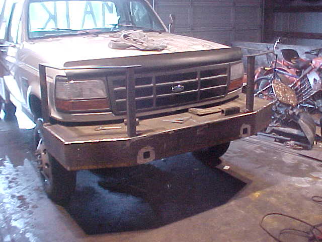

Thought I might share a bumper I am building for my 1 ton.
I am headed for Alaska for the summer season and the fellows told me to take extra headlights and expect to replace the windshield, and don't forget stopleak for the radiator. I guess rocks are a problem when the big rigs go by.
The front is 8 in channel, the uprights are 2X2X3/16 tube that fit into sockets so the front screen can be taken off easily. The two front holes are made with easy lift receivers so I can put anything from balls, hooks or a tow bar if need be as I will be operating a road grader.
As you can see I have the screen to install and will update, hopefully this evening.

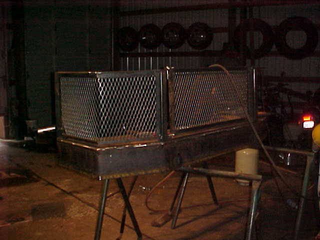

Too many interuptions, should hav had this thing painted by now. Have the other side to screen, but thought I'd share how far I have gotten. Thought about putting some of those high intensity lights in there, but will wait to see how it is with just truck lights, after all, it will be daytime 24hrs when I get up there.

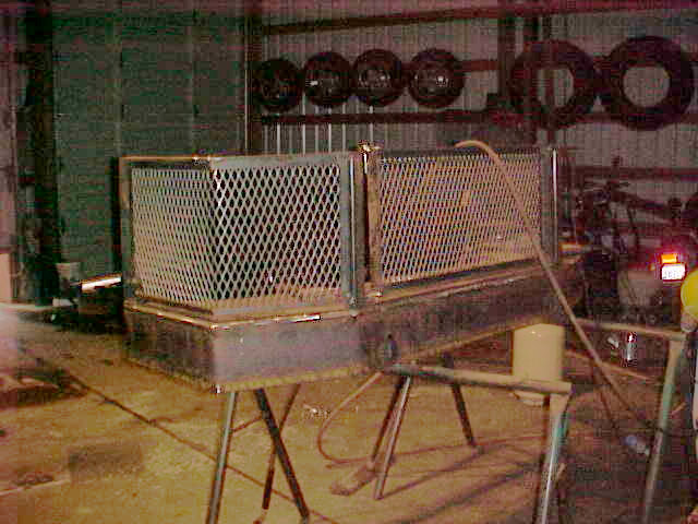

   / Bumper #6
</font><font color="blue" class="small">( To dark will have to do better than that. )</font>
This is a little better.
   / Bumper
Yes, thank you Spence. I just finished the other side and now to take it apart and finish grind, sandblast and paint.

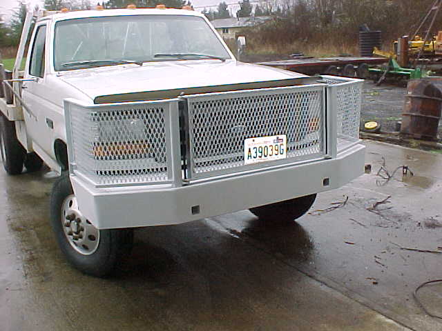

Finally got it finished. Won't make the beauty page, but will keep rocks out of the grill and headlights.

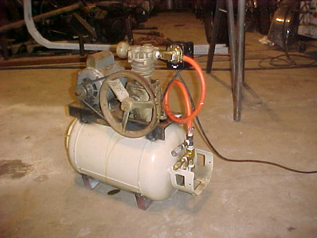

Had a small sidetrack. Nephew and I made this little compressor out of some parts lying around. Doesn't put out a lot of air, but will be handy if I need it up north. It wil punp 125lbs, but takes a while.

Randy, does this preclude using the lights at night ? /forums/images/graemlins/confused.gif
