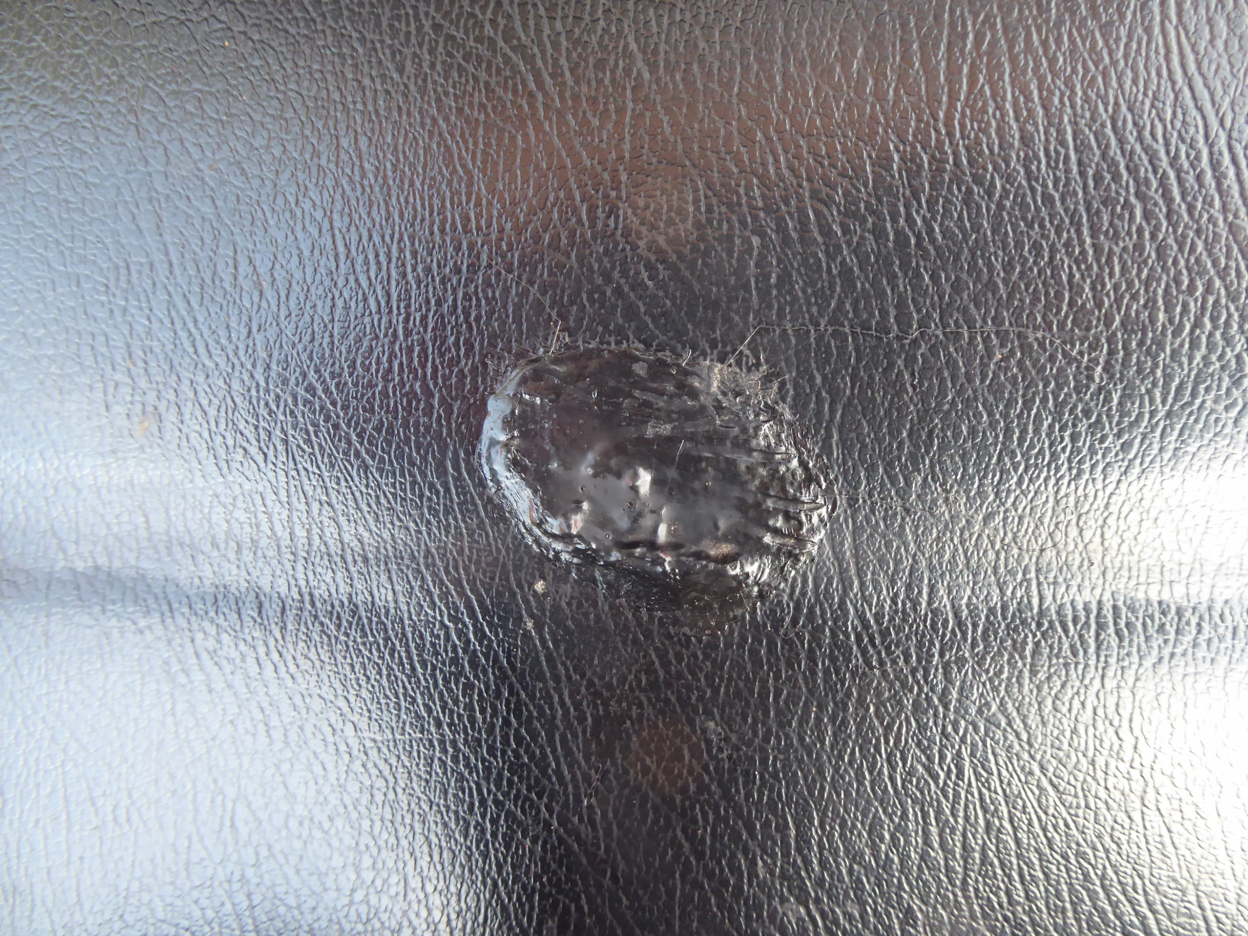

Pick up a tube of Dow 995 structural caulking. Fill the hole and spread it over the top. That stuff will never come off and it will patch the hole for ever.

Maybe fill in with black RTV and smooth it out best you can. I know, it's a redneck thing. Tape will get loose and stick to your britches.
I've done that on several seats and been pretty satisfied with the results. Nothing smooths RTV out better than spit on a fingertip...

Update: Well my seat repair last September ( see post #17 ) using Liquid Electrical Tape made it thru the winter unscathed. Used the tractor all winter and keep it outside too. It's not the smoothest job but it is sealed and was very easy. Just daubed on a couple coats.

I'm glad to hear that the winter weather didn't cause havoc on the repair Gordon! I bought some of the same stuff you used and fixed a small tear/hole on the upper backrest of my seat and it's also been holding up superbly. I just dabbed several layers on - as you did - and it's been holding shape just fine.
Thanks for your initial post and the follow-up. Greg
