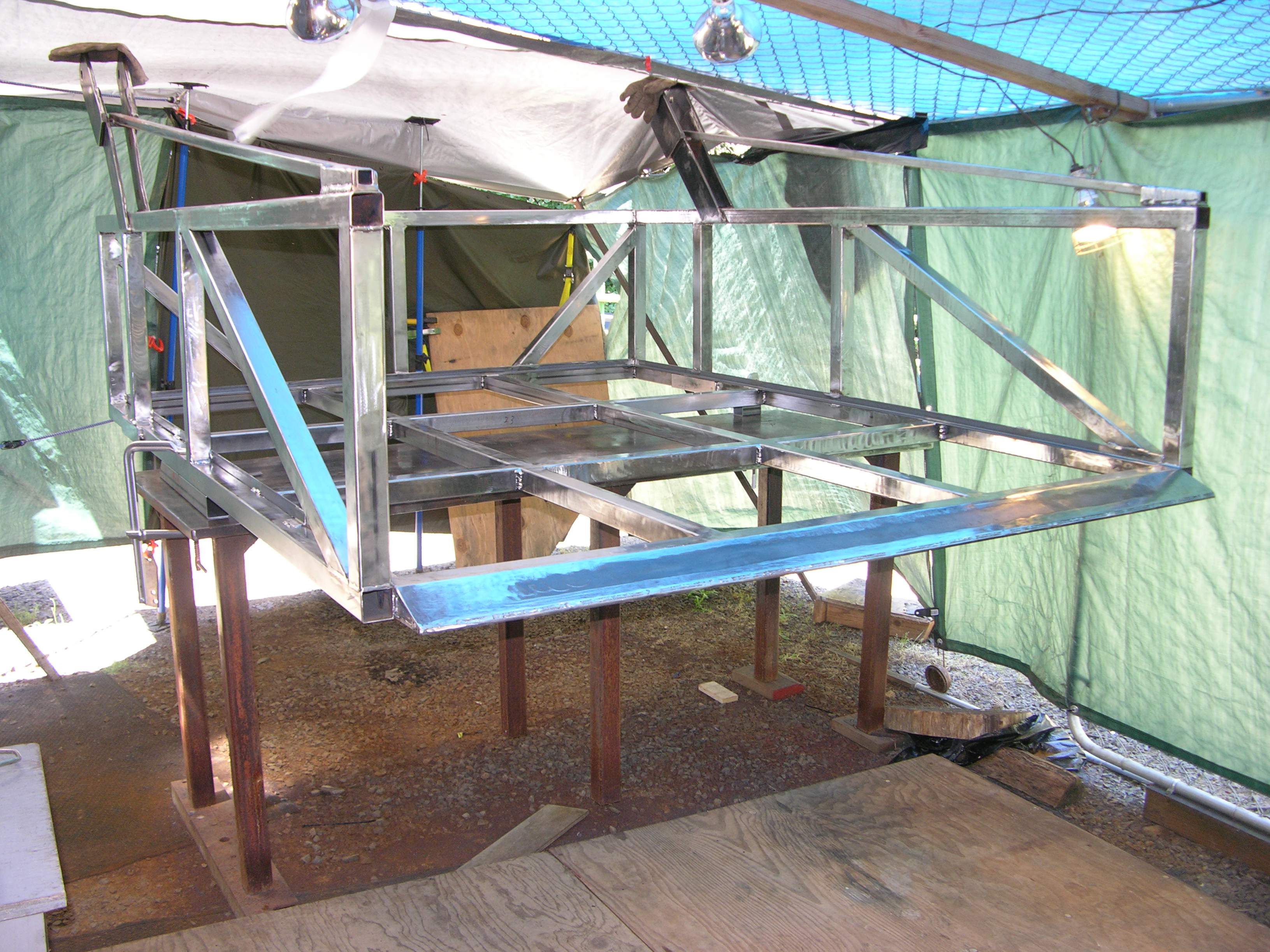

Here's what I was working on, wanted a smooth "ramp" in front (wife's garden cart - this is my 6' x 8' brush bucket, and I'd promised her to make it easier to load than the "V 1.0" version) - I also didn't want to get a bunch of crap inside, hence the (hopefully) hermetic welds in most areas :rolleyes: ... Steve

Not helping the economic recovery, Steve by putting the local metal polishing outfits out of business.
Terry
   / Burned up my M 25 mig torch #19
Prob'ly not Terry, but it sure makes the paint stick/look better, plus if I DIDN'T do that then Sodo would hafta find somebody ELSE ta pick on :D:D:D
'nuther thing - I pretty much NEVER worry about my welds this way - I built that brush bucket out of 2" .095 wall tubing, trussed all 3 sides, skinned it with 14 ga. sheet, intending it as an "upgrade" to a "found material" frame I'd used for years - I fish plated the tubing with 1/2" flat bar where it contacts the loader bucket so it wouldn't buckle there, figured it'd hold me and a load of brush/hedge trimmings (works good for cleaning up fir trees too, I can stand at the end of it 12 feet in the air, cut off a limb and throw it over my shoulder, repeat... then I climb over the pile and back down the loader arms, drive to the burn pile (or woodshed if limbs are big enough) and I only handle stuff once or twice.
Last month I got a few loads of firewood, guy was scraping by and not really set up so we unloaded his trailer into that "brush" bucket, got it so heavy the curl cylinders wouldn't pick it up but my "shiny metal" welds held just fine for about 3 TIMES the weight I'd intended.
Sorry for the hijack mx842, I'll try to be good now :ashamed:... Steve

Awhh heck!! no worries I sometimes get caught bushwacking a thread now and again myself. Speaking of bushwacking.....that's a mighty fine looking brush wagon you have there. I don't have a tractor with a front loader on it but I can see what you have there could be very useful. Nice, neat build too.
