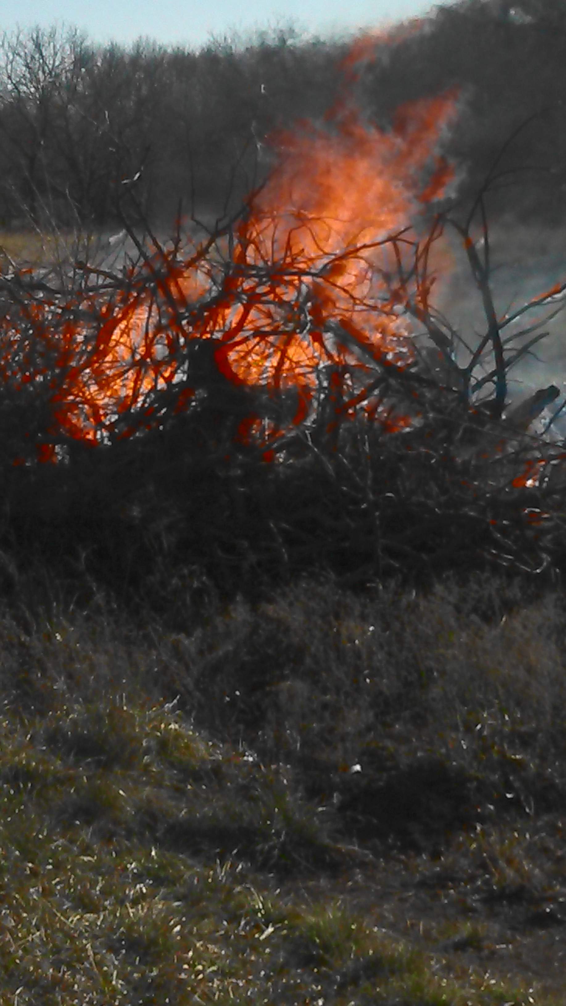

Wow, I guess I am nowhere near as considerate. I wait for a rainy day with some wind and light it up with a propane weed burner. I also do as mentioned previously pile debris into long 10' wide east-west rows ahead of the burn. I then light the end the wind is blowing from (always west to east or east to west where I live) and let it burn like a cigarette. Alternately, I burn on an old stump and "flip" load it with a FEL carefully at a safe distance from up wind. Larger pieces of wood that do not burn completely get pushed into a pile a few days later and re burned.
