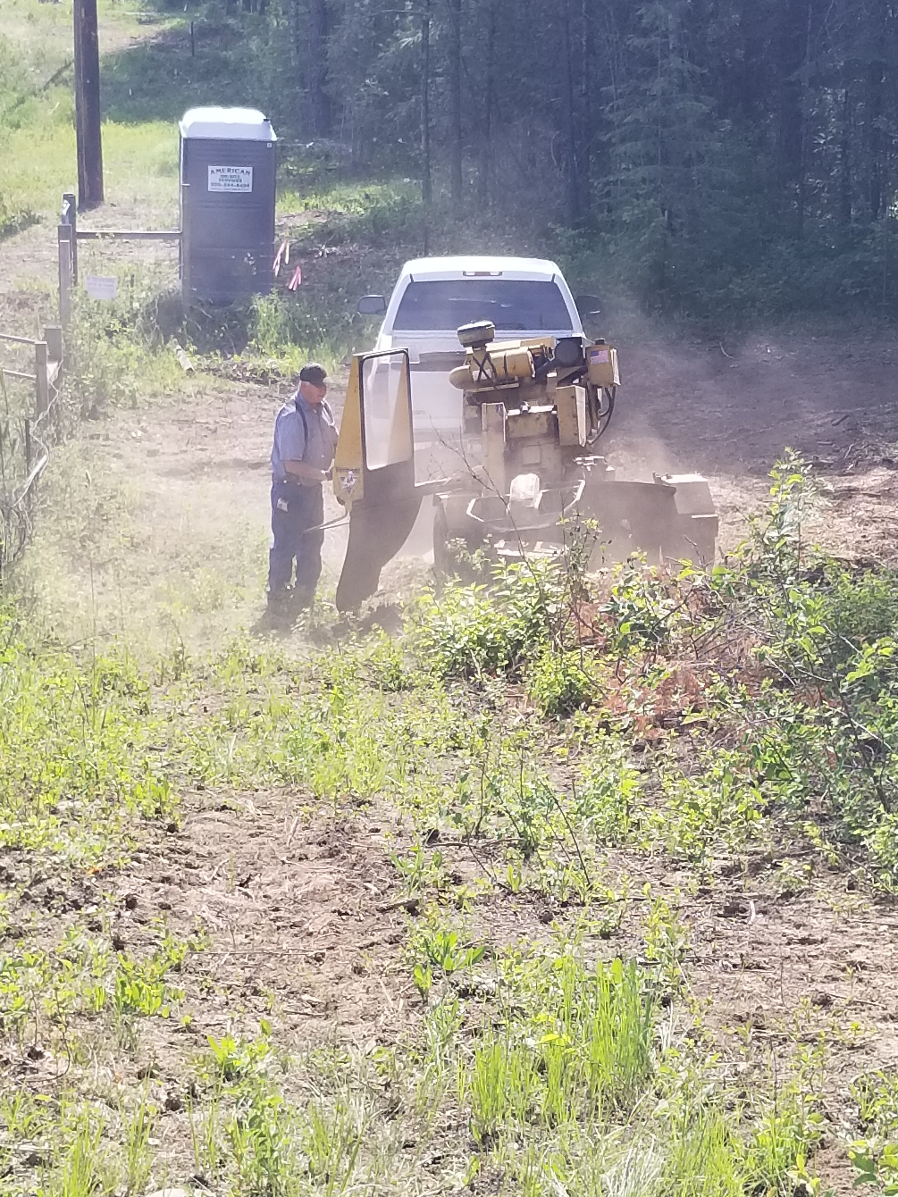

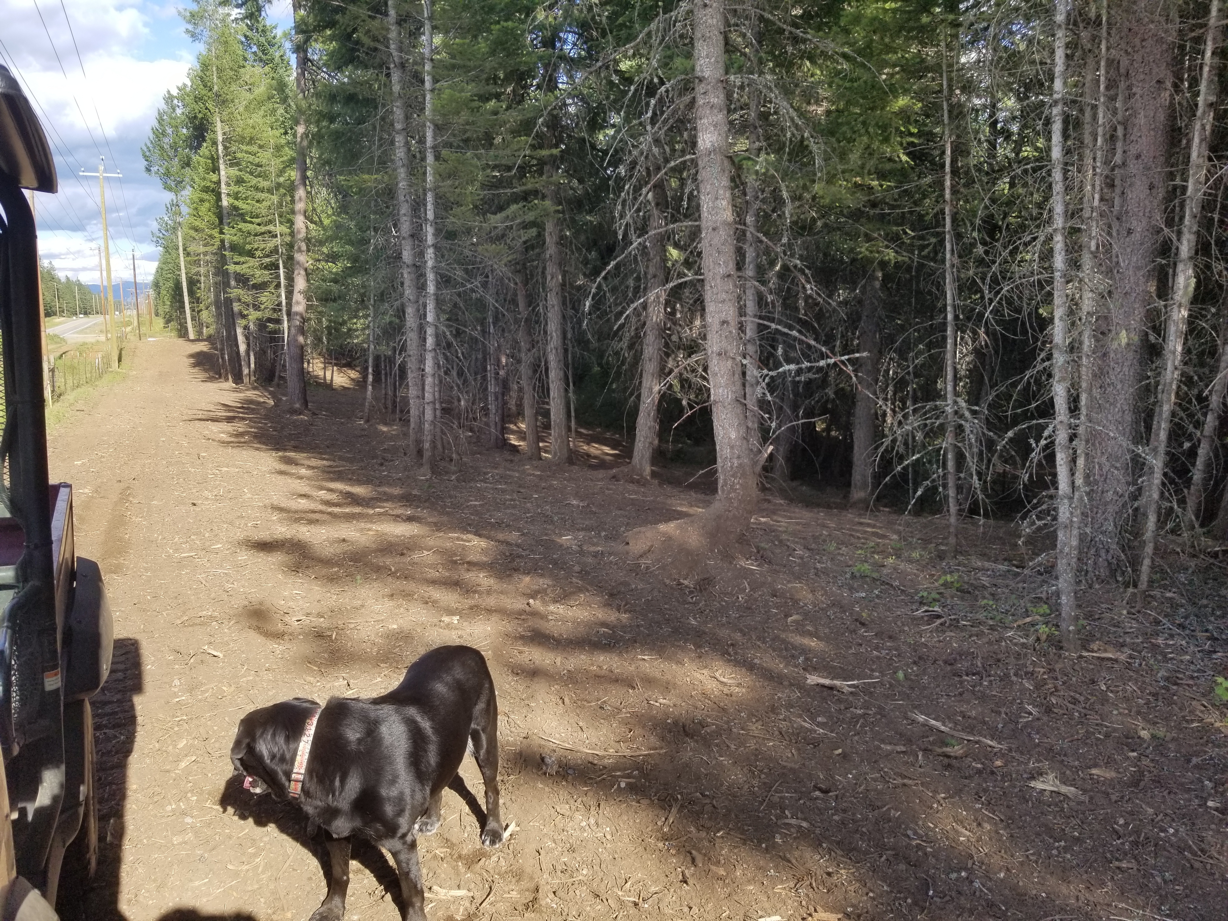

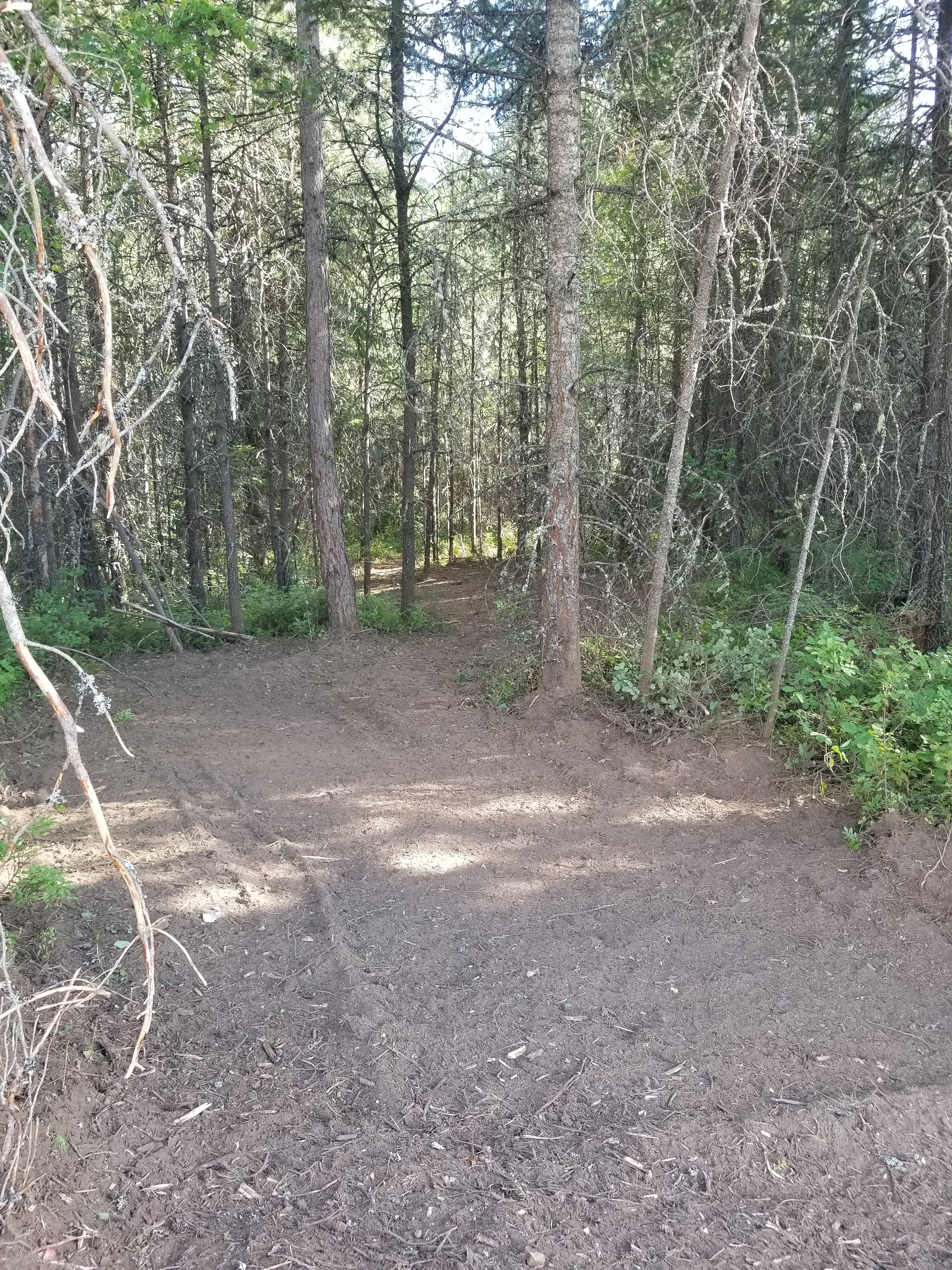

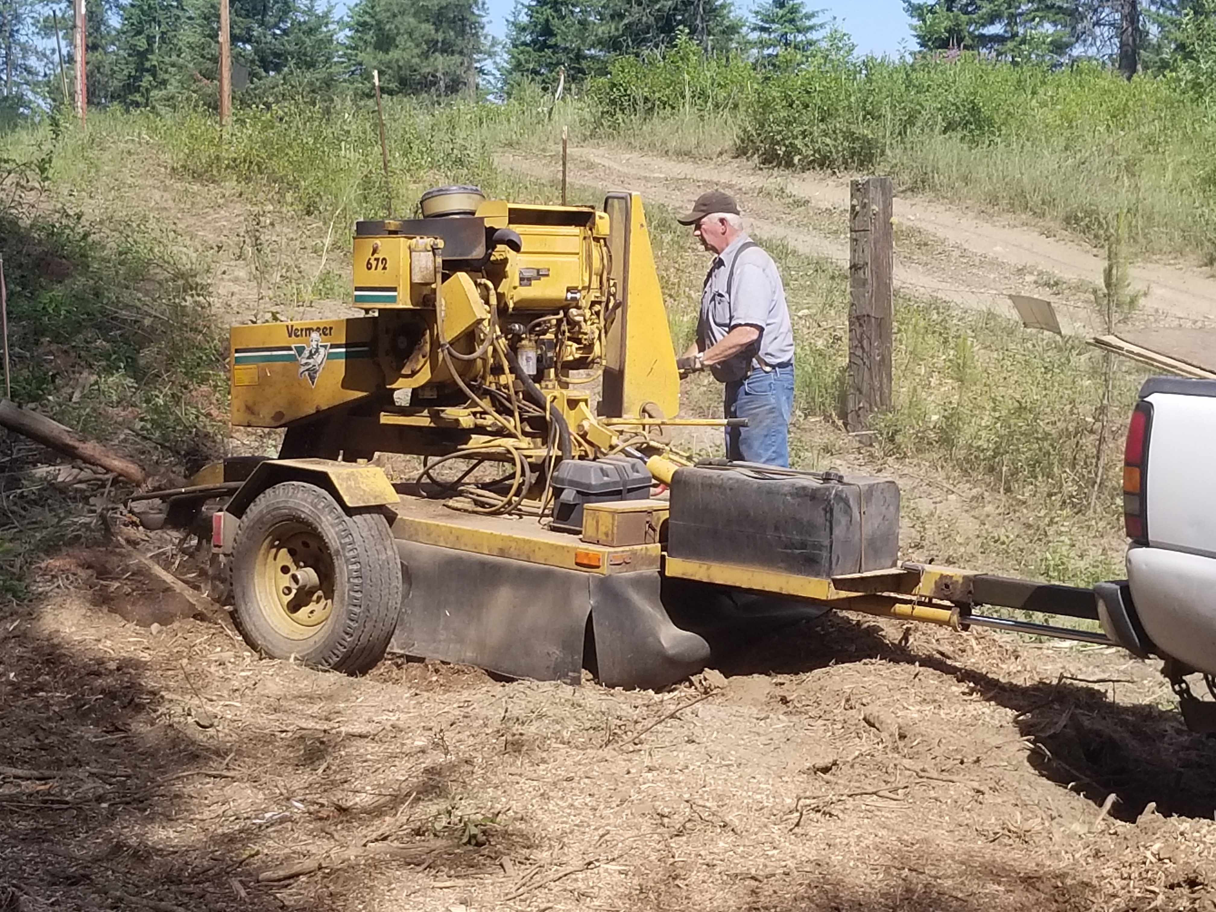

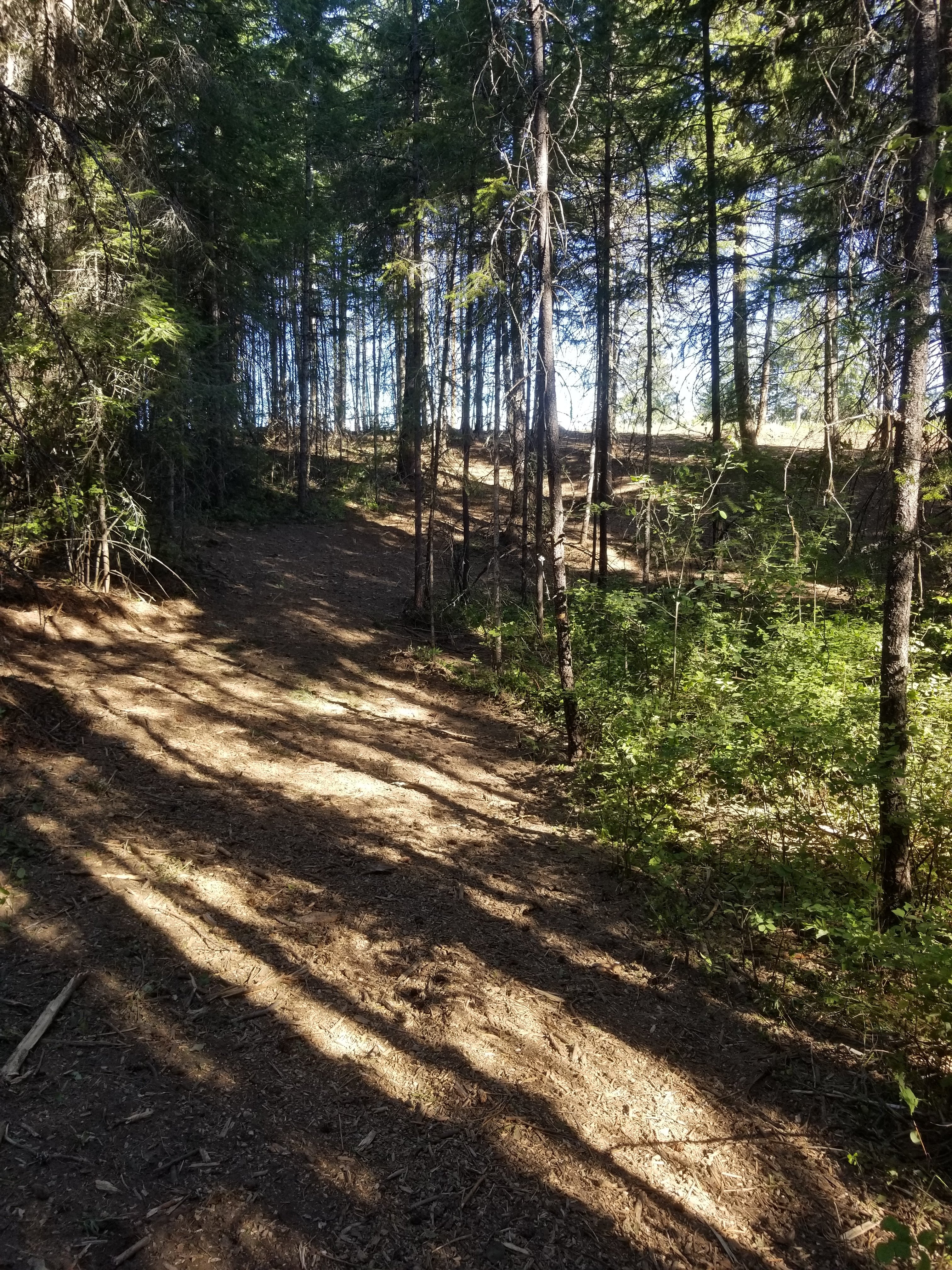

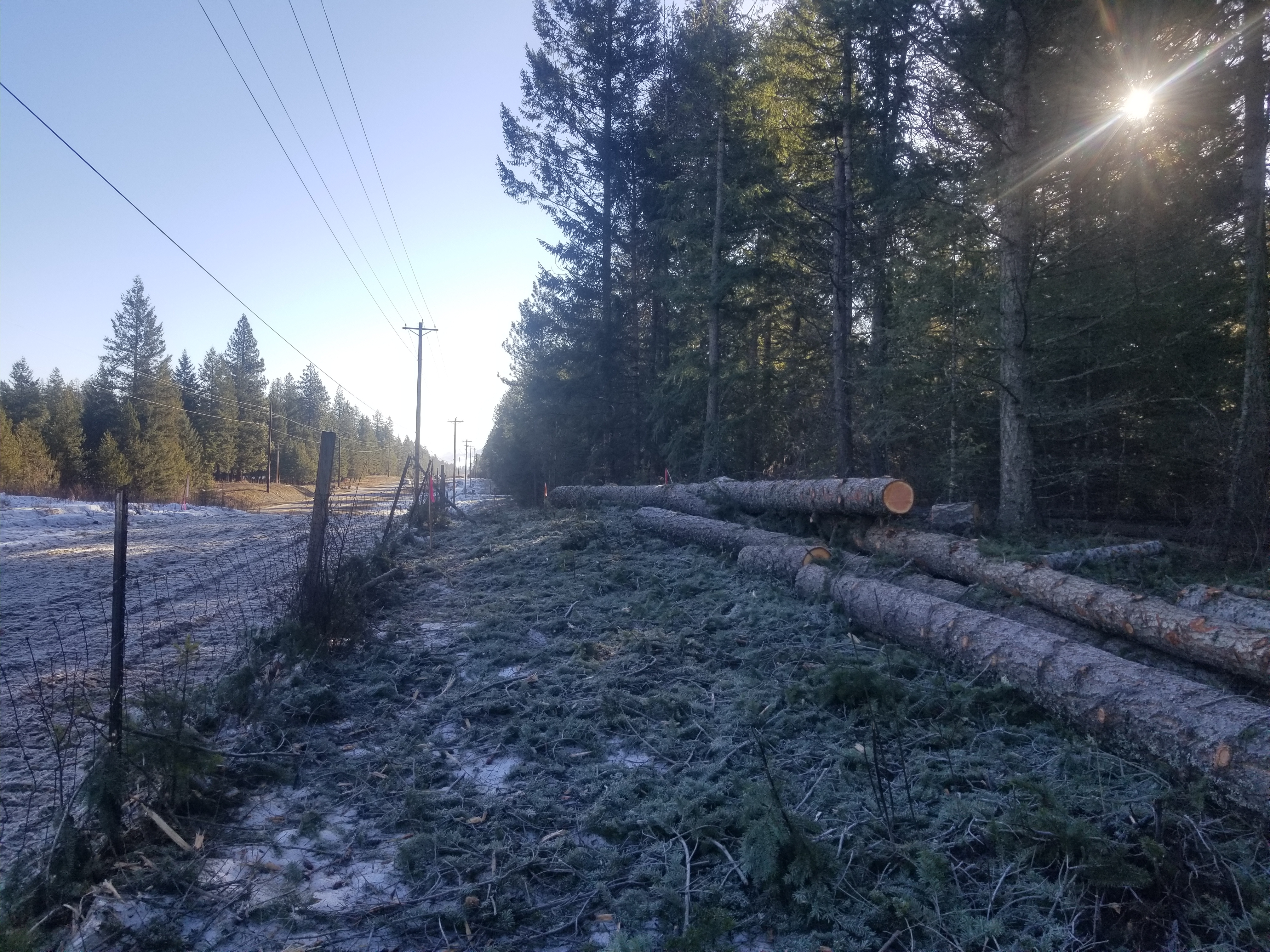

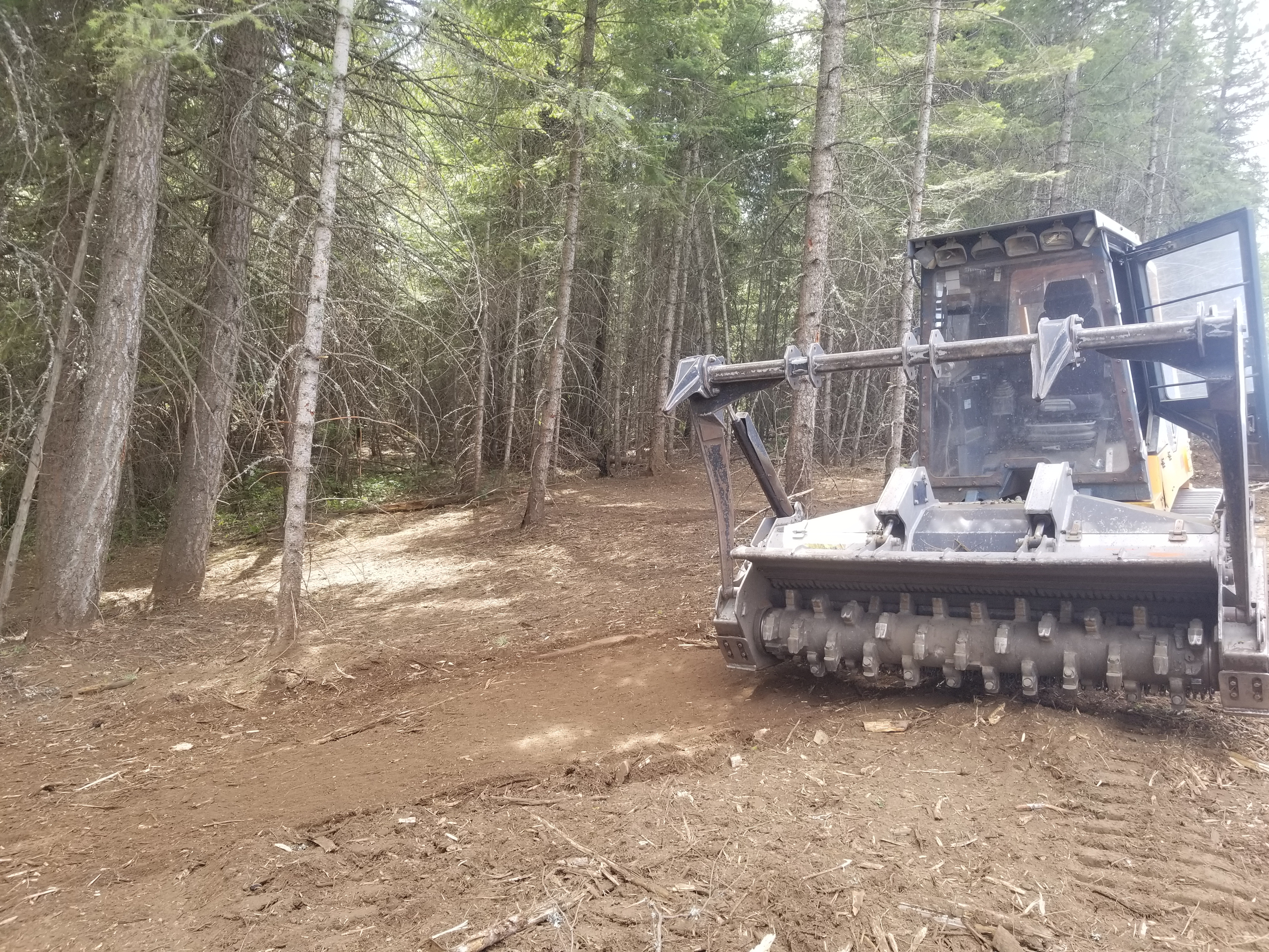

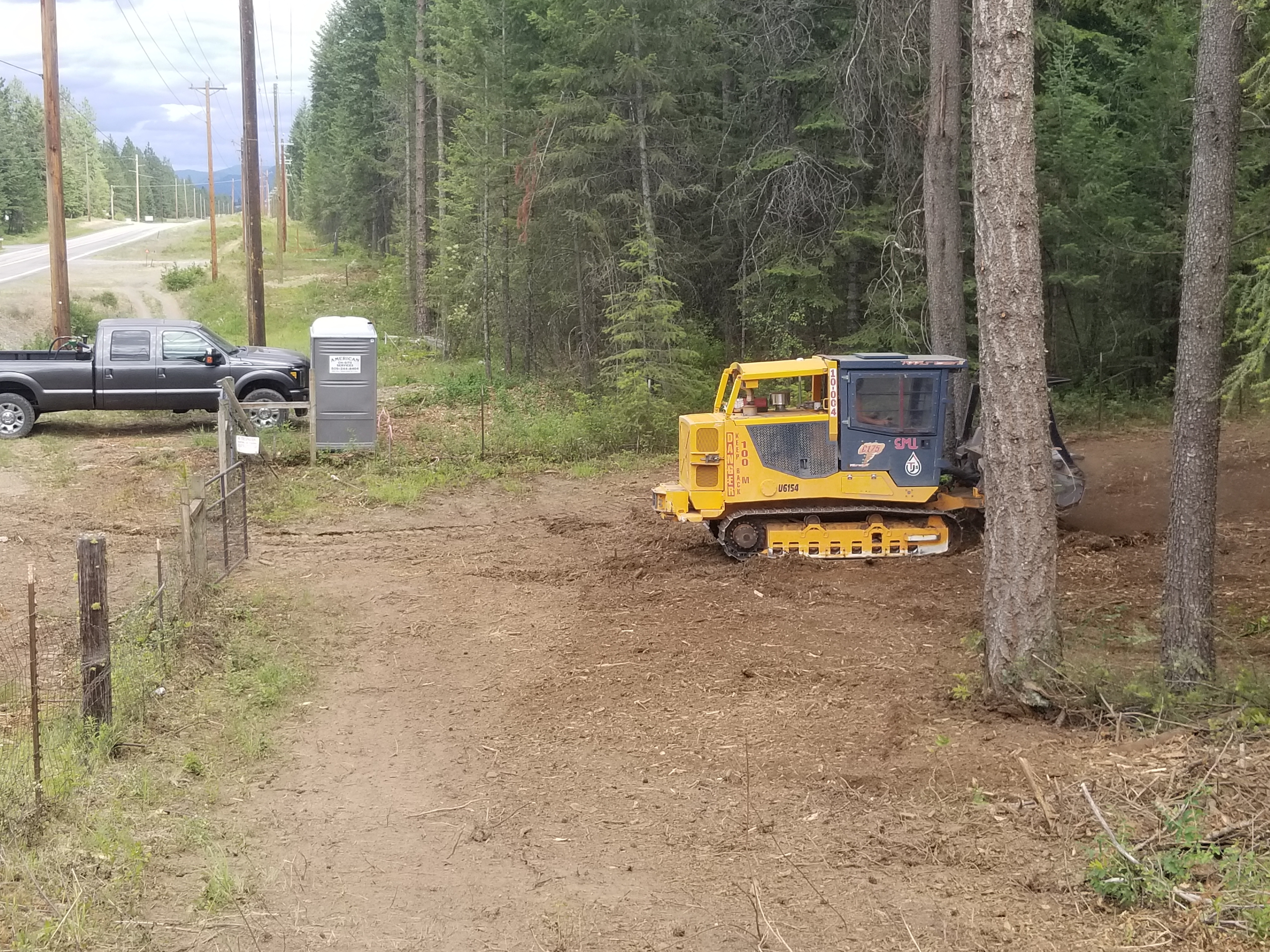

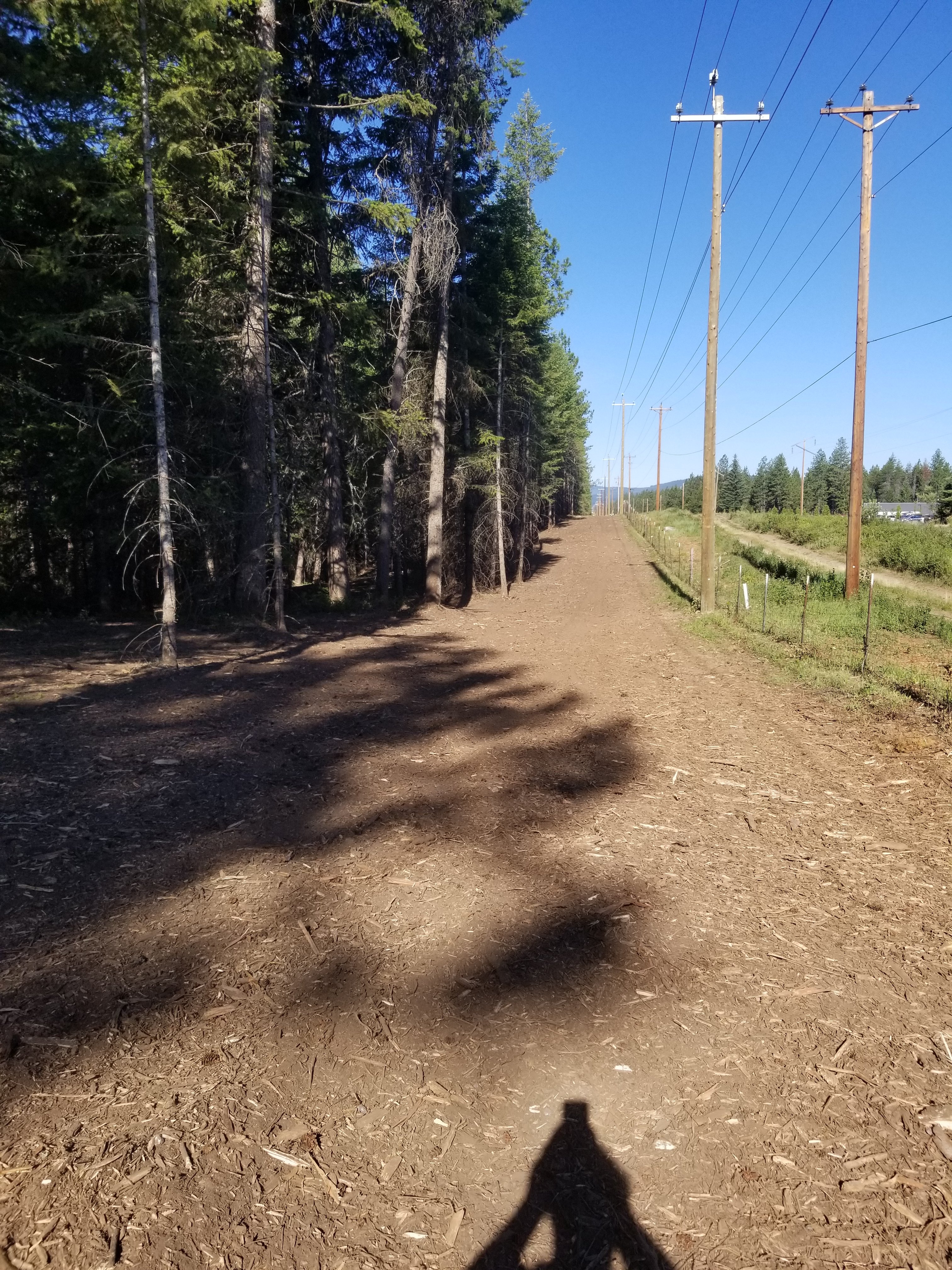

On my latest project i kept the chipper in the shed, hired a guy with an industrial root grinder and another guy with a 100 hp forestry mulcher.

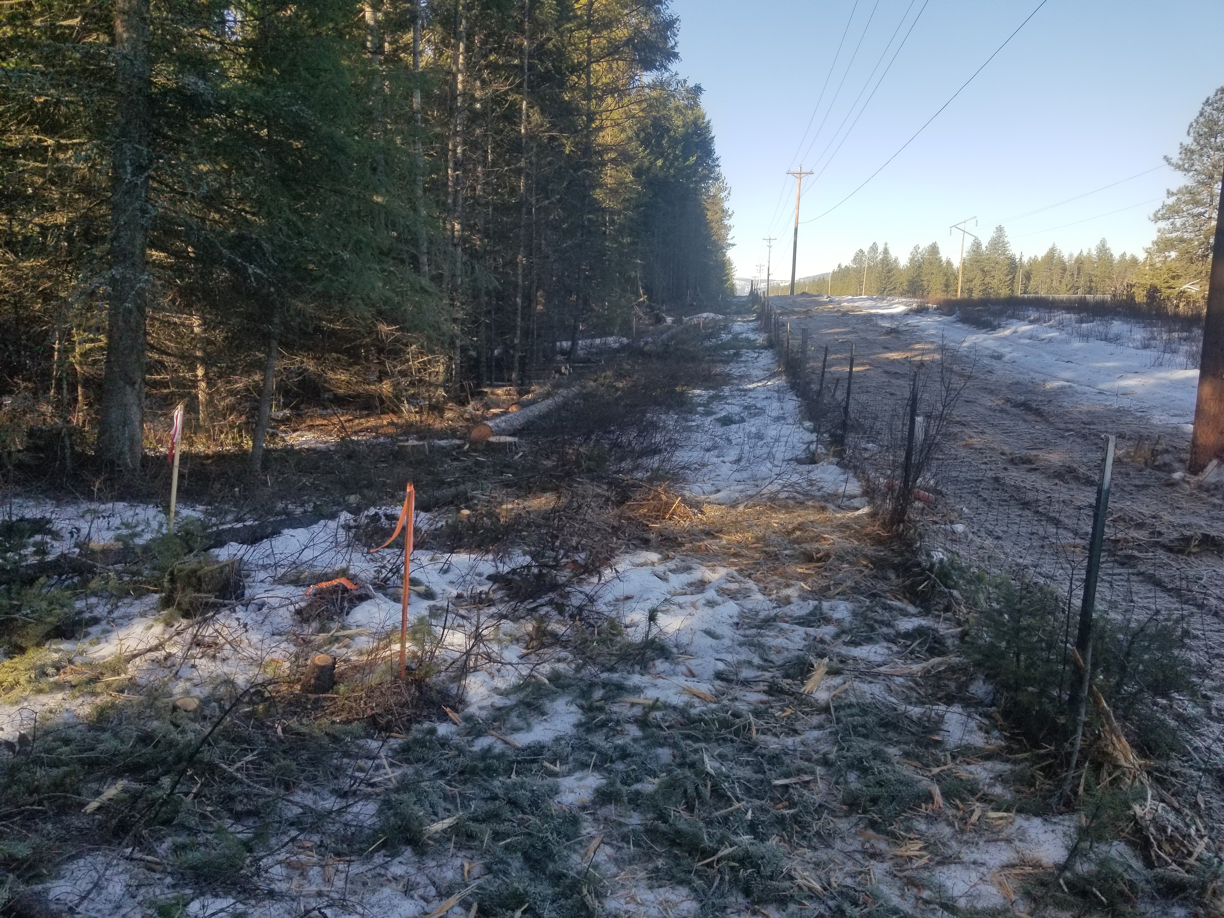

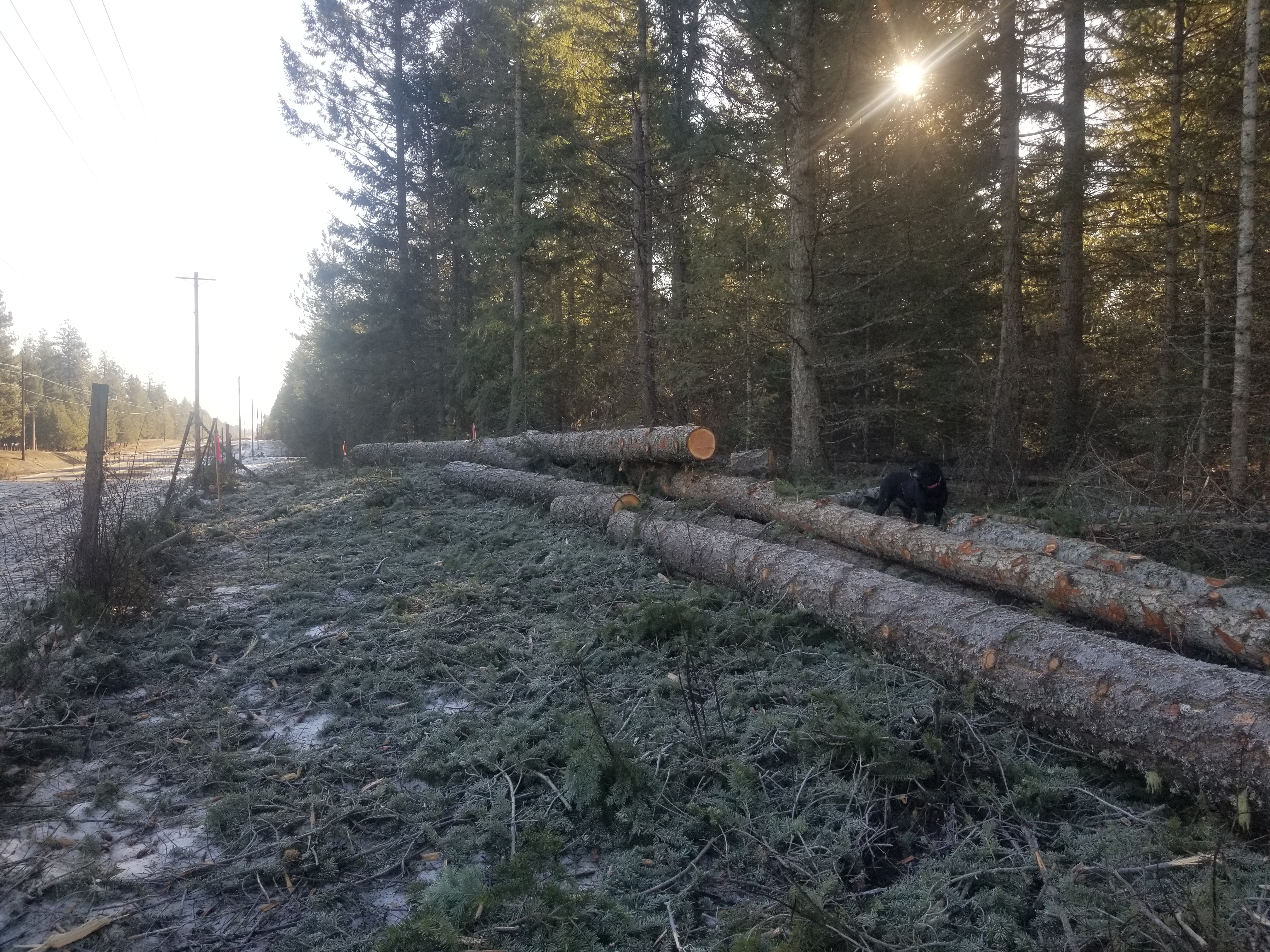

The local utility company cut a swath 15’ wide x 1,280’ long along my north boarder to move power lines. They left a mess of wood and branches. Trees up to 28” and lots, i mean lots of roots. I would have spent months if not multiple seasons cleaning that mess.
It took me about 3 weeks to haul out all the wood with the grapple. The root grinder guy took about 6 hours.
The forestry mulcher guy took about 8 hours over 2 days.
I didnt have to dig out any roots and than have to haul them away. Cost a bit of scratch, but we love the results. I think this job would have taken me many, many seasons to do with a grapple, dump trailer and chipper.

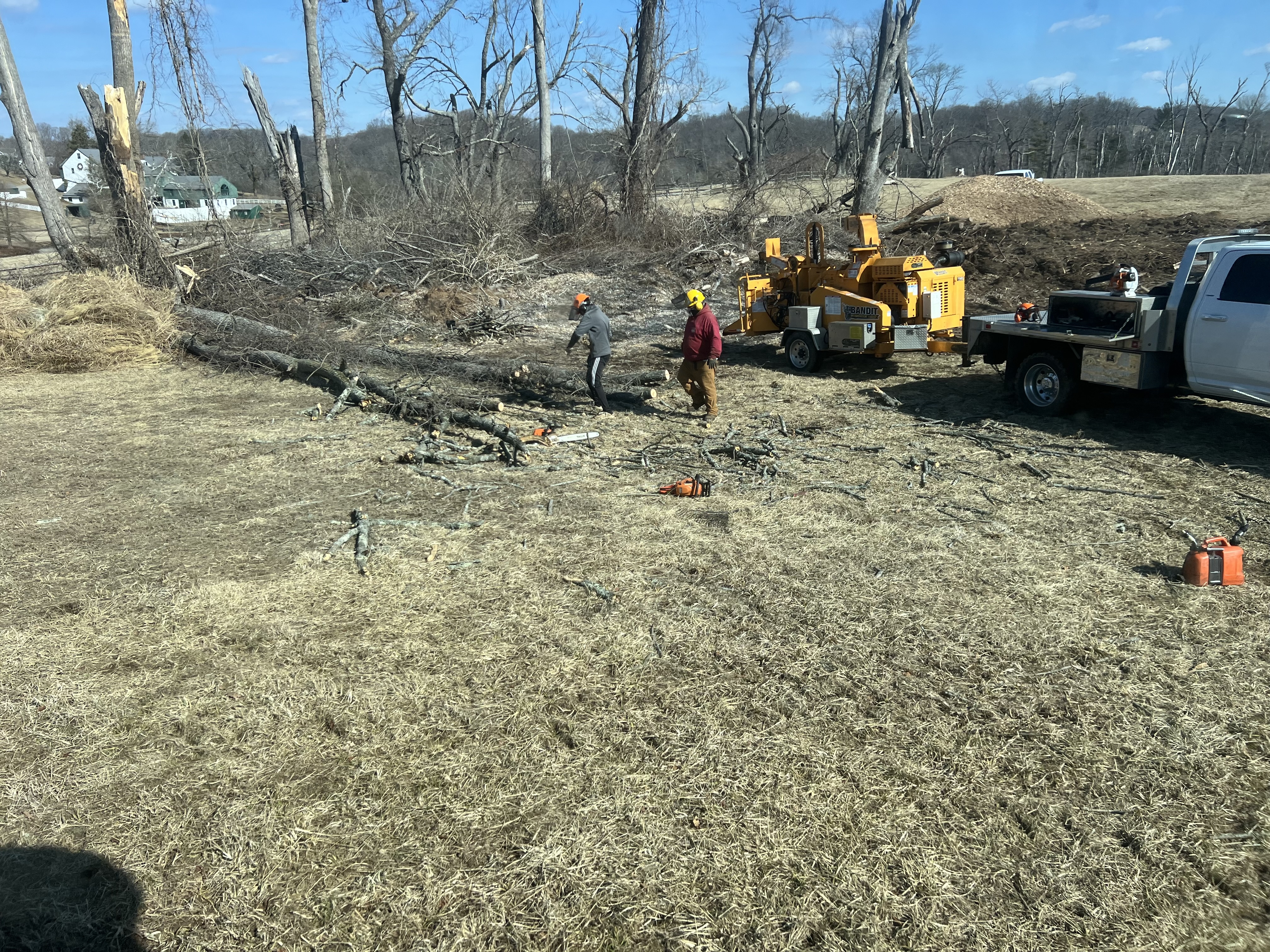

I have been tempted, but never acted on a 3pt chipper. The shock load it puts on your PTO can be a cause for early PTO failure.
Sticks and limbs would be fine, but logs and no feed mechanism, like a truck pulled chipper has, would be a workout for both you and the chipper.
I’d rent a big 100HP diesel chipper after you accumulate a lot of log material, then chip away. Use your tractor instead to haul the logs to the rear of the chipper.
