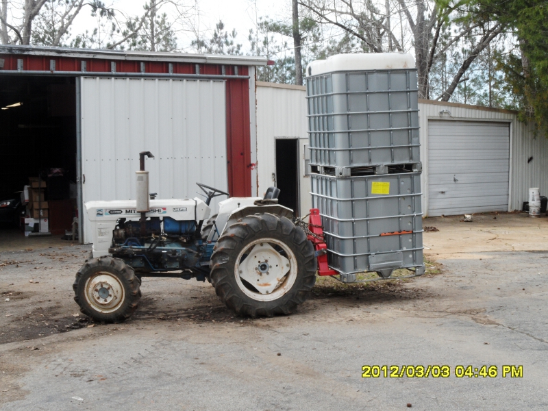

I drain it in the fall and lug water with buckets all winter.
If you get by all winter with buckets why not just get a bigger bucket?
2 IBC totes could give you 600 gallons.

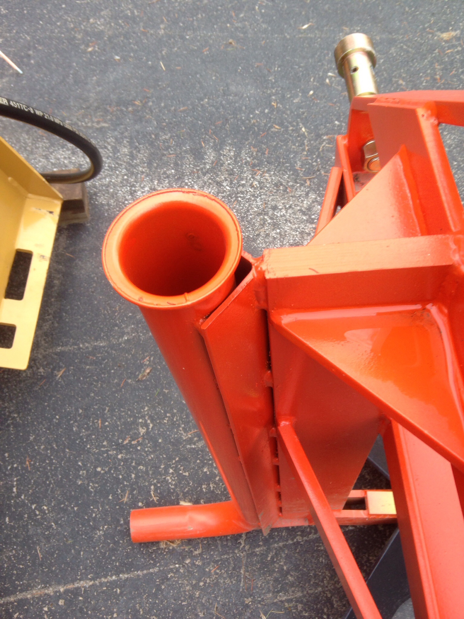

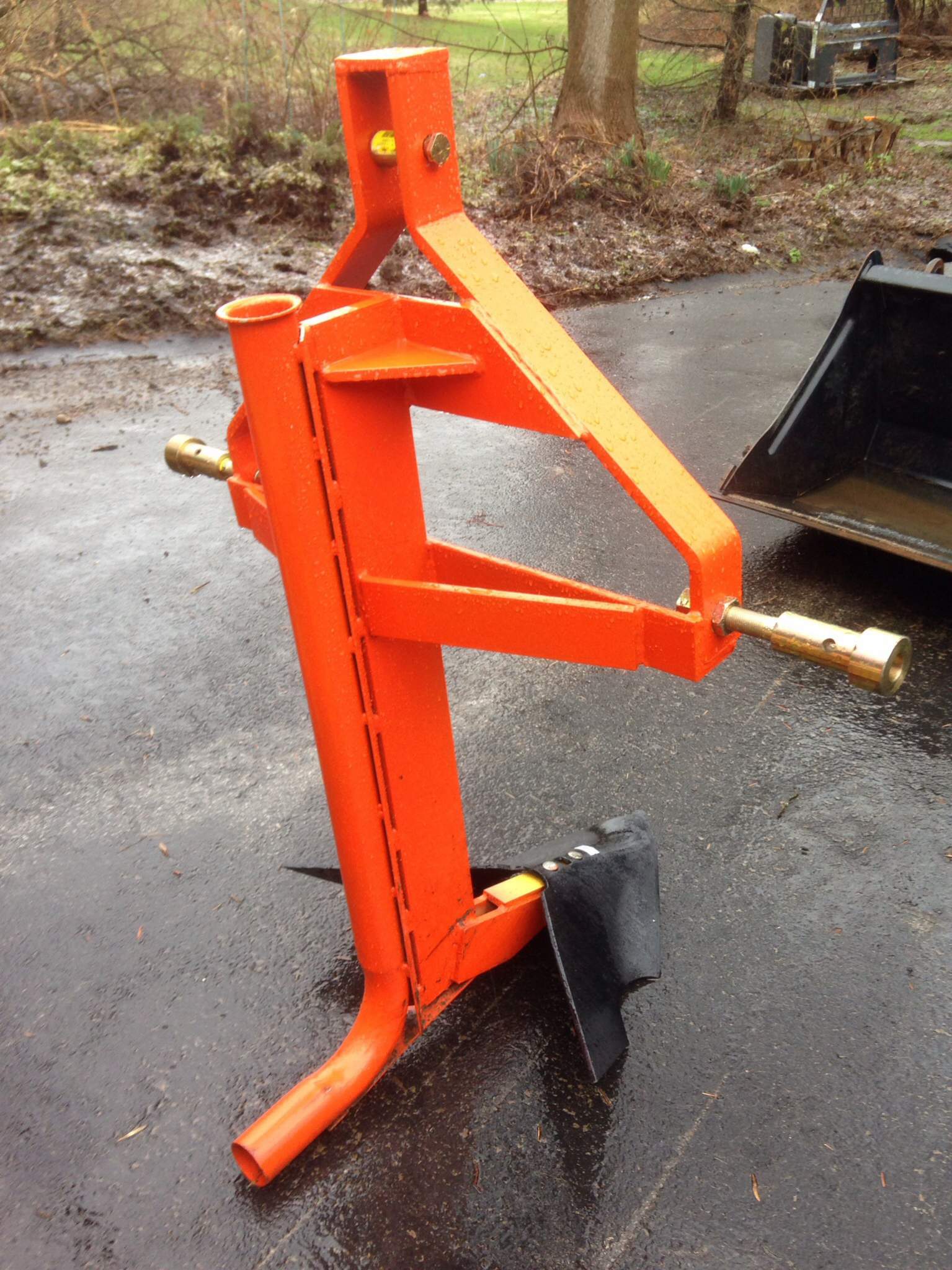

So, what I'm looking for is links to examples of a mini tile plow, or sketches/ideas on how one should be made.
I made one from a TSC subsoiler. Here is a picture of it with a piece of exhaust pipe welded into a angle iron. That is a ditching point on there now, for trenching I used the standard point.

Deerherd, that's what I was thinking of doing.
Two questions: How much tractor do you use to pull it, and how well is that exhaust pipe cable guide holding up?
I have an 88 hp tractor that pulls it fine and there is a piece of angle iron welded on to protect the exhaust tube from damage. Your main concern is that whatever you are pulling can make the bend at the bottom without binding. Make sure you have the end flared so that the cable feeds smooth.
To use that larger tube I purchased I would need a much larger sub soiler.
Here's a picture with more detail showing how the angle iron protects the tube and spreads the trench.
