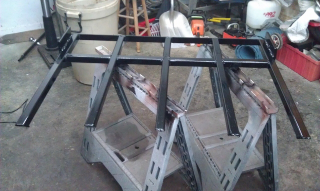

Started working on this tonight.I just have it tack welded in place and will finish welding tomorrow.I used 3/16 ,inch and a half square tubing.I'm going to use it to load brush and logs on my trailer.

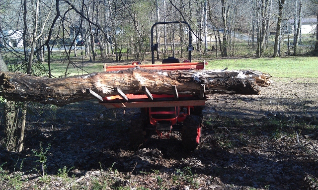

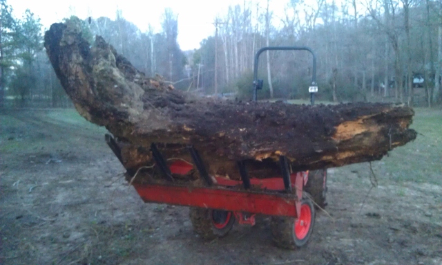

Finished welding today and got it painted.Even took it out for a trial.Works great.Here is some more pics.

:thumbsup: Looks Good to me, and you can say it's American made too:thumbsup:

Looks good!
Now put at least a couple of uprights on the back of the bucket to keep the logs out of your lap if you tip the bucket a bit far back when it is up.

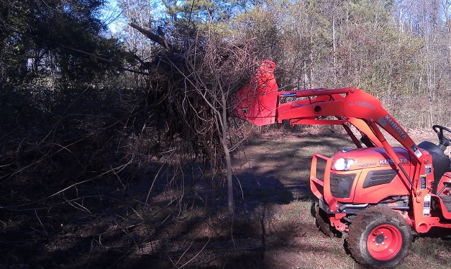

Mine are only about 46 inches wide and stick out in front of the bucket 20 inches.They are mounted with 2 bolts that were used to hold the tooth bar on.I only have $65 dollars invested and my time.
They got there first real test today when i was moving a brush pile that i had piled up a few years ago .Here is one of the stumps that I dug out of the pile.

Thanks for the idea.I'm trying to be carefull when lifting and roll my bucket forward as I lift.I drive a case loader at work and it rolls the bucket forward automatically as you lift.I wish the Kubota had that feature.
