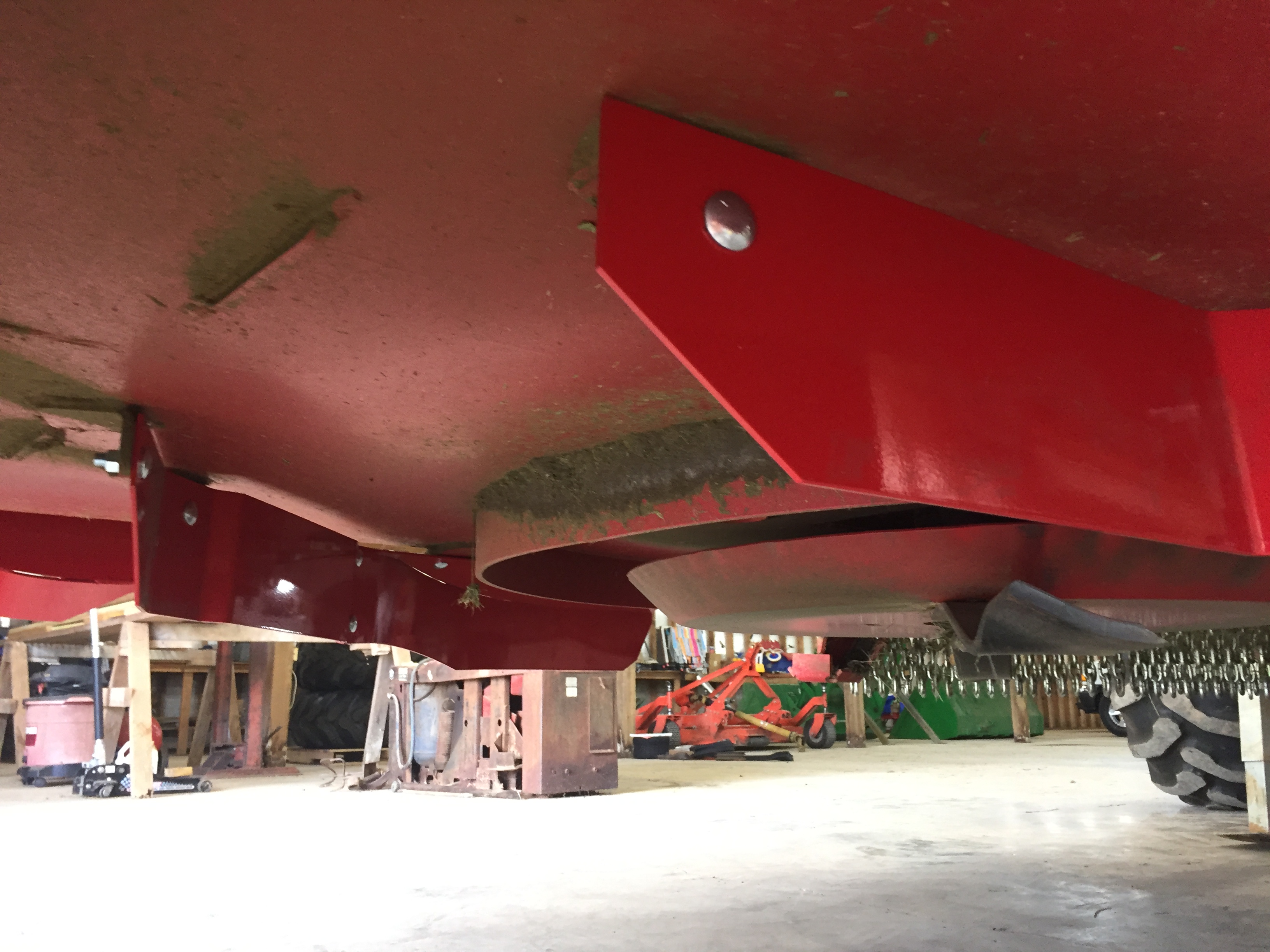

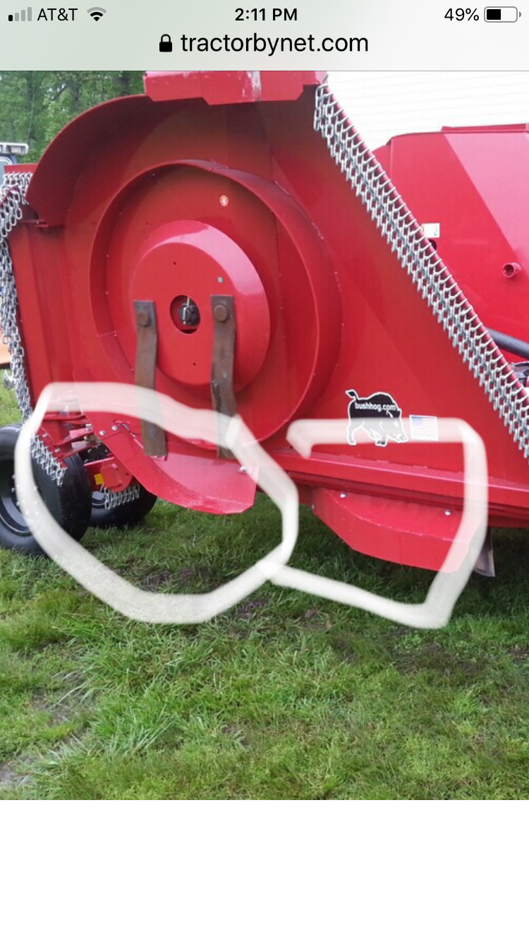

I was wondering if anybody has experience with the grass & cornstalk baffle Kit # 50069451 ?
It’s supposed to help windrowing in heavy grass
Borrowed pic :

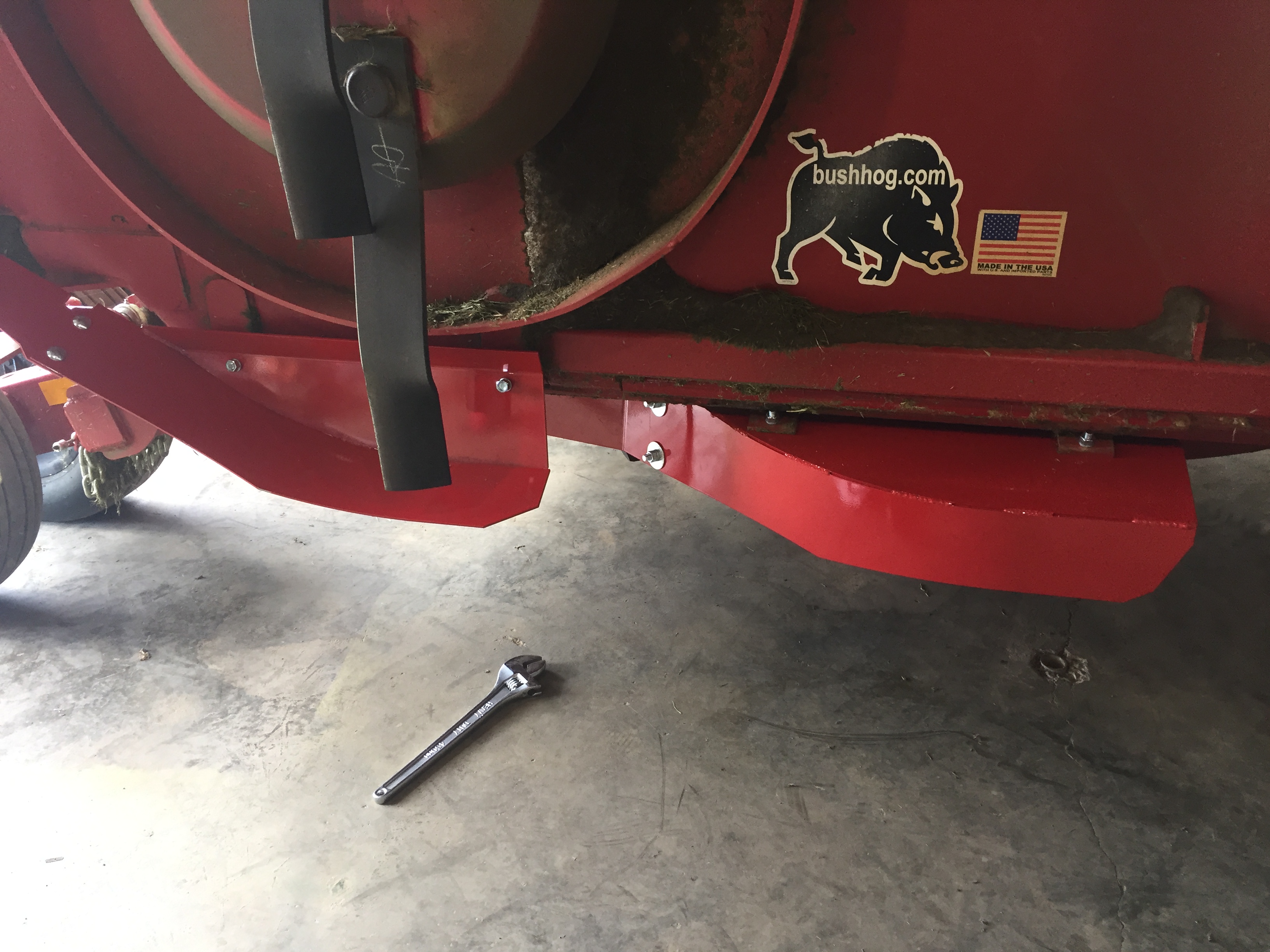

I bought a new BH 2815 & Love it.
I purchased a baffle kit & picked it up at the BH Factory in Selma AL as I’d always wanted to go there.
The Batwing cuts fantastic.
It cuts much finer clippings with the baffle kit bolted on.

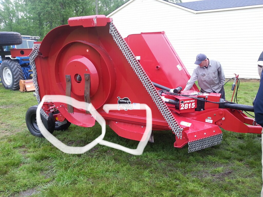

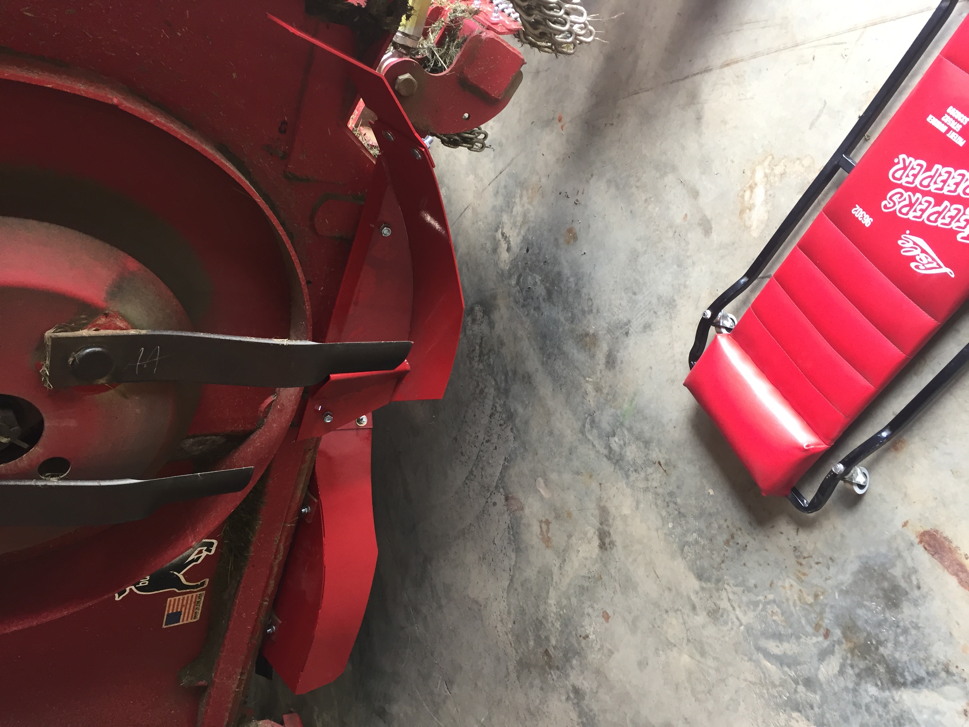

I appreciate the finer cutting with the baffles. How ever, I have tore up 2 sets of them when mowing with a wing in tipped down position such as hanging over a creek bank no matter how slight the angle. Talked to a Rep at the area farm show about the them. Told that the engineers hated them and said not to use them in my application. Salesman loved them when demonstrating on flat ground because of the fine cut and great looking finished job.
   / Bush Hog 2815 Batwing Baffle / Shields
Yes I could see them making contact very easily with the blades.
Especially backing up onto objects as the baffles wrap around beside & partially to the back of the blades.
That is why Dealers don’t order cutters installed with them : to save themselves the headaches lol
They are ONLY good in a stump free application where their is absolutely NO Blade to Ground contact & that’s very rare for most pastures & fields.
They are mostly installed to shred row cropping Stalks in smooth flat fields.

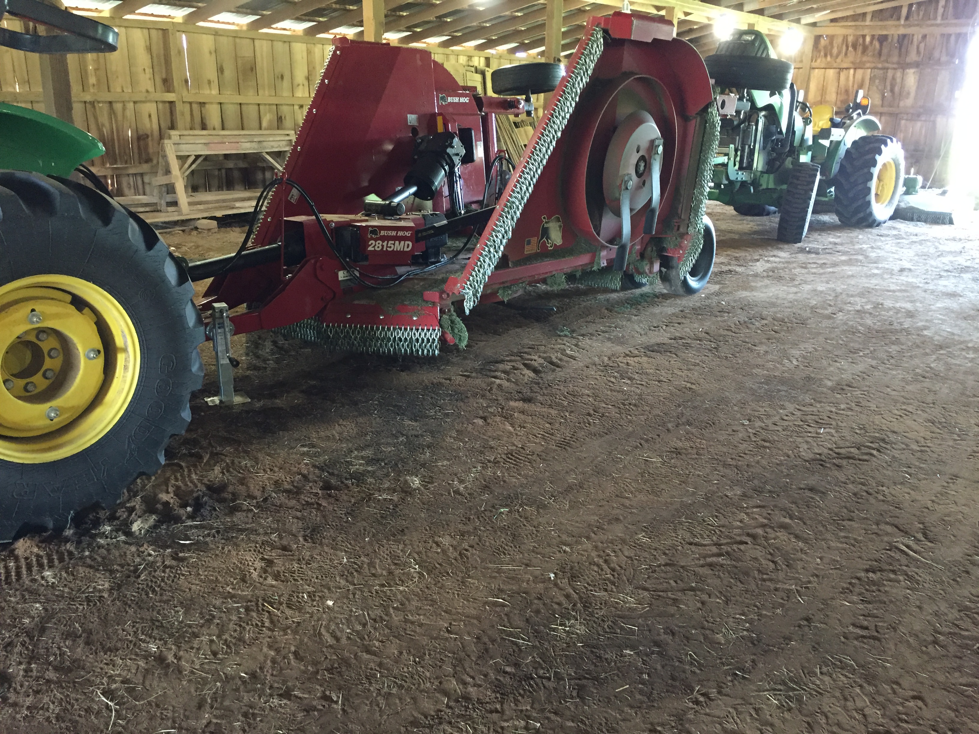

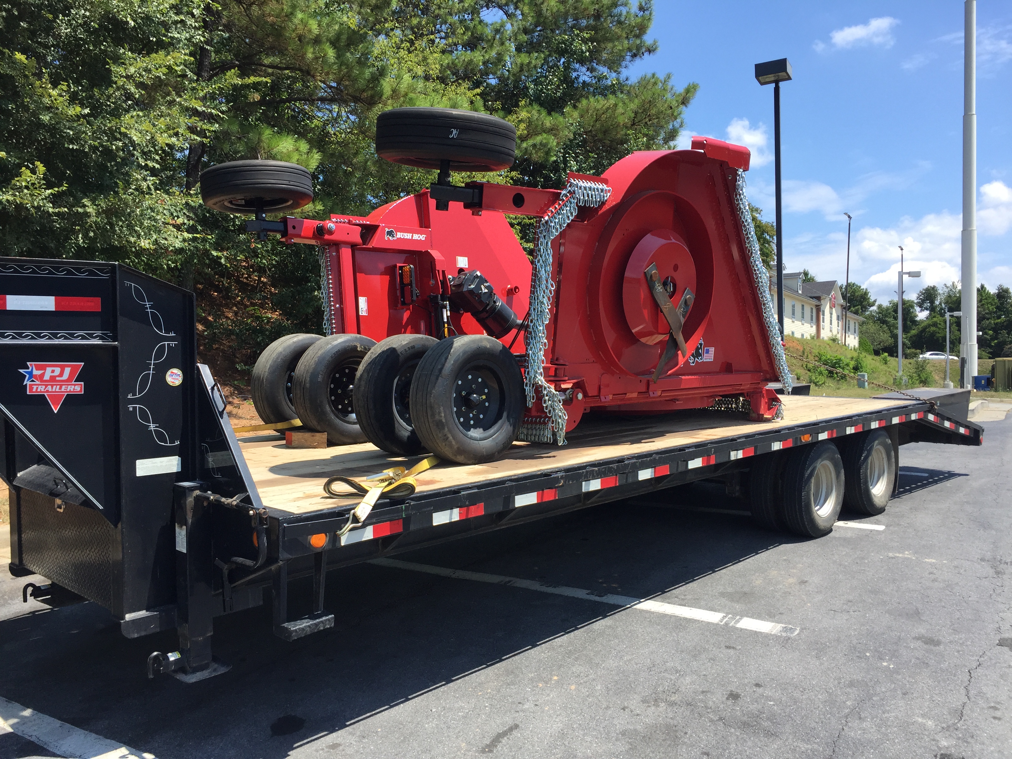

This was the maiden voyage on the way home :
After Christened & before the Baffle Kit Installed :

I appreciate the finer cutting with the baffles. How ever, I have tore up 2 sets of them when mowing with a wing in tipped down position such as hanging over a creek bank no matter how slight the angle. Talked to a Rep at the area farm show ...said not to use them in my application ...
Did you wind up removing them ?
