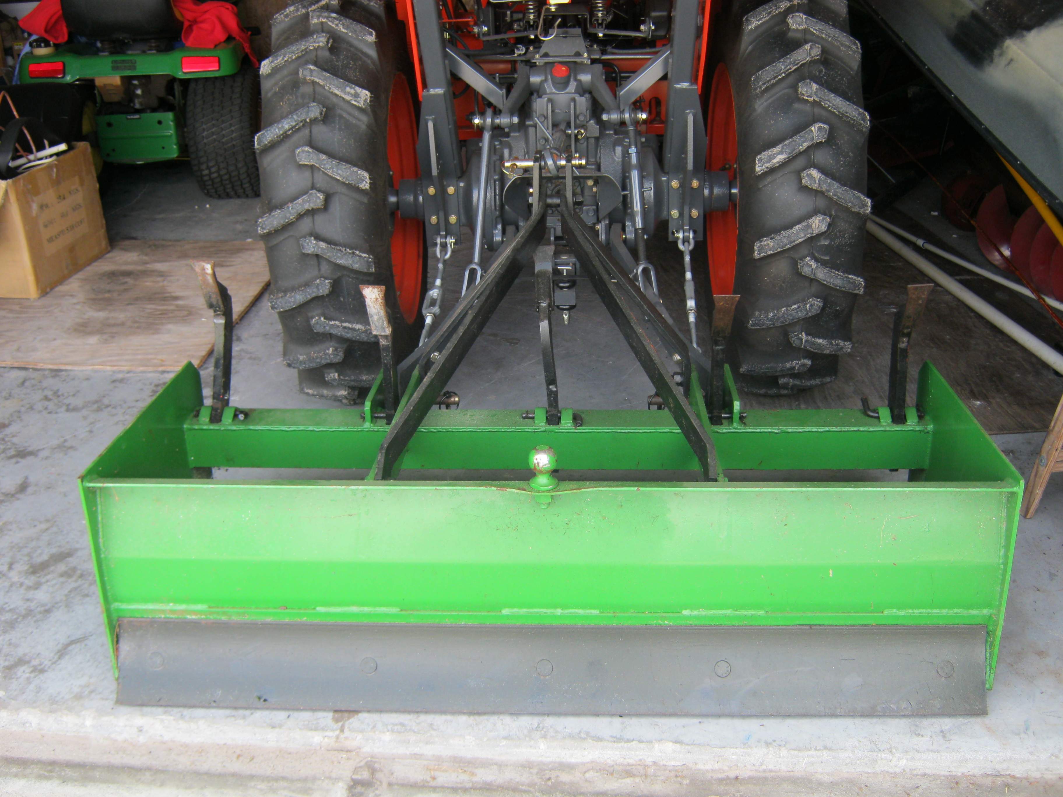

   / Bush Hog and box blade size for L3400 #3
For me the best box blade would be 66", if the tires are 5' wide. A few extra inches beyond the tire is nice.
For the rotary mower, go 6'. It can handle it. You always loose some width due to overlapping passes. Can get close to fences, obstacles ect without having the tractor immediately next to the object. If the mowing is really difficult, then just take a narrower width with each pass. Turns the 6' mower into a 5' mower! Can't make the 5' mower into a 6' mower.:thumbsup:

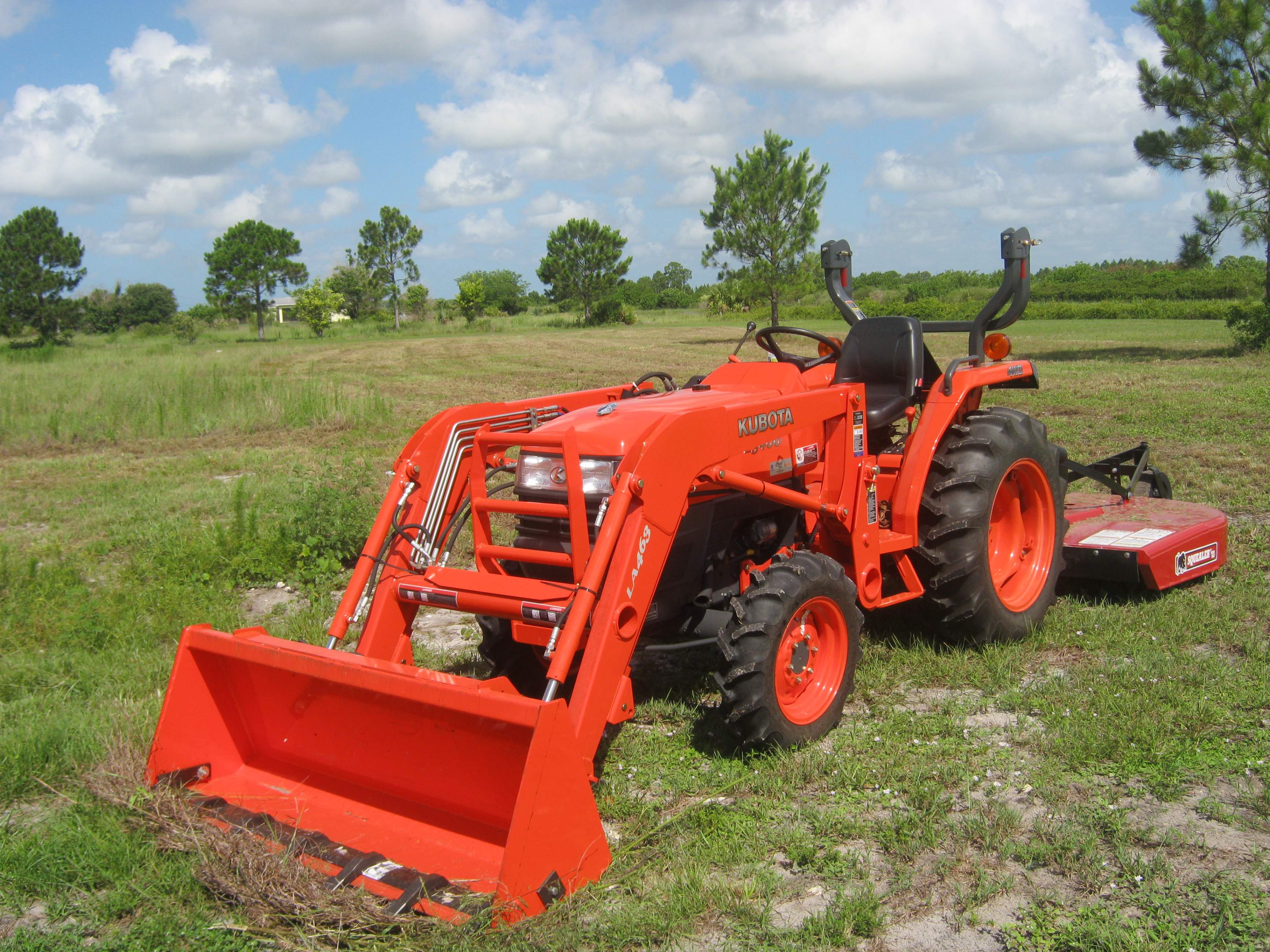

   / Bush Hog and box blade size for L3400 #6
I run a 5' BB and a 6' B-Hog(sq172) on my L3400(DT).
Works great for me.

   / Bush Hog and box blade size for L3400 #9
mine pulls a 6 foot bb easily even uphill with a full box. I think you really benefit from the width being outside of the rear tire footprint.
   / Bush Hog and box blade size for L3400 #10
I run a 6' box blade, 5' bush hog, and a 6' finish mower. Works great for my needs.
