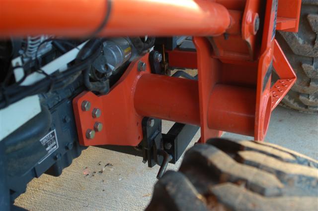

loader bracket 3
   / Bush Hog Back Hoe Sub Rail Mount 3 Point Pictures #12
Thx for posting the Bush Hog subframe pix. It looks like you
have to completely remove the 3-pt arms to install the backhoe. Inconvenient, to say the least. I have seen this
with Woods factory subframes for Kubotas, too. When I
build the subframes myself, I try to avoid any use of or interference with the 3-pt mounting areas.
As for being able to use the Bush Hog subframe with other hoes, unfortunately there are a variety of different hoe-side
mounting areas.
#13
Unfortunately you do have to remove the 3 point arms. Back on is a 15 minute task. The back hoe can be set off the tractor in under 20 minutes if you have the right level pad. Back on is about 30 minutes as a one man job. All in all, I'm pleased with the whole setup. Pasture grass cutting season begins soon, the back hoe may be parked for a bit.
