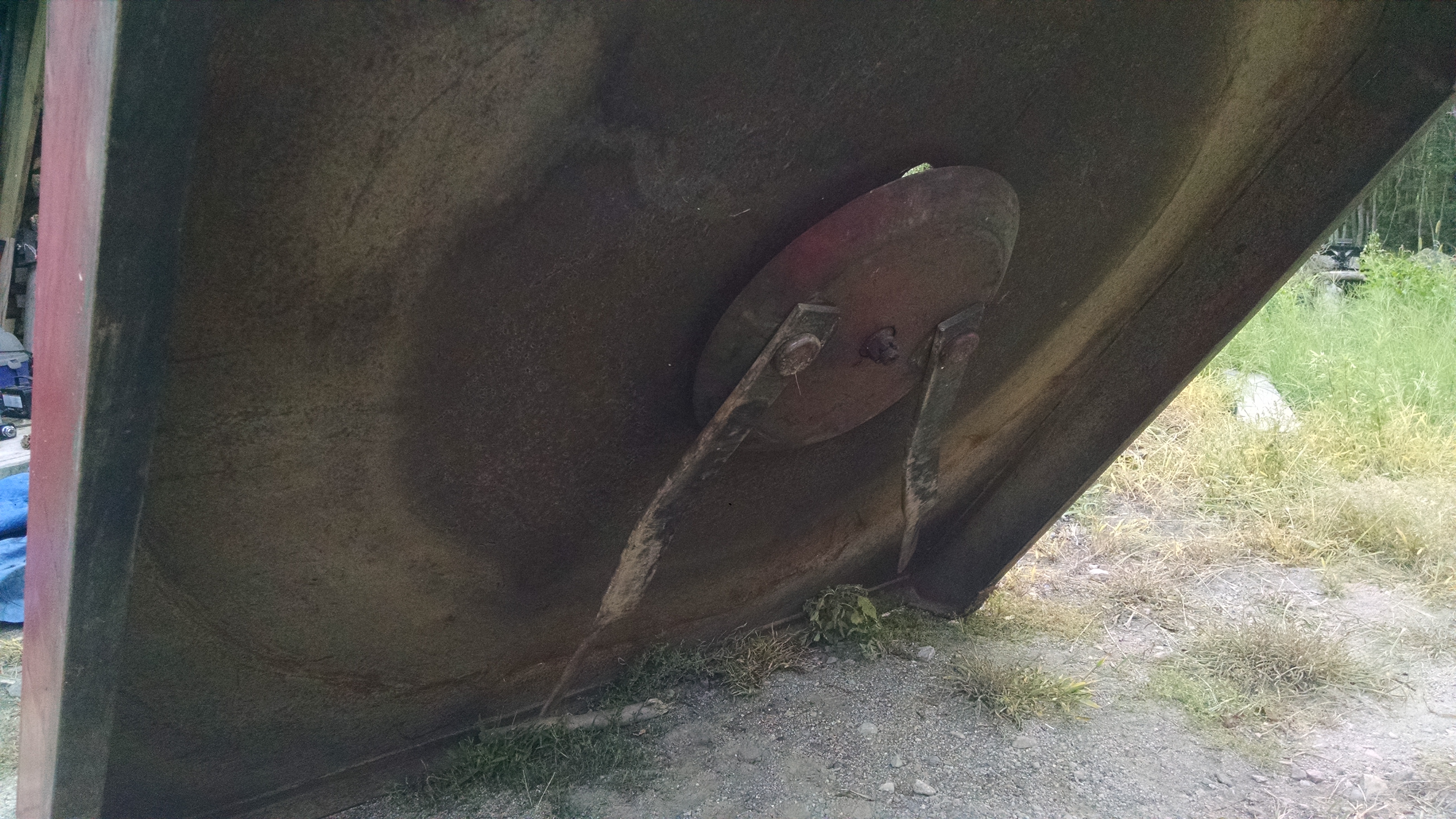

Perhaps you could share some pictures of this mower, the blades, and a good shot of the underside showing the deck, blades and stump jumper / blade carrier?
Yes I think pictures would be helpful. The 3" is an estimate from memory - I'll pull out the camera and tape measure when I have a chance.

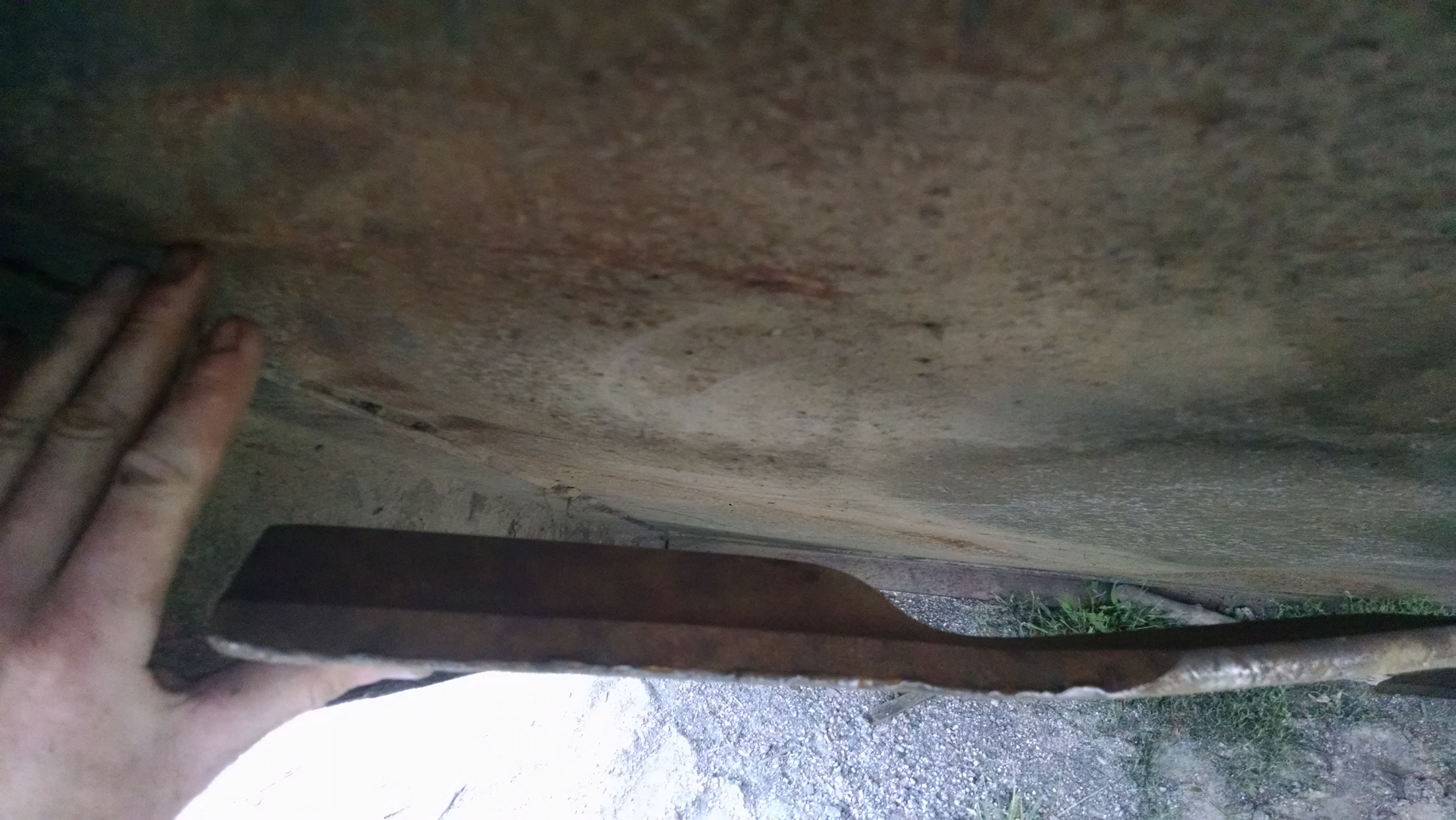

Here are a couple pictures of the underside of the deck. The blades are actually only 2.5" from touching. I was checking out the brand new Landpride mowers at a local dealership the other day, comparing the design to mine. I asked for some pricing on them - seems to be around 2500 plus tax for an equivalent (but better built) mower. The blades on the new one seemed to have about the same amount of slop as mine, which indicates that nothing is worn out on my mower. There was, however, a tremendous difference in the clearance of the blades - for a couple reasons. One, it had much higher sides to begin with, and the stump jumper is installed a little lower. The other is that they install the subframe underneath the deck, instead of above it. The sales guy told me that many manufacturers are moving that way, because if a blade hits a rounded rock, it gets pushed right up into the deck if it's too close. If the subframe is underneath, the thicker steel works to protect the deck. He told me this without me talking about any of my issues - but it sounds like exactly what's going on with my mower.
I also got some pricing on steel to reinforce mine - it would be around 220 for 1/4" mild steel, and around 450 for 1/4" hardox 450 for a 4x8 sheet sheared into 16" strips. I'm not sure yet which material I'd prefer, but I'm inclined to just reinforce the deck of mine anywhere the blades touch, and buy a better cutter in a few years.
   / Bush Hog blades hitting deck #19
I believe the single biggest reason for the push to go with the supports on the underside is ease of cleaning off the top of the deck.
As to your situation....yea thats too close with them high-lifts. You might be able to source some generic blades that are the correct length and have a little more offset?
   / Bush Hog blades hitting deck #20
For a lot less money, I would take those blades to a machine shop and have them bend them to give more offset in the blades. Cold bending should not affect the tempering although I doubt that hot bending in the existing bends would hurt the tempering either. It would take 2 bends per blade to do it right and keep the cutting edge level.
Of course this option would only be used if you cant find replacement blades with enough offset in them.
