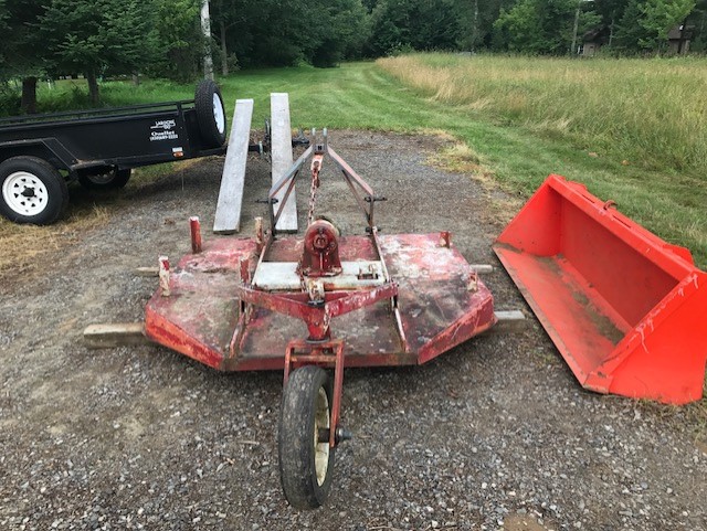

Hey folks,
I inherited what I believe to be a Bush Hog RZ60 from the previous property owner. I am performing an annual tune up before hitting the fields. Everything looks OK except the blades. They are in good shape but I can flex the end of the blades up and down a good 1.5 inches.
Is this normal? Seems to me they are loose on the mounting bolt. The nuts are both tight so I am not sure if this is normal.
Ran the unit last year for 15 hours with no issues.
Any advice from you experts would be greatly appreciated.
Thanks Papper

I don't have your model but I'm pretty sure that is not right... they should not "flex" up and down. Can you see where the slack is coming from (bolt holding it on or the stump jumper plate loose?) surely, the metal blade itself is not flexing.

I am certainly not an expert on Rotary Mowers or anything for that matter but the blades are going to be able to move the axis of the bolt freely. As far as up and down movement naturally you want the minimum but your 1.5 inches don't seem out of the ordinary to me. As the blades age along with the bolt that holds them on you'll get some wear in there and it will cause the blades to droop a bit.
Just make sure your bolts are tight and you don't have excessive wear where the blades are drooping way down and you should be fine. There are some experts that might chime in to give you a better answer than me. I have 2 rotary mowers with some age on both and they have at least that much up and down play.

It could be that the blade bolt is worn and or the hole in the blade that the blade bolt goes through, allowing the blade to move with more slop than it should have.
Take the blades off and sharpen them. Check the blade bolts and the holes in the blades for wear and out-of-round. Your owner's manual will tell you how much wear is allowable in those areas and how much is too much (requiring replacement).

The make and model are also a mystery. I am attaching a few picks to see if one of you folks can identify it. I thought it is a Bush Hog Razorback model RZ60 but Bush Hog says no. They thought it to be an Andy Brand but I do not find a match.. Bush Hog Back 2.jpgBush Hog back.JPGBush Hog left side.jpgBush Hog right.jpg
The slack is coming from the bolt/blade junction point and the nuts are secure. The Jumper looks solid. I will take a few pics of that as well

1.5" at the tip of a a blade on a 5' mower....that's just fine. Sounds about like a new blade/bolt combo it you ask me.
Nothing at all to worry about. The blades aren't supposed to be "tight" like a lawnmower

No idea on model. But it really don't matter who made it.
/ Bush Hog Blades #13
You may find it best to load on trailer and have a shop replace the blades. Large impact wrench helps. As have been said in some words the brand is not so important for gear box and blades be used in more than few brands. I would think a decent shop unless real issue could change those blades within an hour.

They appear to be original. Four on one side and 2 on the other. Here is another shot. I can take more pics if you would like. There is 20% of a decal left on the deck and it appears to be a WBush Hog back.JPG

You should be able to take the blade measurements and find a similar blade to install. Basically all you need is the amount of drop in the blade and the length of the blade from the center of the hole and the size of the hole. New bolts is a good idea but I usually just install them 180 degrees from original so that there is a new surface to wear on. That is if the bolts aren't totally worn out to begin with. If that's the case then install new bolts.
