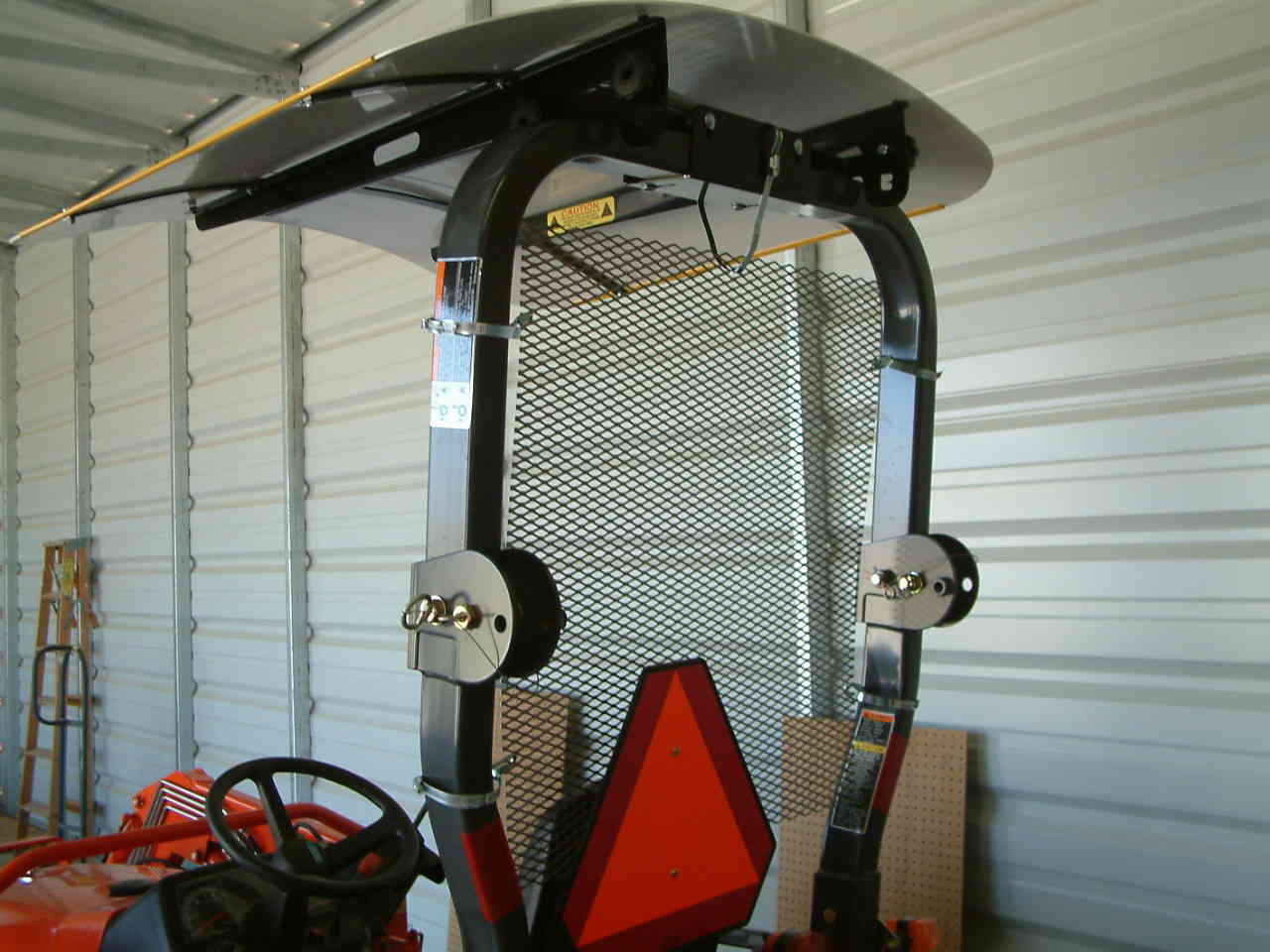

I have a 5 ft. brush hog which may be somewhat smaller than some others. However for me it is plenty to handle. I am going to make the mudflap addition as well as put some expanded metal on the ROPS to help illiminate as much flying debris as possible. I will add pictures later.

Here's one way to add an expanded metal debris shield to a ROPS, in this case on my B7510HST. It's held on with hose clamps (no welding or drilling on the ROPS).

not to steal the forum but every time we spread manure i ALWAYS get hit with tiny chunks but that looks like a really good idea to solve it /forums/images/graemlins/laugh.gif
