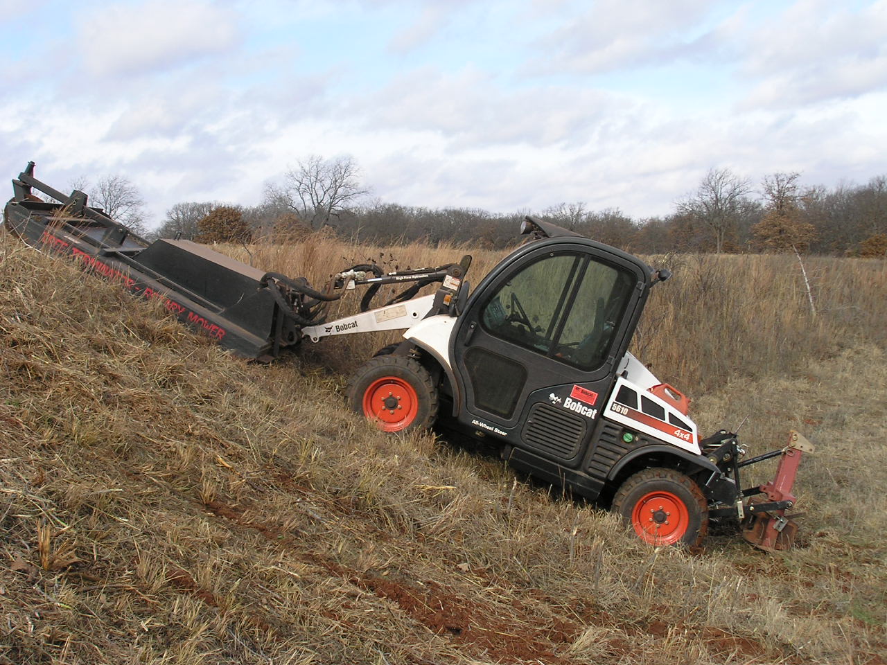

Show-off! :thumbsup:
Yep, thanks. ;)
On the spillway, she won't mow this either. :D
attachment.php
