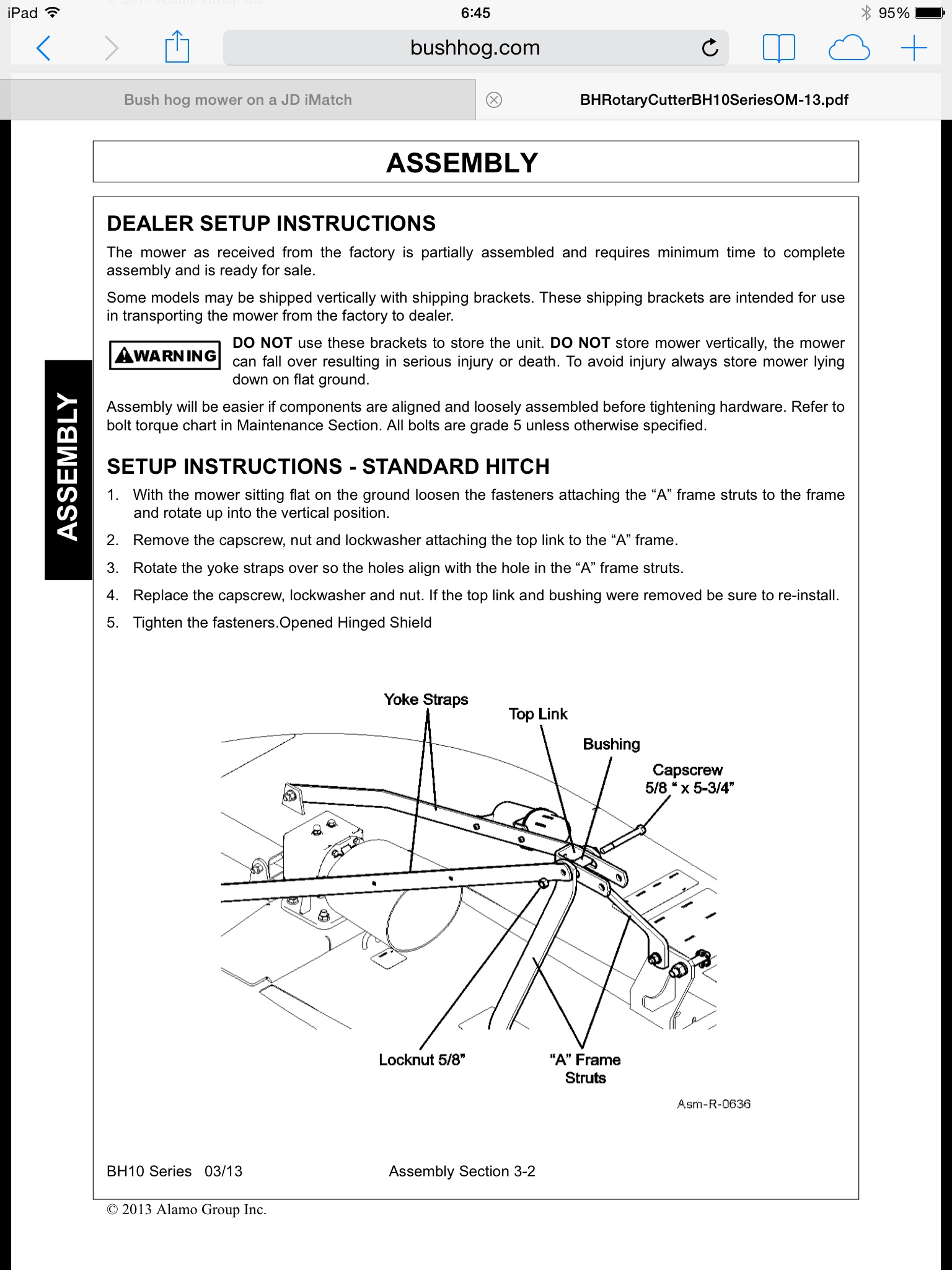

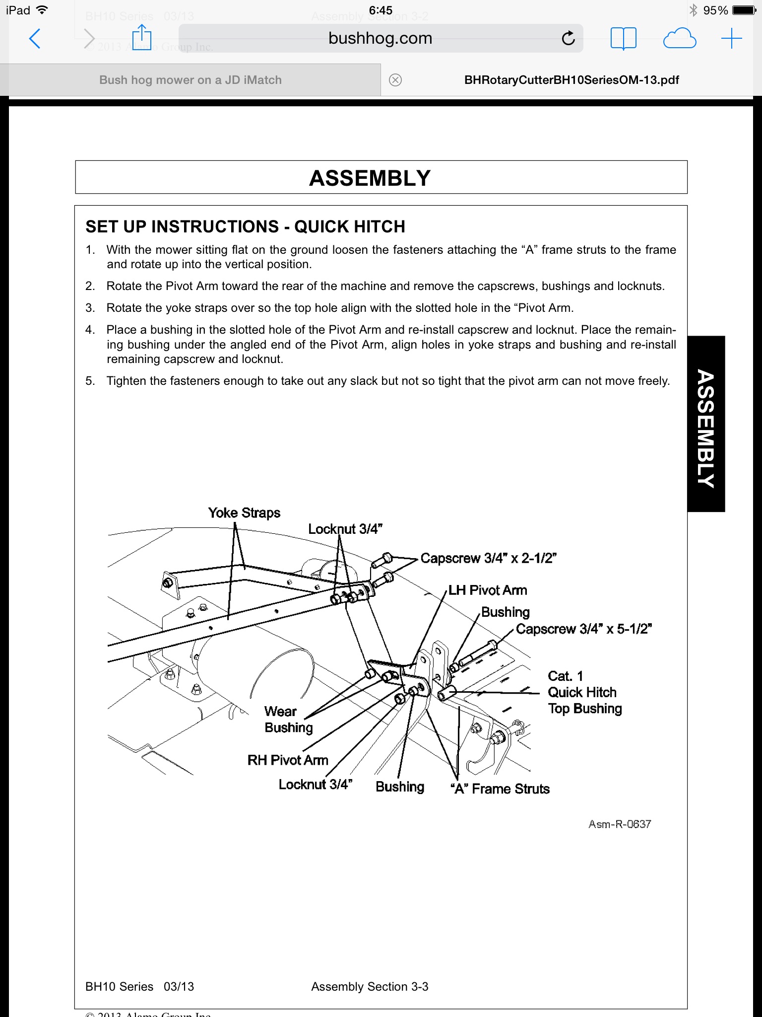

You do not want a floating top link, you just need to set up the Bush hog for a quick hitch. Here are the different set up diagrams for each type:

View attachment 390335View attachment 390336
Bingo...I think!!.. I have contacted Bushhog and already have them on this. FYI People bash manufacturers all the time and when one hits one to of the park we should say so...I left a Facebook question to Bushhod last night at like 730pm (Saturday) By 800pm I had a response...and i think thats eastern time where they are....amazing customer service Thank you mr Deerherd

You get your "float" from the QH pins being in the same plane. All the adapters do is convert non standard implements to the correct standard and you will just bend the yokes on your cutter using the adapter in short order. When buying any cutter, realize set up is different for a QH and let your dealer know you have/intend to use it on a QH. Good luck!
