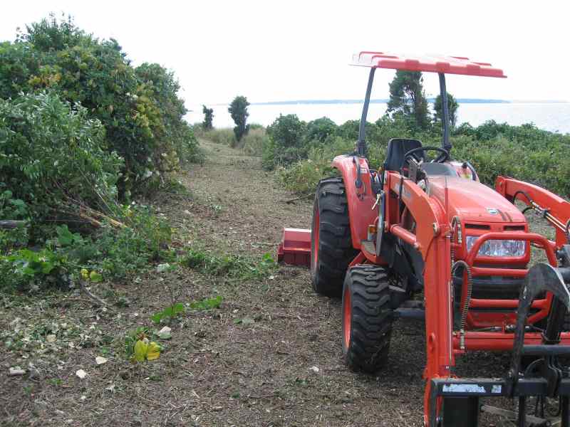

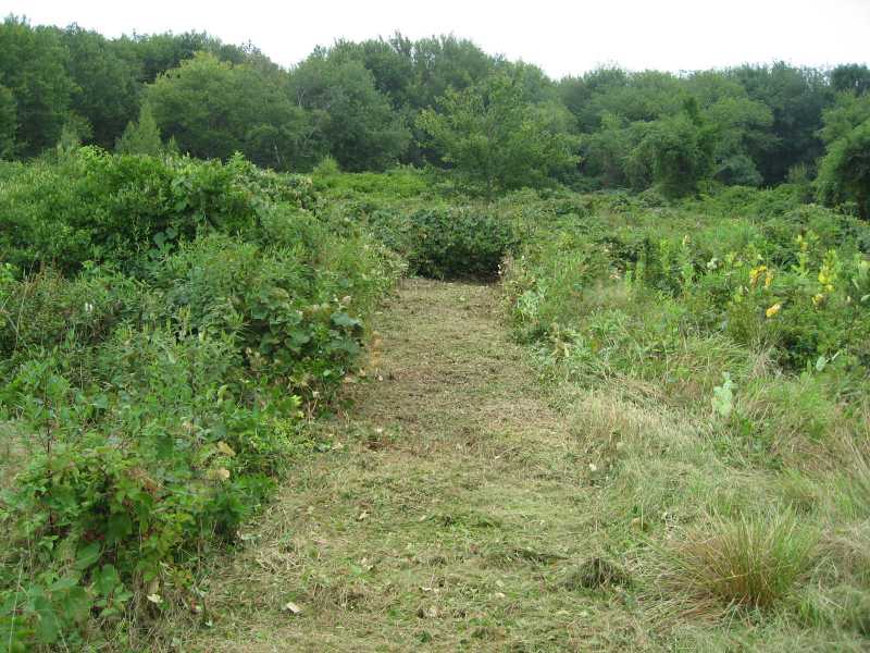

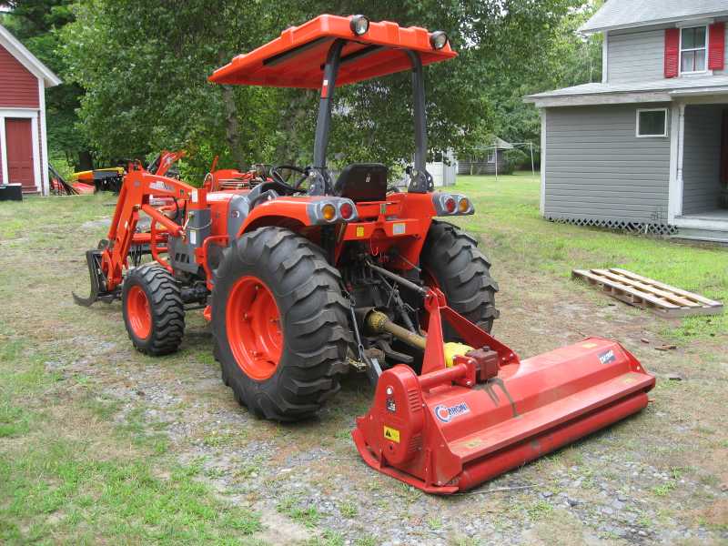

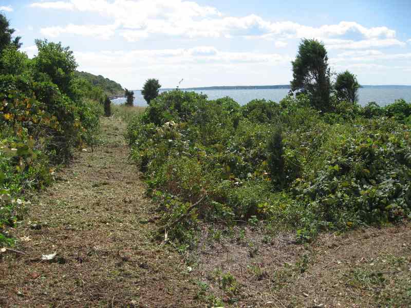

You haven't considered a medium duty flail mower? That would be perfect. Cut is much better than with a bush hog, much tougher than a finish mower and it is safer and easier to store as well. Most people forget about flails as the major US manufacturers build mostly heavy duty models designed for roadside maintenance and those are very expensive. For less than $2000 you can have an excellent Italian flail (Caroni TM1900) delivered to your door by AgriSupply in North Carolina. It will cut just about anything a medium duty bush hog will cut but the cut itself is only a little worse than what you'd get with a finish mower. Way less noise and way way safer than a bush hog too. Only real negative compared to a bush hog is that you actually need to grease the bearings every six hours of mowing (a three minute procedure) and replace the drive belts every few years (a half hour procedure). It is certainly much less maintenance than a finish mower used in the field. There is lots of reading on flails here on TBN: try the "Let's talk about flail mowers" thread. (not sure if that is the actual title but something like that....days of reading on all aspects of flail mowers).
