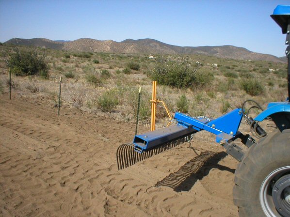

   / Bush Hog (Rake) - don't buy, IMHO #13
I have a Mid West rake, don't know if their even in business anymore. Anyway, bad design, I rebuilt so that I would not have anymore problems with the rake. Used a 4x7x3/8 tube, pretty much took care of my rake problems. ;)

   / Bush Hog (Rake) - don't buy, IMHO #14
That does look like a cheap-***** design. Mine's from TS, where I would expect to get the minimum but it at least has a c-channel there. Still, the weld should be stronger than the surrounding metal. I'd make them fix it, and warrantee the fix.
Very good looking structural re-build MVR, but why do we have to structurally redesign the product to overcome the inept attempts of the manufacturer? Glad it worked out for you. Nice paint!:cool:
   / Bush Hog (Rake) - don't buy, IMHO #16
Thanks, I had it powder coated. The re engineering that so many of us have to do may very well be because we use the implement as it was never intended to be used. I think that landscape rakes are supposed to be used to rake up loose materials such as leaves, sticks, small rocks etc. Many of us use them for grading.:eek: Now I'm sure that moving around a little bit of loose dirt is no big thing, but I know that I twisted mine up like a rope by grading my dry stream beds and at many times had more than a full rake of dirt. I doubt that the manufacturer ever intended for the implement to be use as harshly as I was using it. But what I was doing could only be accomplished with something that was flexible, otherwise I would have had to have a different look when I was done.
