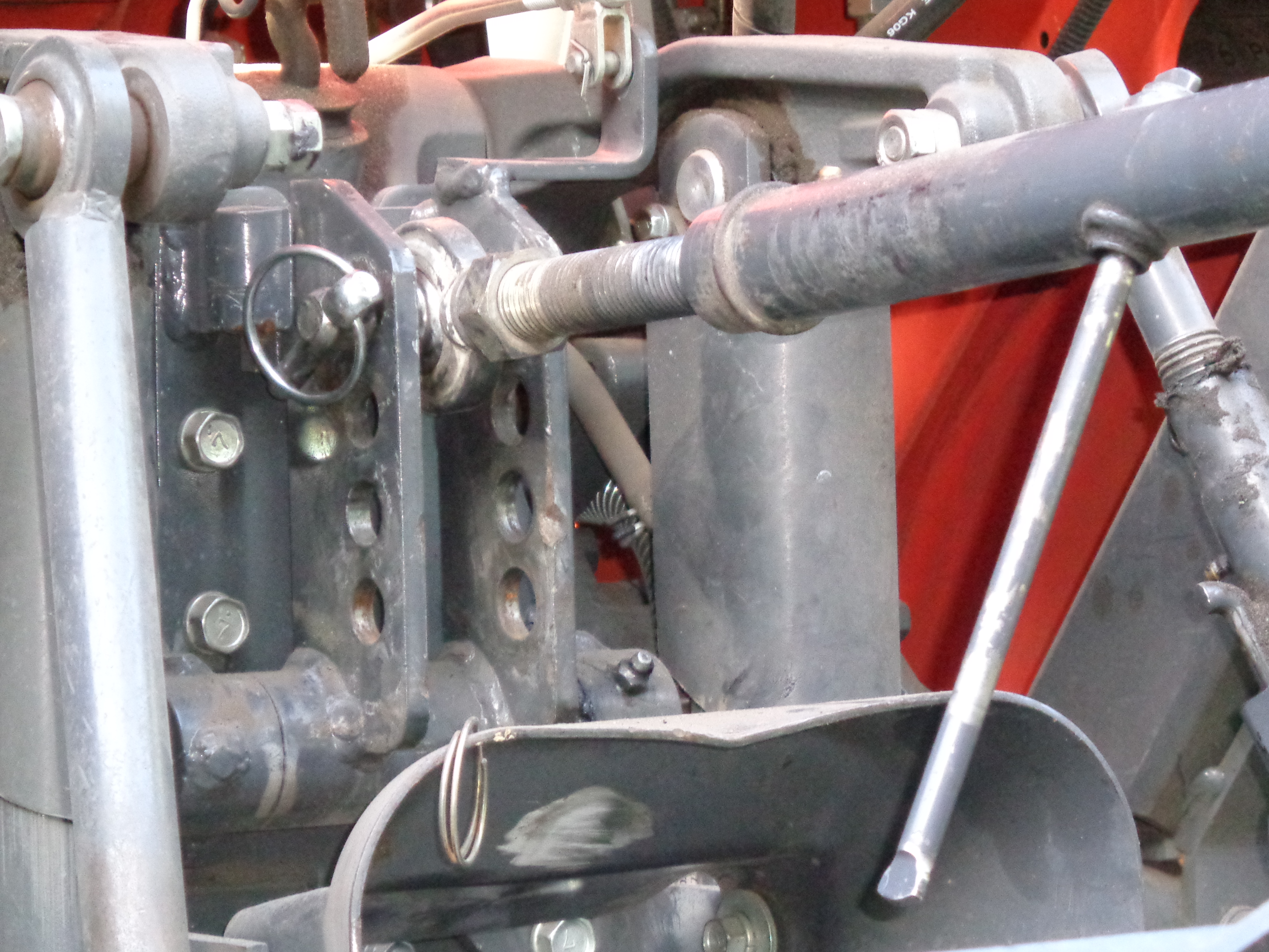

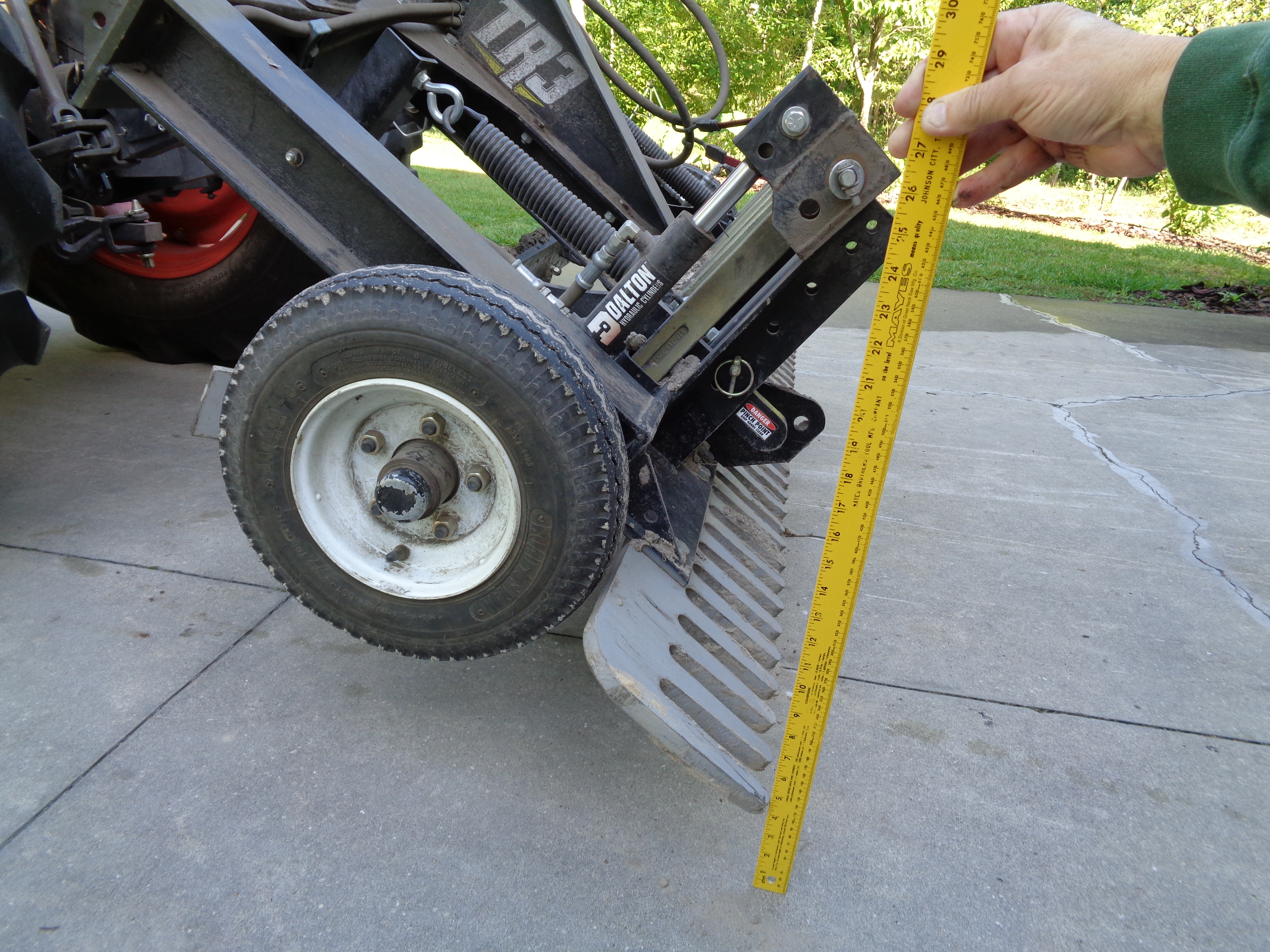

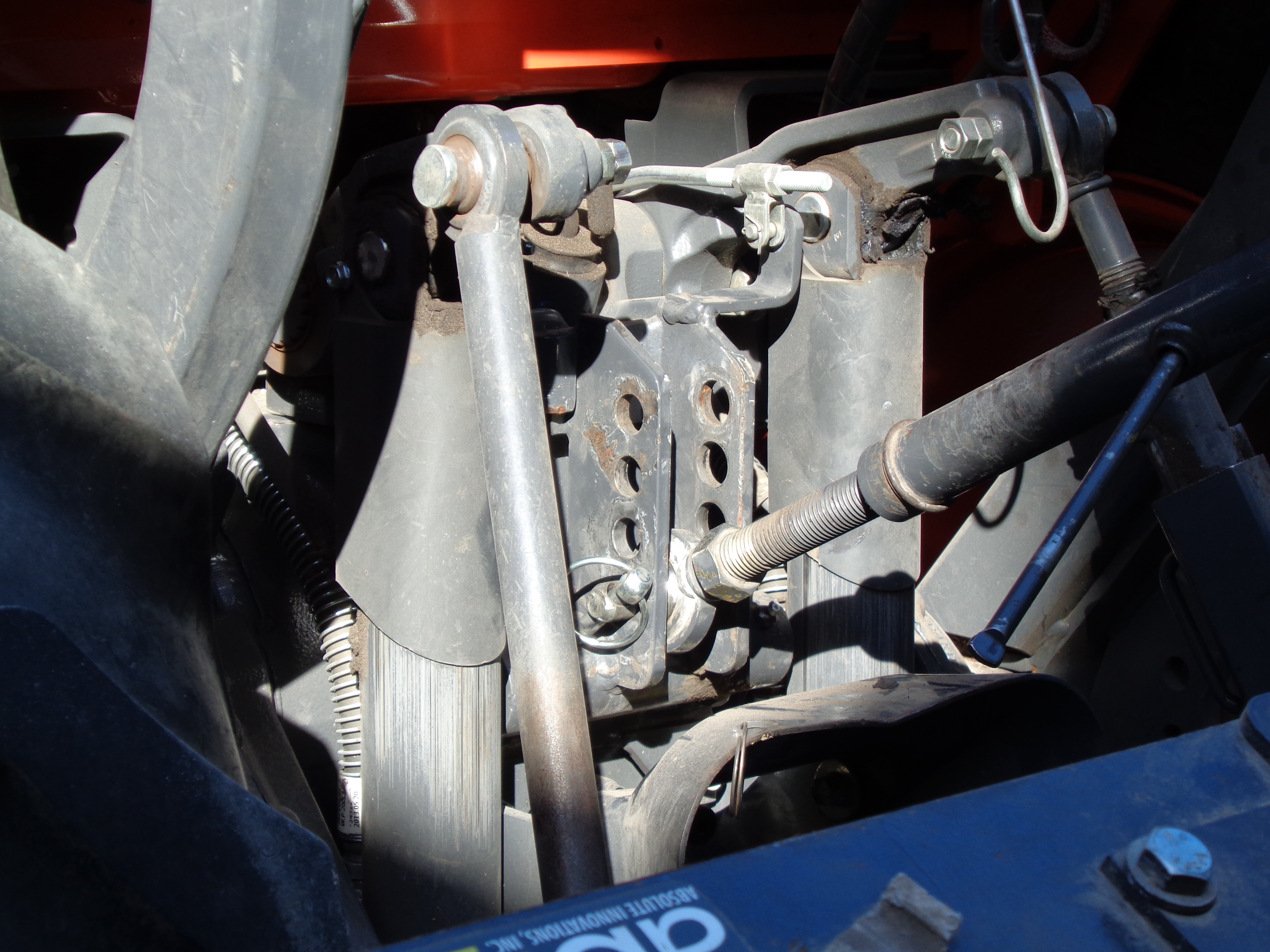

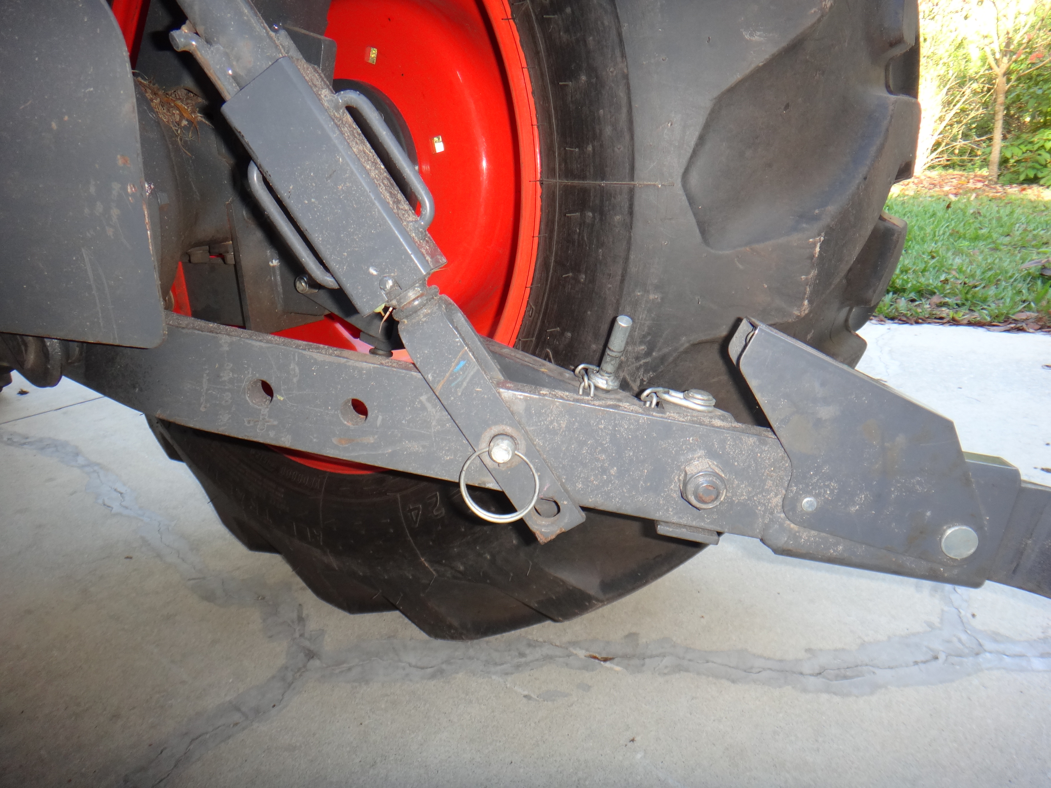

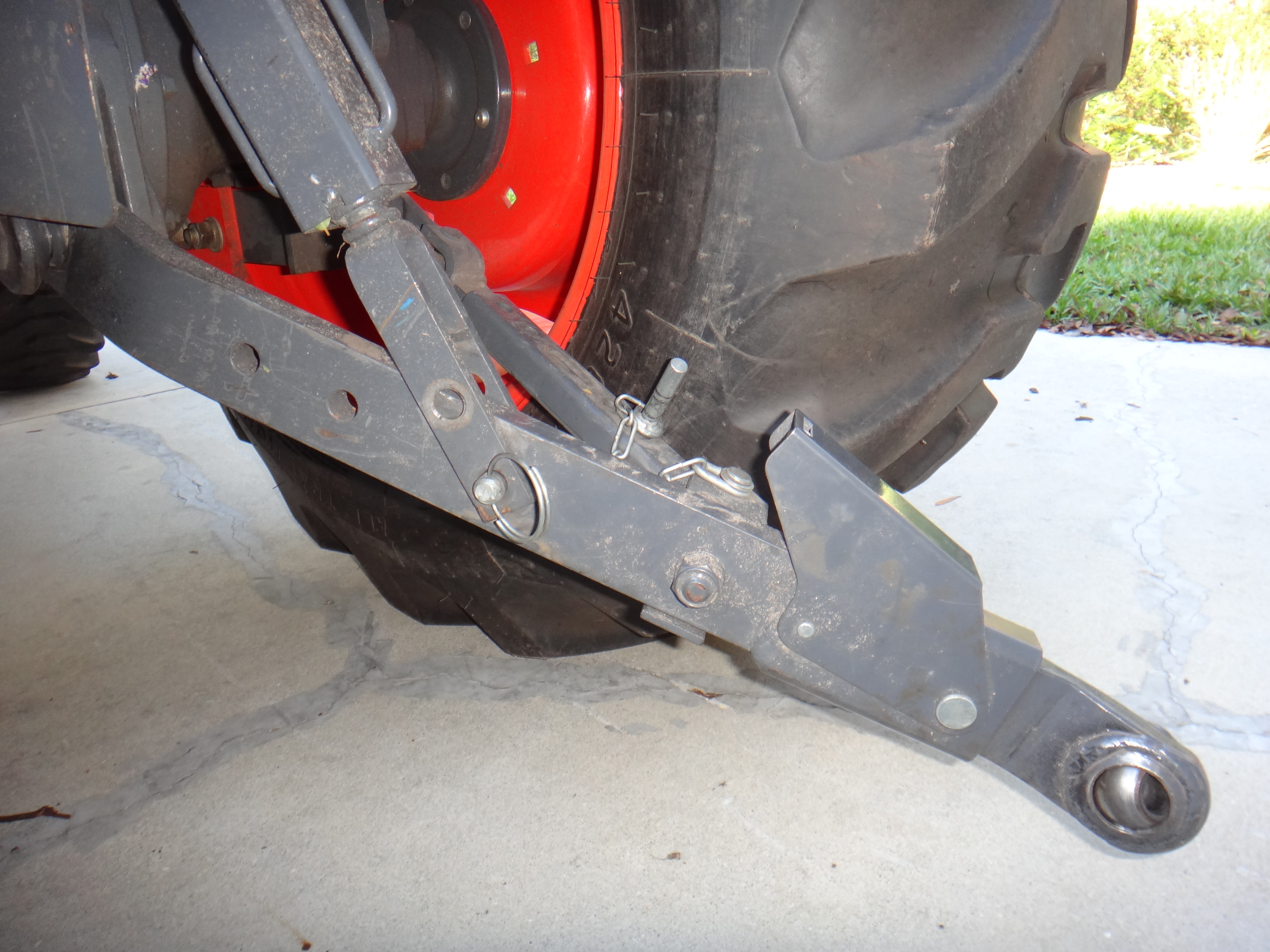

How wide was the mower? The OP's issue is 5' or 6' implement width.
Are L3800 left and right Lifting Rods positioned in the top hole? Top hole will provide 7" of additional lift for a mower, relative to lower holes.
(PHOTOS #1, #2) ((HIGHER HOLE = HIGHER LIFT))
Is the inboard end of your Top Link in the lowest of the three or four paired Draft Control holes? Lowest pair of inboard Top Link holes (PHOTOS #3, #4) will provide 4" of additional mower lift, relative to top pair of holes. (PHOTOS #5, #6)

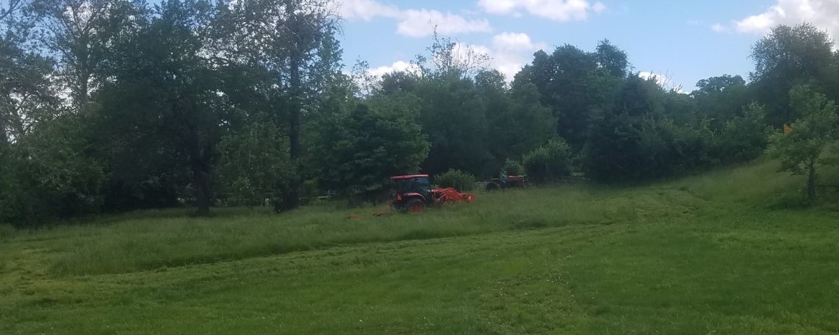

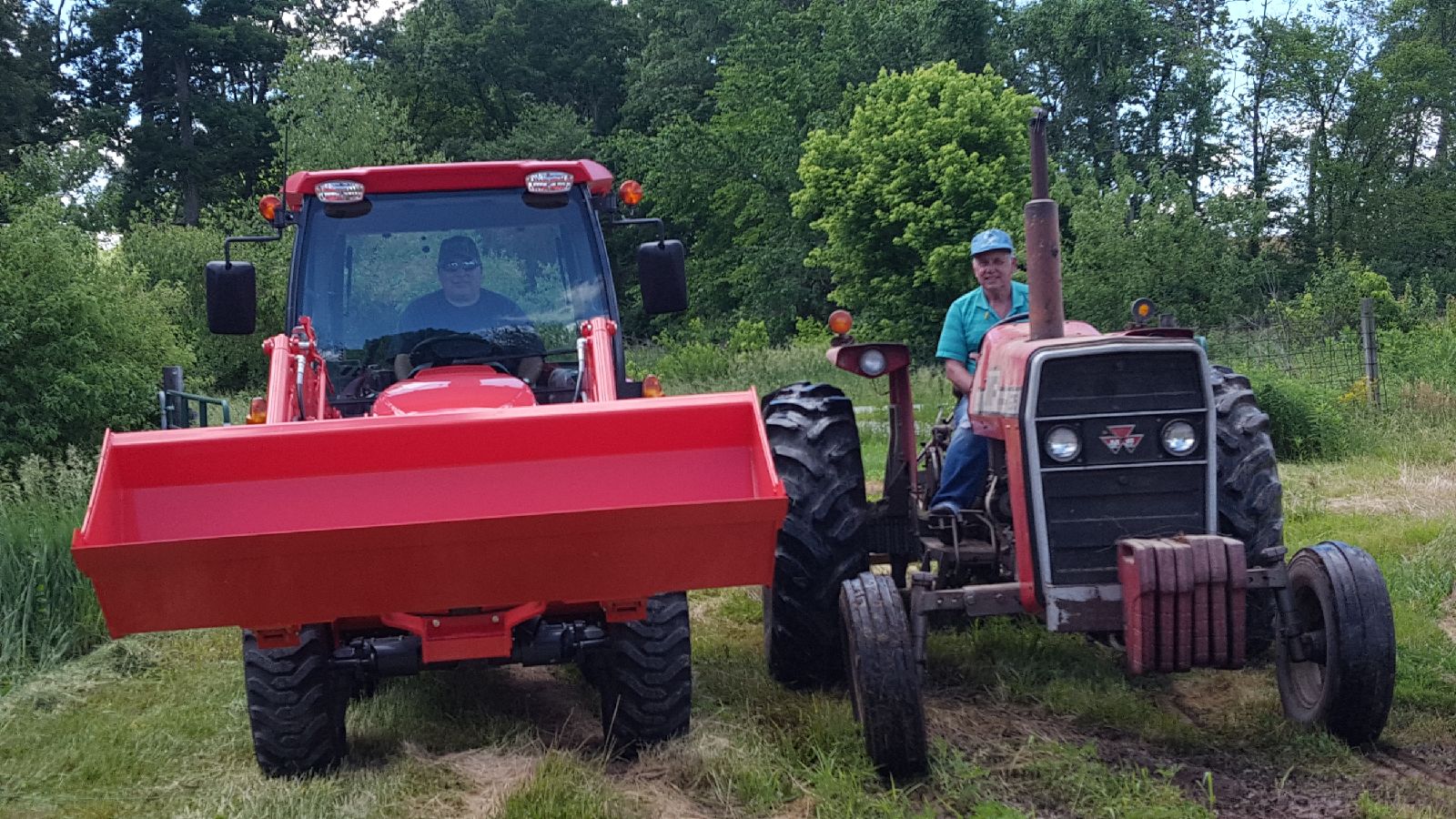

I'm new to the forum and to owning a tractor. I purchased the Grand L3560 and a Land Pride 72" rotary mower. I have been using it for two days now mowing grass from a few inches to over 4 ft tall.
I had to mow in low gear, but the tractor did fine. My dad was able to mow faster on his old MF265, but he has about double the HP that I do.
The areas that had been kept up, I was able to mow in medium gear, but honestly learning the tractor and how it feels, I mowed mostly in low.
So, maybe that will help you with decision. If I did it right, there should be a picture of me mowing in my tractor and my dad on his (not the best picture).
