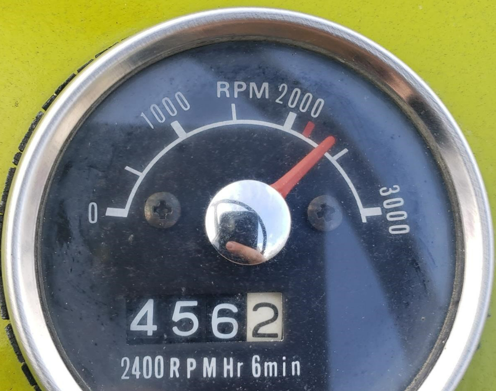

Many times the tach has a mark showing where RPMs generate 540 PTO speed. This one is the red mark.
