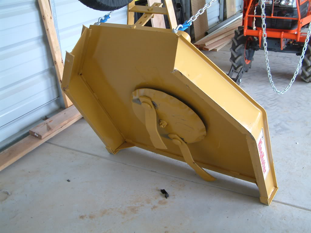

I am thinking I need to put a chain drag on the back of the brush hog. I also managed to hit myself in the face with a chunk of rock today. I am sure it bounced several times first, but it still wan't pleasant.

No, not the first time, but this time was special.
You know what is worse that the bolt shearing off and throwing a blade?
Throwing a blade right into the side wall of your front tire. I got a hole I can stick my hand through. Don't think that one is repairable.
And these tires aren't cheap. Best price I found was $95 for the Carlisle Multi-trac C/S 23.5x10.5x12 turf tires I have on there.
Well that didn't make my day.

On the larger brush hogs (my PT) you will find a rubber lip that is probably 6" wide and 1/2? thick that is bolted to the back. Nothing is bolted to the front or sides (there is no exit shoot on the PT hogs). I have also seen chain hung from the back of hogs as well.
In all of this you have to be careful about stuff getting sucked back in. Also, I am not sure about putting anything on the front. My feeling is I want stuff to get out from under the deck and where I live things being throw out front are of little concern.
The only big mod I made to my PT is I took my torch and i cut holes in the top deck to allow me to access the broken bolts from the mower blade. I also now use longer bolts to hold the blade (be careful as you don't get one with too long of a shoulder) and then I made a driver to push the broken bolts out.
Oh, I made my own blades. I run 1/2" thick hardened steel blades. Not sure if there is an advantage or not to be honest. Anyone want to throw in on the physics?

I'm still thinking about removing the factory blades, shortening the center hub up by 2" and then using standard off-the-shelf brush hog blades with the gull wing design similar to these to help prevent the blades from shearing off the bolts on the adjacent blade.

...Actually, far more compressed/caked grass into the left wheel rim cavity (around the hyd. motor) than expected....
The first time I mowed about 3 acres with the brush hog, I was not paying attention to the grass build up around the front tire.
Until the grass ripped out the inner valve core, and then as the tire deflated, the mass of grass broke the bead on the tire and it jumped off the inner side of the rim.
oops.
This is a good solution to the valve core problem (which I did after the second time the above scenario happened):
Amazon.com: Mr. Gasket 5102 Flush Mount Tire Valve: Automotive
WRT the grass buildup, I found a couple quick backward and forward movements tends to help dislodge the grass, and you can reach down and tug it out. This only works if you do it fairly frequently before the grass gets a chance to get packed in there.
Blaze the trail! Once you show how it is done, I will be right there with you. Although, unfortunately, my hub setup looks somewhat different than yours, and it is not clear how to take the thing apart. Still the 4" tall hub should be cut down to about 1.5" or so.

Mudflaps are cheap and can be fitted easily. Or use expanded metal as a debris shield and wear a helmet, My dad did this. It is a bit better mowing on a full size than an older or compact, I am higher up off the ground so that it is harder for debris to kick up that high. I know on my Massey MF35 when I hit something and the slipper starts slipping, I usually hunker down and clutch it. I don't want to lift the deck and risk it throwing whatever out. I also got into the habbit of mowing high stuff backwards
Perhaps just have a bunch of blade bolts and change them every so many hours regardless? or switch to a different bolt?
