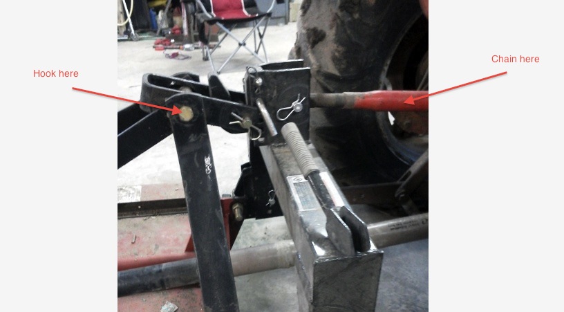

The mower did work fine without the QH, thought maybe there would be a mod to keep the float action and the quick hitch. I haven't given up yet on making it work. My small tractor shredder has a chain at the end of the flat bar that lifts it from the top link, so modifying the BH to similar may be an option.

If you look at his pictures, the pin at the top of the cutter tower that the hitch assembly swings on is in a fixed position in regards to the lower 3pt arm pins. So if his QH top hook hooked on that pin it could not come unhooked because the vertical distance between that pin and the lower pins is always the same. For it to then come unhooked you would have to unlatch the QH and let the lowers come unhooked as well.
Then modify the two flatiron straps that go to the rear of the cutter and hinge them in the middle. This would allow the rear of the cutter to raise and lower with terrain changes without changing the dynamics between the QH and the cutter tower.

Ok, I have the picture now. Along with some more coffee hahaha. You would have to make the flat iron longer than they are now as you would not get any free movement going over a hump. You would in a valley. I don't know how much you would need. Probably only an inch or a little more. I can see the problem with CAT II implements. Sometime a 6' box blade can be a little over bearing for me. I try to keep it on the level cause is it a lot easier.
Yep, I totally understand what you're trying to do. I've saw several cutter use a chain. Never hear of anyone having a problem with that solution. Although the thought of the chain somehow getting loose and wrapping itself in the PTO shaft always freaked me out.

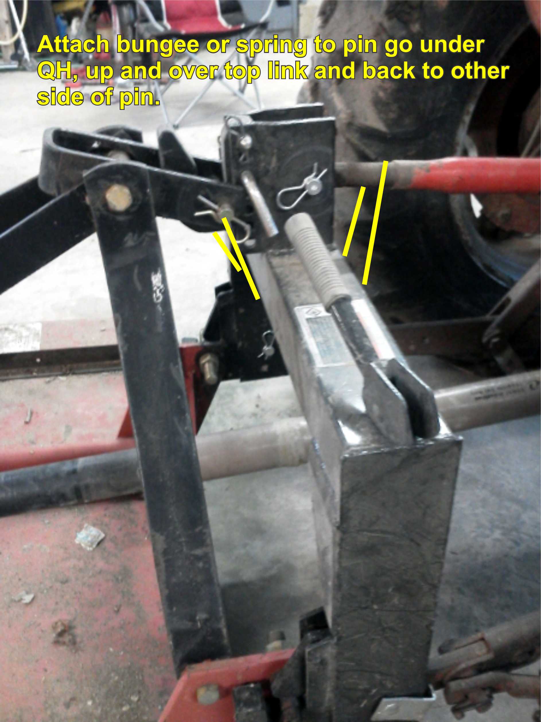

I have an idea,,, How would it work if you attached a spring or bungee cord to keep it from bouncing out. I can see it would be easy to attach to the pin but not for sure where to attach the other end. I'm gonna go look at my mower for ideas
I have a top link pin that has a ring on the end of it and a linch pin on the other You could hook the end of the bungee on the ends of it and around as indicated and it should keep it from bouncing out. Just an idea...

Maybe this? Replace the top link with a chain section. Or make a top link from flat bars with a loose joint in the middle. Or use chain or jointed rear support bars.
Take the flex out of the hitch itself and put it someplace else.

Get rid of the flex link. Hook into the top pin with the QH hook and replace the bars that go from the top pin to the rear of the mower with chain. Do you have a rear remote with a float position? It would be an expensive but handy solution to get a hydraulic top link that you could put in the float position when traversing uneven terrain. Another option would be to get rid of the top pin A-frame all together and run a chain from the back of the mower to a pin in an unused hole in your QH top hook adjustment. How often do you need to pick the mower up? Could you run it only using the bottom pins and not worry about the top? That is how I use my old john deere #5 sickle mower, bottom pins only.
