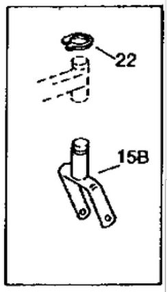

ok, I think after looking at it, and scraping the crud off of it, eclip is right.
   / Bush Hog wheel falls off #11

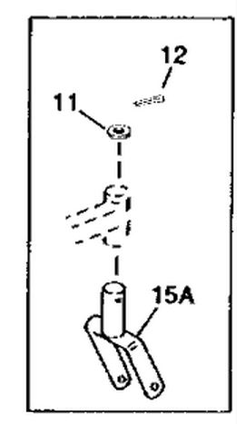

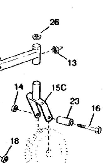

Well you are going to love this.. on the JD site,, there were 3 versions. of tail wheel retainer.. Version 1. a washer that is plug welded to the tailwheel support... Man that sucks.. version 2.. a hole thru the tail wheel support and a washer and a cotter pin. and version 3 with a groove in the tail wheel support and a circlip.
John Deere - Parts Catalog
