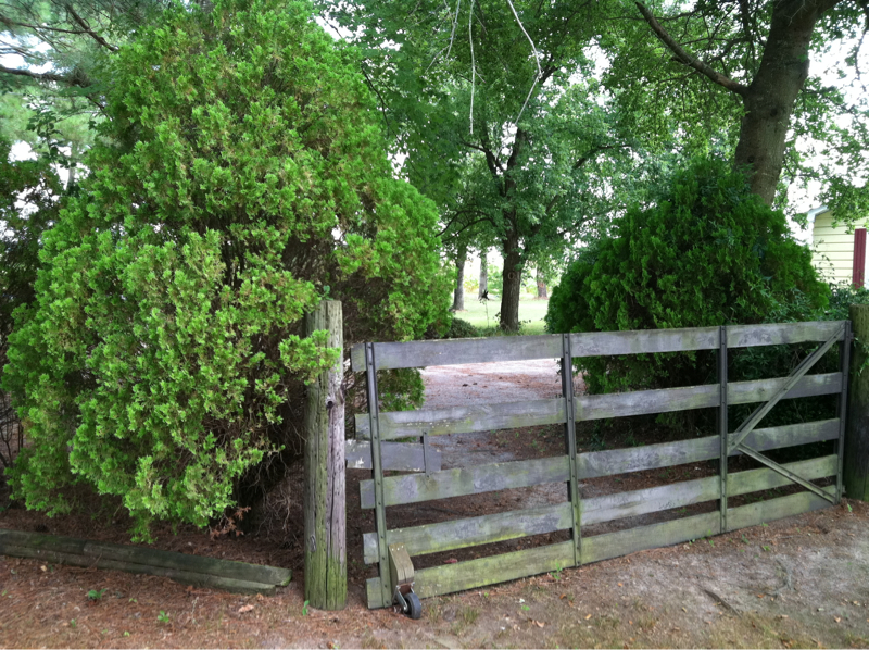

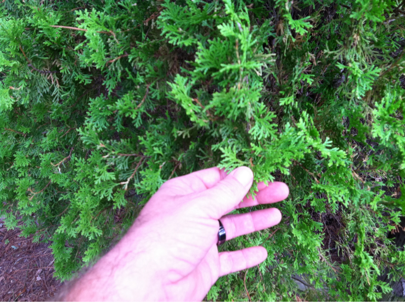

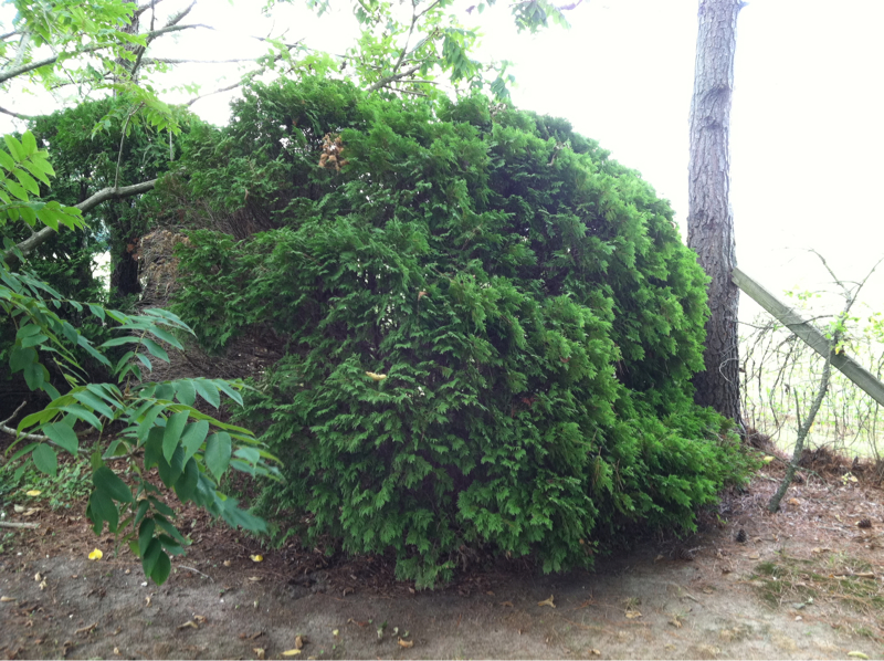

A few pics of the bushes. Waiting on a good rain before I try to pull. First pic shows a good 7' tall ones. Too bad don't have any dynamite. ;-)
