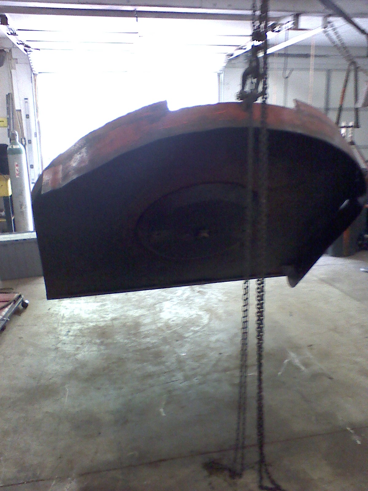

For starters, I have NEVER bought any new implements.
The prices are just too good on used ones that need a little TLC that I am more than capable of:thumbsup:
But I do like good looking equipment and like to keep them painted. Mainly so decks dont rust out and what not.

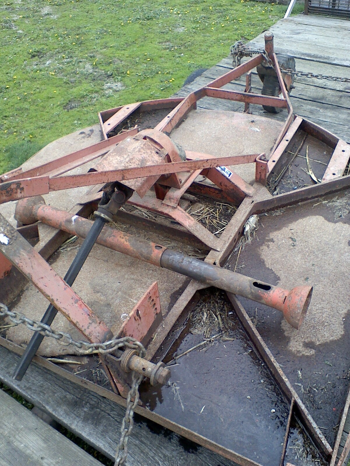

Anyway, here is a Bushhog brand model 306 rotary cutter I picked up earlier this spring. It weighs about 1050lbs. Cost was $200
Heres how it looked when I got it.

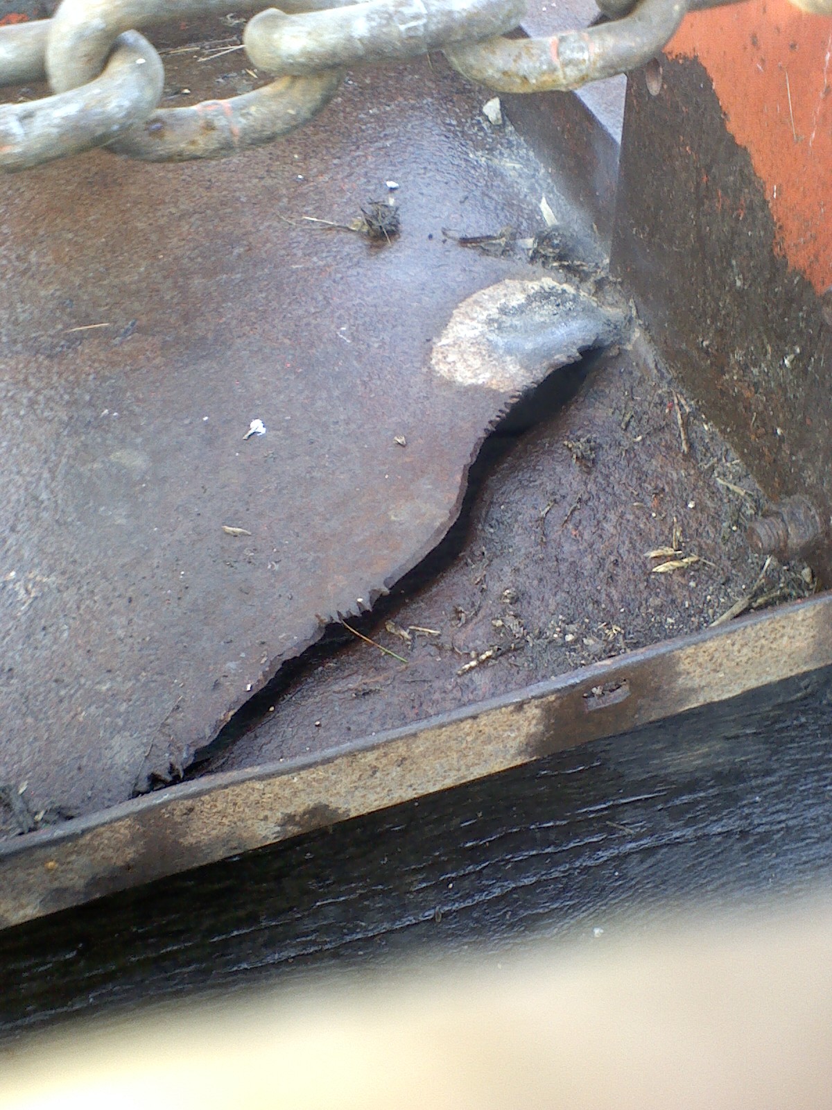

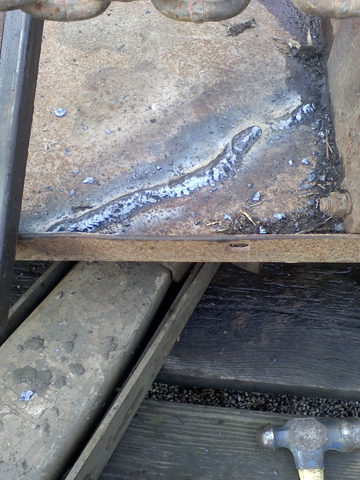

Had to fix the big gash in the deck.
I have been using this bushhog most of the summer and this i all I had to do to it. As well as convert it back to cat 1 pins.

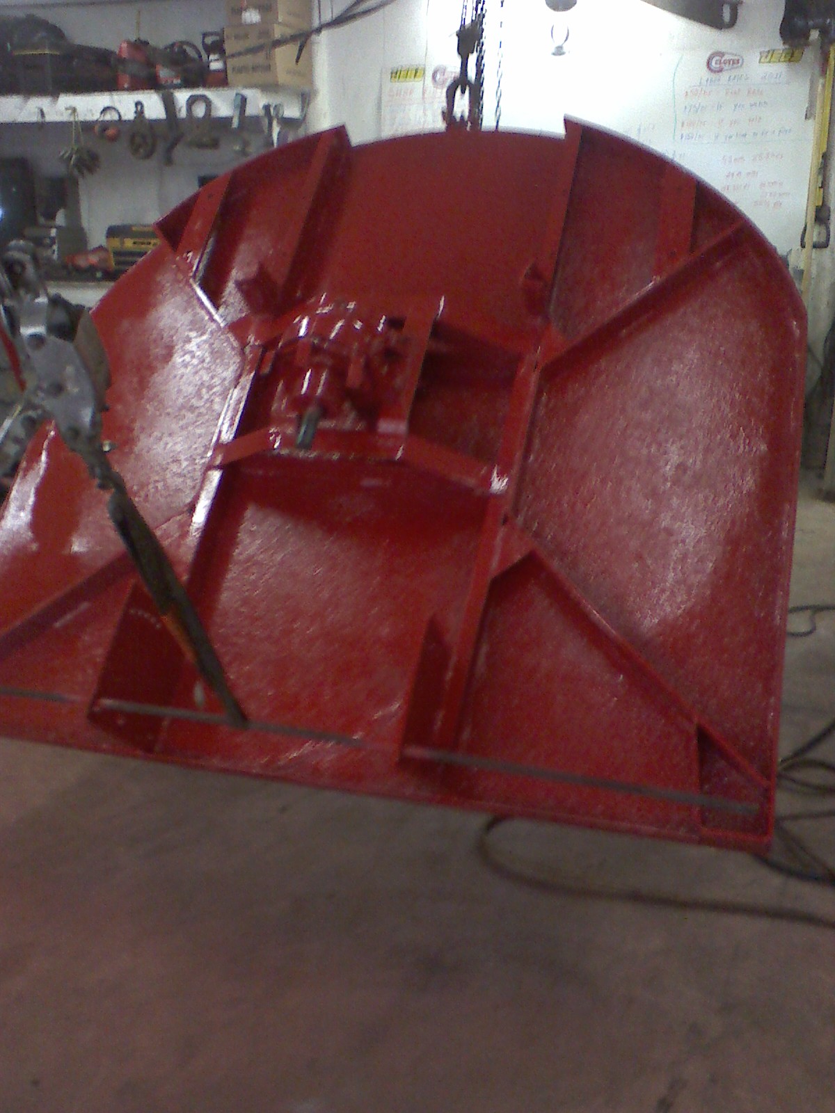

   / Bushhog 306 fresh painting

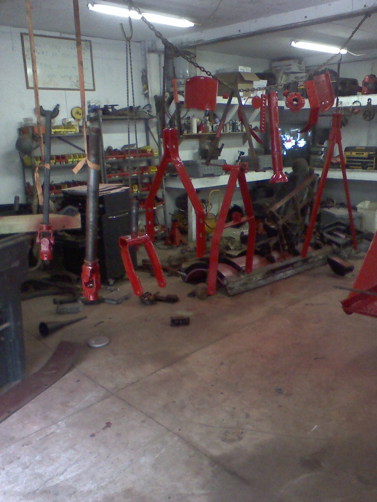

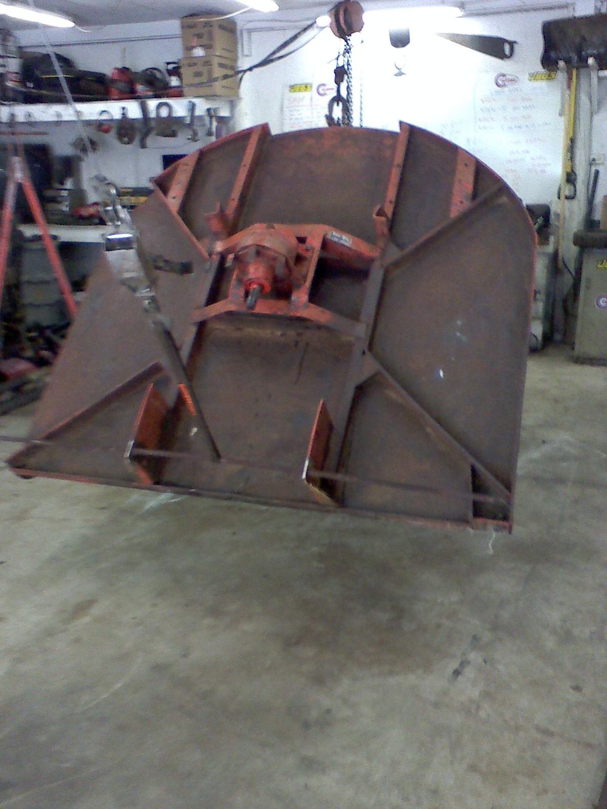

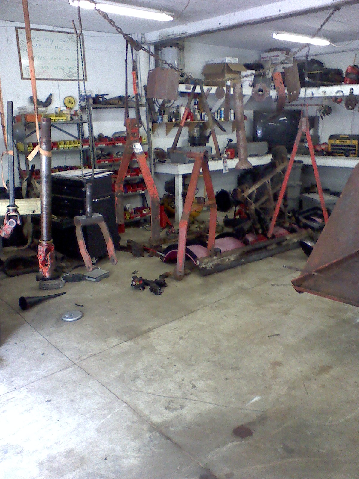

Moving it into the garage and teariing it appart and prepping for some primer.
Final coat of paint. Just needs reassembled

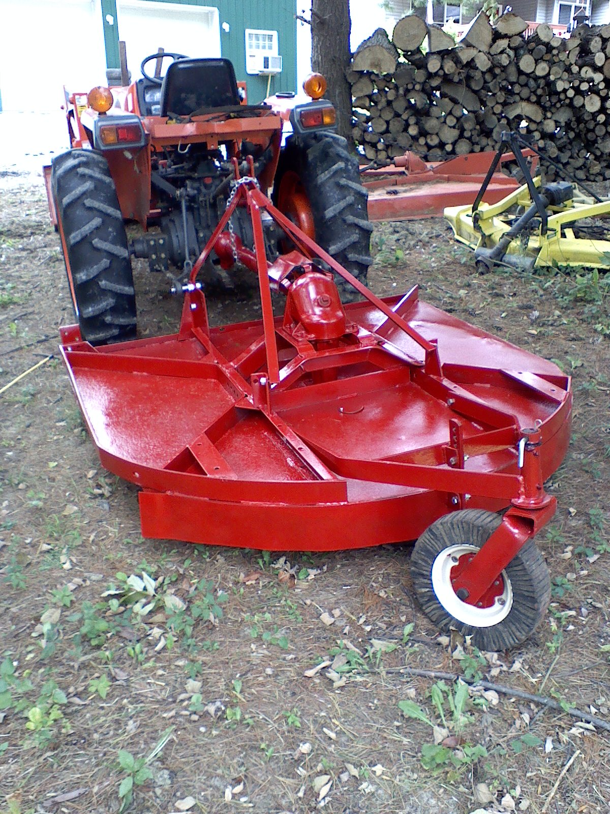

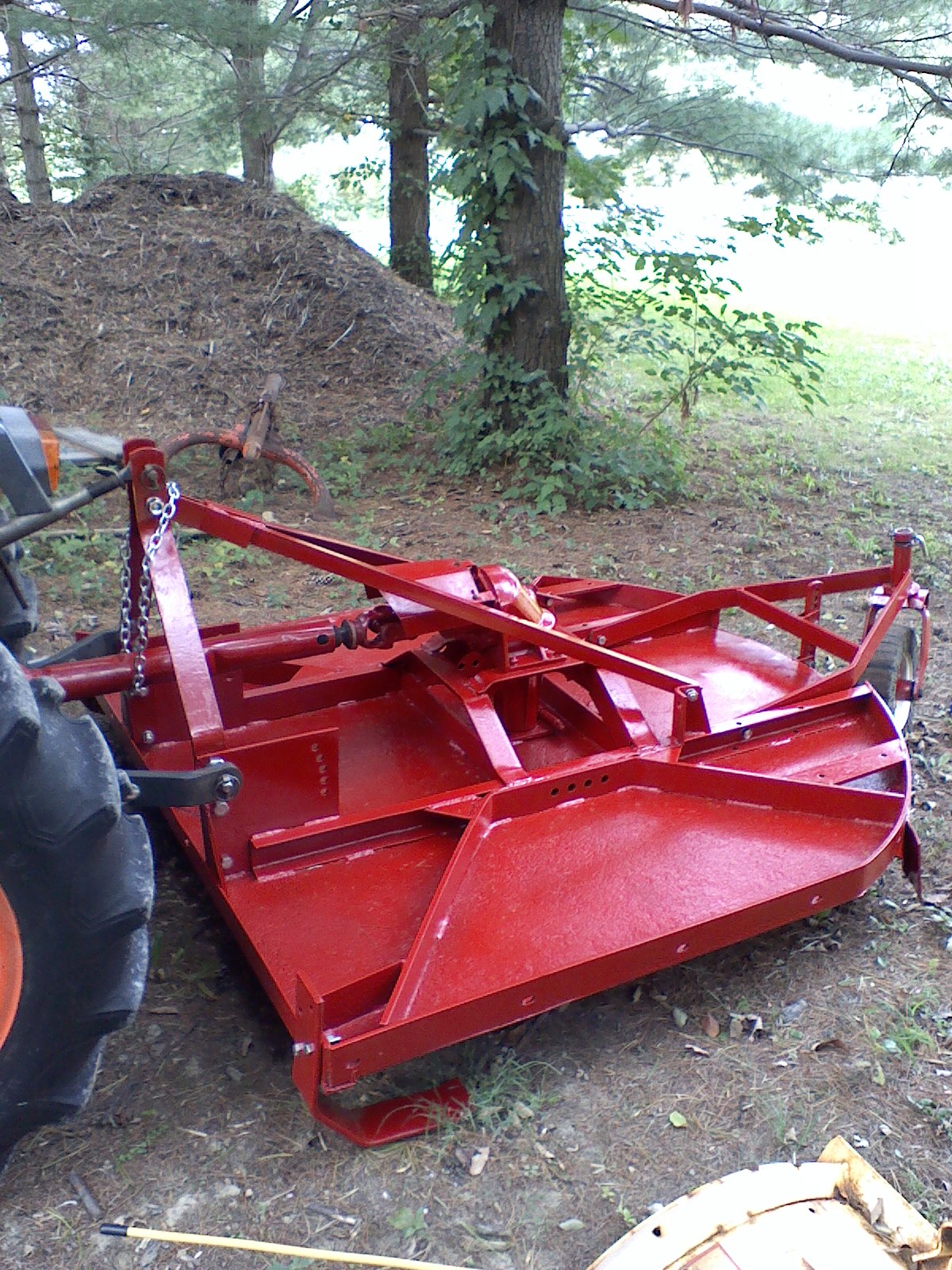

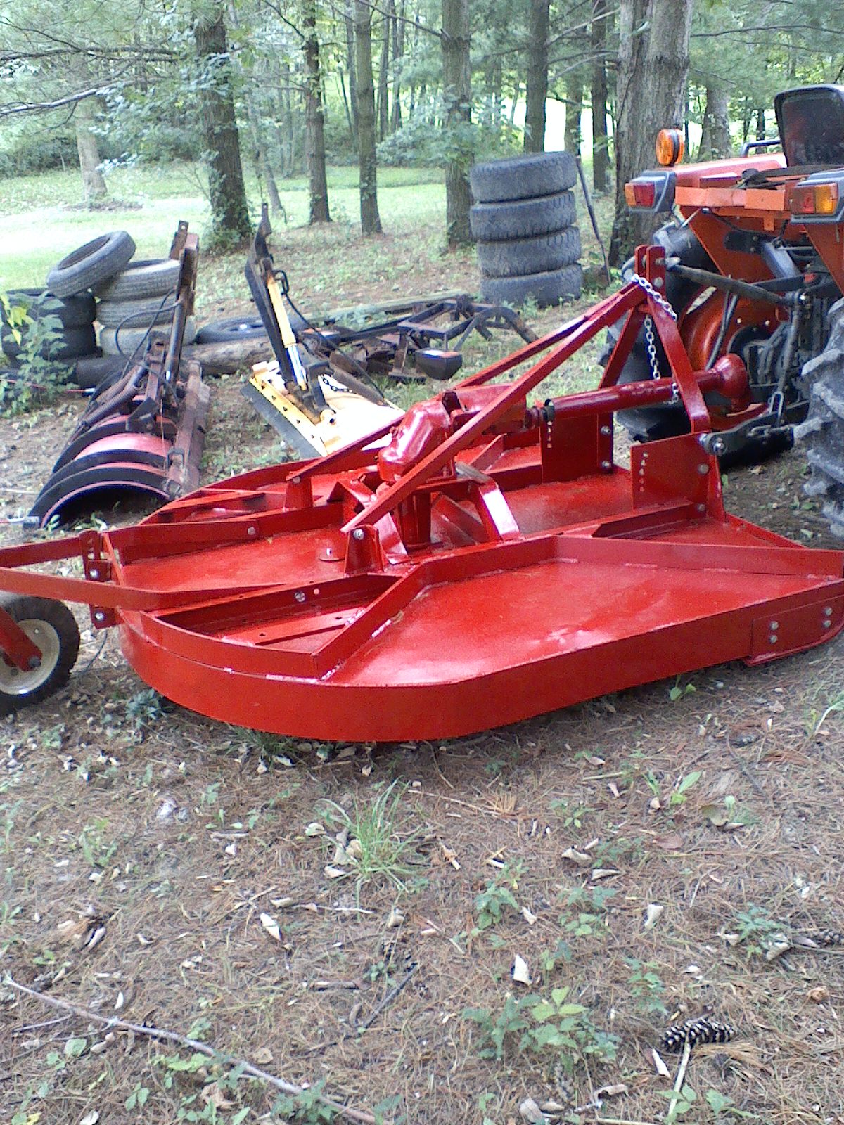

And here's how she looks now.
Total cost:
Bushhog......................$200
3 7014 welding rods........$00.25
quart of primer...............$20
Quart of IH red...............$20
Can of hardener..............$12
Pint of thinner................$10
_____________________________
TOTAL INVESTED..........$262.25:thumbsup:
And this thing is a beast. 2.5" and 3" trees dont stand a chance:D I have already cut about 20 acres with it this year, before I painted it. And it is a BEAST for sure.

   / Bushhog 306 fresh painting #6
Nice job on the restoration! Looks like a new bush hog. :thumbsup:
At 1/10th the cost:thumbsup:
I really enjoy fixing these old things. Gives me something to do in the shop when I dont have anything else going on:thumbsup:
   / Bushhog 306 fresh painting #8
Nice job!
"IF" you didn't add them from the before to after pictures, I think I would drill a 1/4" hole in each corner of each compartment on top of the deck to allow the water that was standing on the before pictures somewhere to go. Just a thought, unless you store it indoors. Decks rusting out seem to be the only thing that kills those around here.
David from jax
#9
Nice job!
David from jax
I thought about that also. and its still not too late.
But the water is only part of the issue. IT is the debris and and weeds and such that build up and make it a PITA to clean. They would probabally just clog the holes anyway:confused2:

It came out very,very nice ! :thumbsup:
I see you even took the time to paint pto shaft shield.
