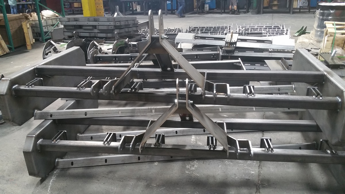

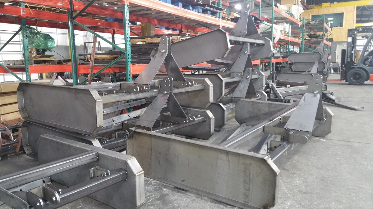

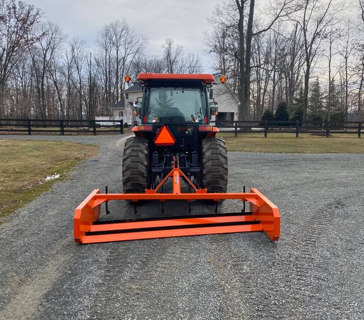

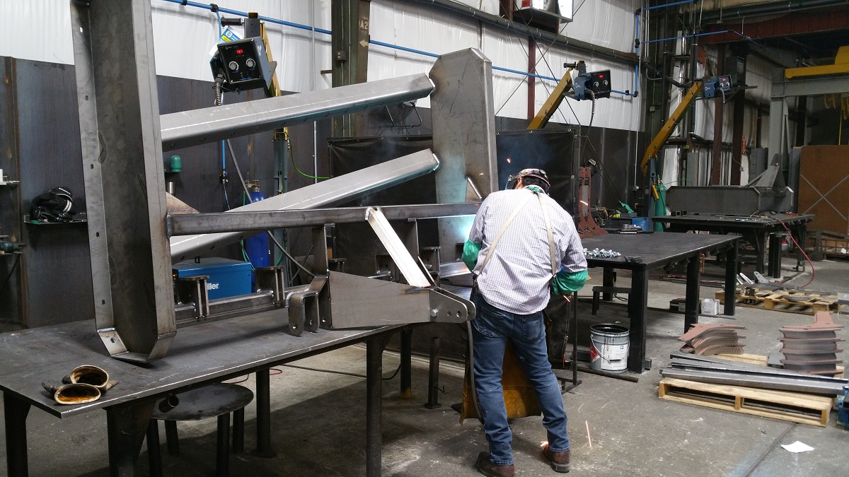

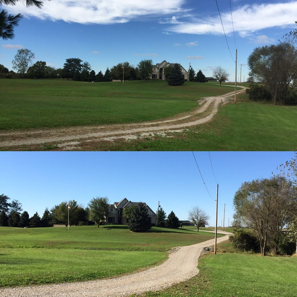

If it's a steal, you probably won't be disappointed, but someone recently asked me to compare one with our EA Xtreme Land Plane.

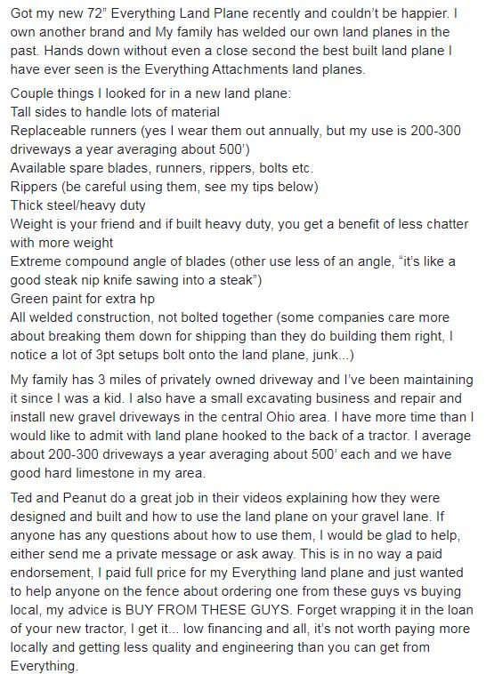

EA Xtreme is taller, deeper and heavier. Ripper shanks are mounted behind the tube, rather than through it, for maximum durability and rigidity. A much more substantial, solid welded hitch with Category 1 and 2 three point compatibily. USA Made cutting edges. A572 Steel Construction. Thicker, fully formed and welded side plates. Cutting edges are on a sharper, more aggressive 10 degree angle for better results faster. Don't just take my word for it.. Check out this review from a customer who has bought two for his successful driveway transformation/maintenance business.
Here's when Jason took delivery. Notice the difference in the EA and the Frontier on the back of his tractor..
A few more customer pics..
Here are some various pics from our factory..
I hope this helps those in the market for one!
Travis

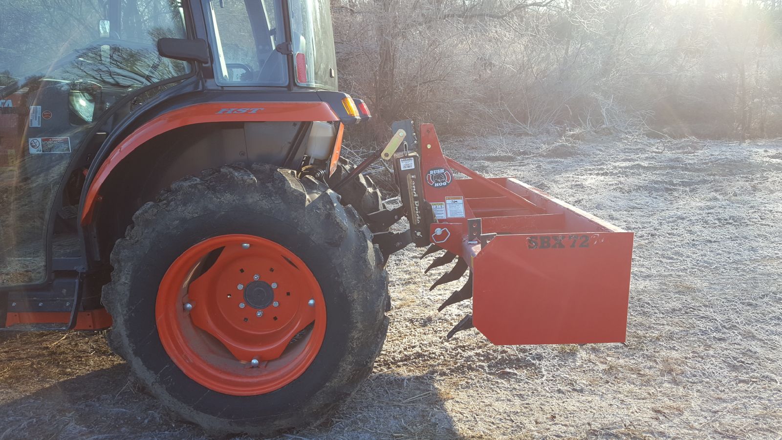

I can't speak to the Land Plane, but we do have a Bush Hog box blade. We were looking and was trying to decide what box blade to get and had narrowed it down to the EA, when my dad stopped by the local Bush Hog dealer and they had a Christmas special going on. We ended up with the Bush Hog SBX72 because we just couldn't beat the price (about $200 difference with the sale and farm discount). Both EA and Bush Hog had the strong frames we were looking for and both appear very well built. I would make the assumption that the quality will carry over to the Land Plane in both models.
