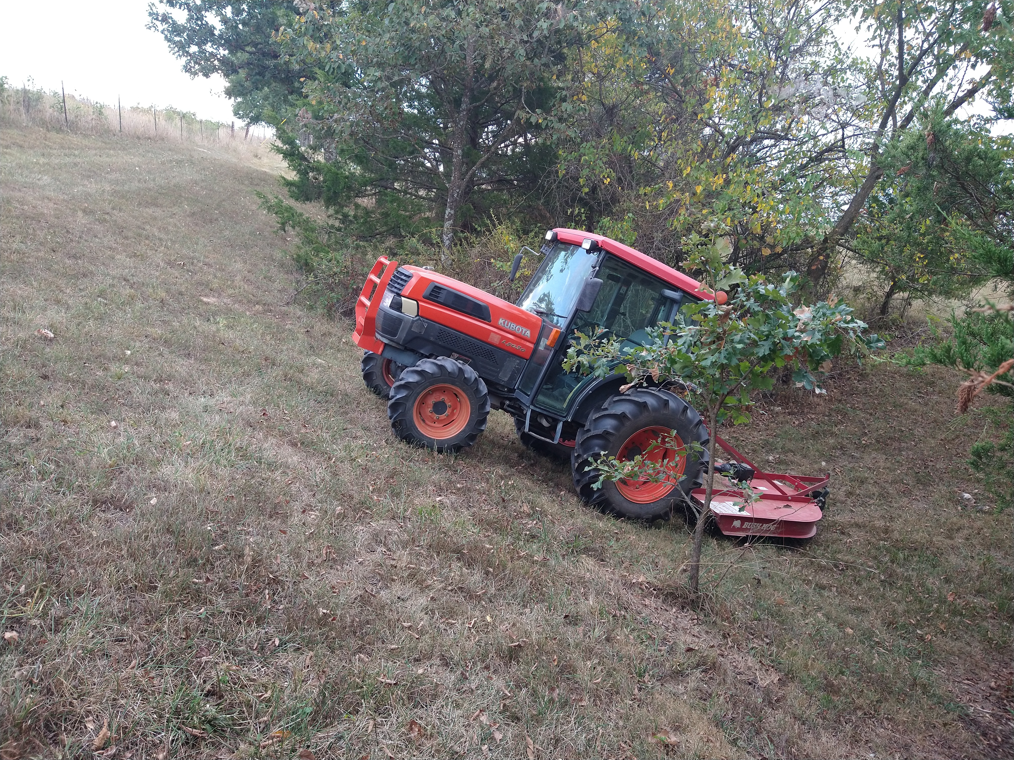

Thank you for all the feedback. I have two questions:
1. If I choose to tackle it, should I go front first down the hill, and if so why?
2. bcp - please tell me more about engine oil starvation. I assume the oil can pool away from the oil pump? How common is this?

Working the slope on a 45º angle will cut the degree of slope in half.

OP,1) I would suggest you reverse down and drive out as this give best traction.
2) reduce the tyre preassure for traction if you are not already near minimum recommended preassure.
3) Try to avoid driving over large sticks as they could cause a break of traction, particularly if damp.
4) wait until the dew has lifted and the ground is dry. Huge difference where you can and can't go between wet, or damp and dry.
5) If traction is suspect ie sticks etc use diff lock.
6) I have topped/brushhogged slopes like yours and it is a matter of reading the ground(eg holes) and vegetation (large sticks) and apply the above 5 points.
Note 1 poster suggested driving up at an angle. Use the DIFF LOCK to hold the nose at the desired angle up the hill NOT the uphill brake. The diff lock method is more stabil as the brake method drags you sideways in an already poor traction situation.
PS Let us know how the job went please.

I mow steep stuff all the time. I'd back down, exactly as you describe. I also agree with 4WD, low range, and be ready on the diff lock. I think the only risk will be the ground is soft and you start sinking in. R4s kind of suck in such conditions. So just go slowly and carefully.
I disagree about driving down forwards and back up. Much better traction going forward. Plus you will have better flotation with the bigger rear tires. Plus you will be able to reach further with the mower while keeping the wheels further away from the edge.
If you start sinking, stop and pull out. I'd also have a plan in case I got stuck. Maybe just a tow strap and a pickup.
