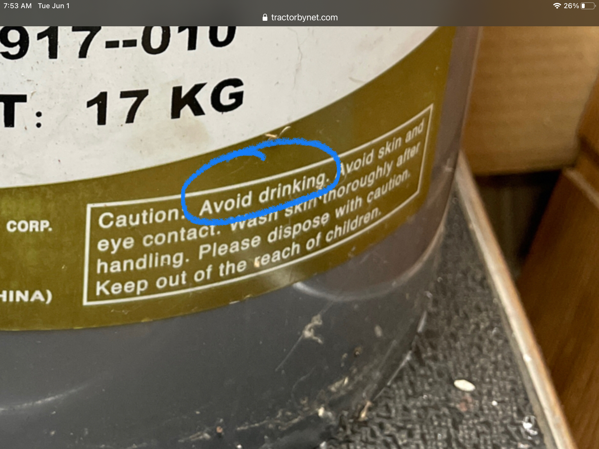

/ Bushog Gearbox Grease #6
Have we gone too far?
“avoid drinking”.
As if some drinking of grease in unavoidable? Lol
