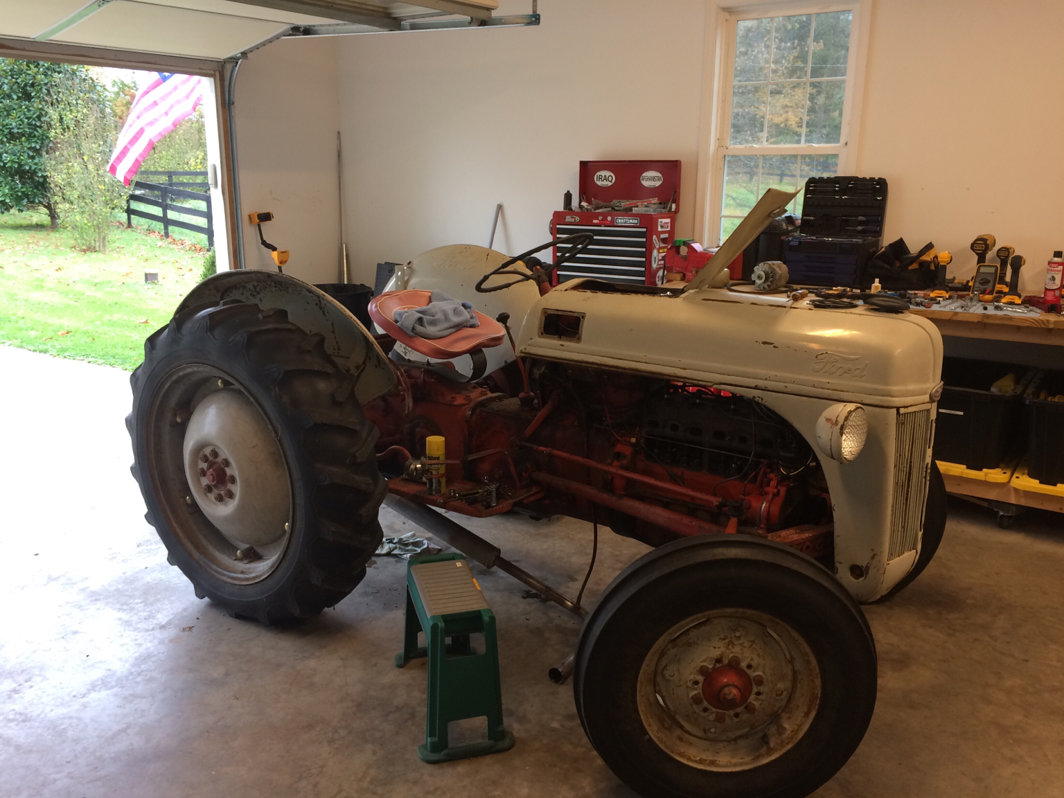

I got the parts in the mail and I took Friday off to work on it. I'll report back after removing the manifold, checking the valve actuation, and replacing the manifold gaskets.

Been pretty busy, but yesterday pulled off the manifold and inspected checked to see if all the valves and lifters were working. All looked good.
Tomorrow will install new manifold gaskets and then take it from the top all over again, re-inspect timing and spark plug wiring.
A lot of soot in the manifold. Looks like she was running rich.

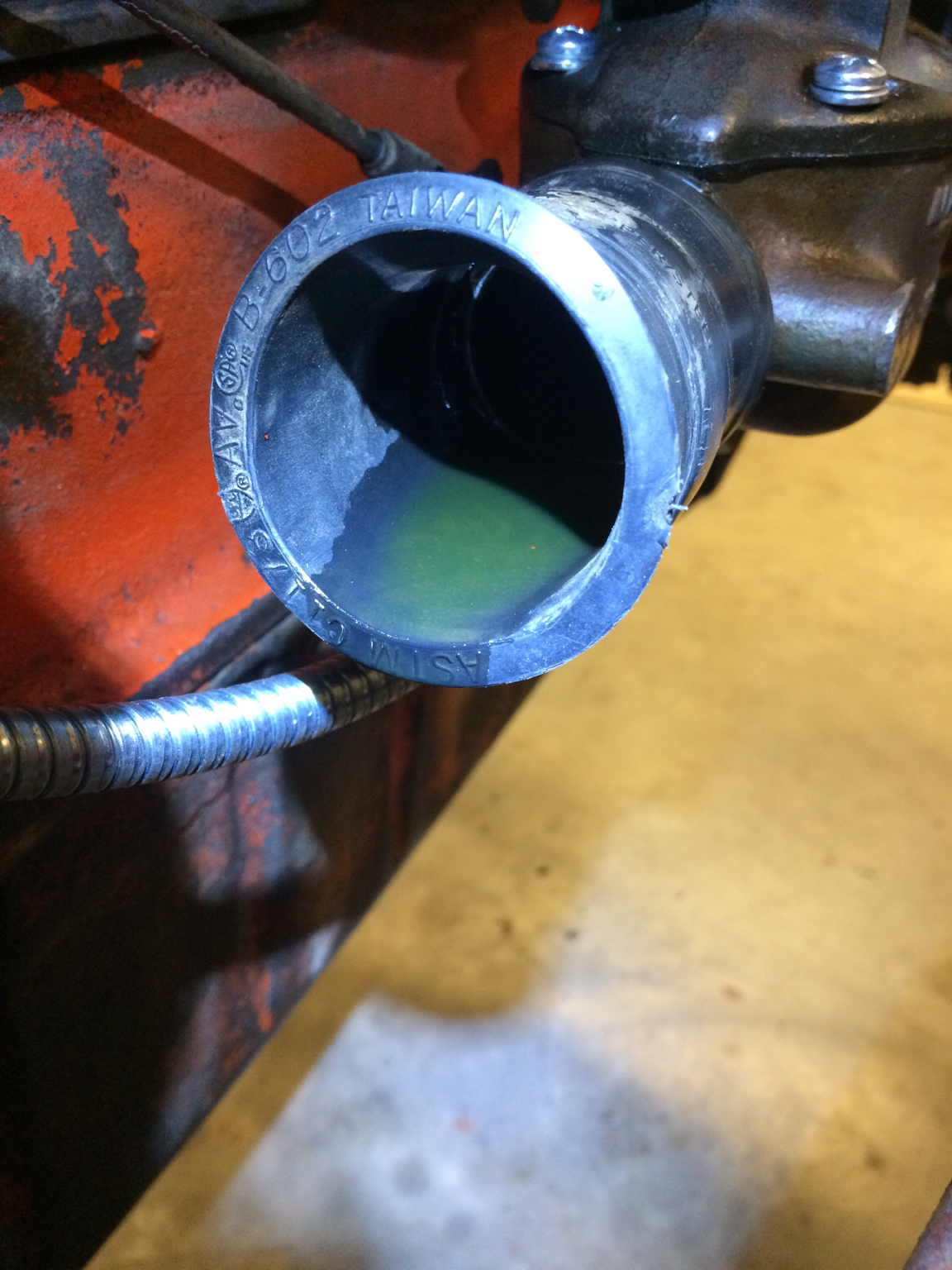

Looking at all the soot escaping at exhaust ports,the intake might have also been leaking and gasket may cure your troubles. While you have it apart,lay a straight edge on head and manifold then use feelers to record variances.

My neighbor and I may have found the problem with the 8N. Put the manifold and carb with new gaskets back on the tractor yesterday and it still barely ran, if at all, just popping and sputtering.
Remember from the beginning the carb was rebuilt? Well, we found gas pooling into the intake pipe, so even though it was rebuilt, it's still having issues. The float was set spec but gas is still getting by the float valve.
We're going to try to fix the original Marvel Schebler carb, but I ordered a new carb to get it running and to have a second spare carb on hand in the parts bin.
We also verified the timing and plug wire routing and everything looks dead on.
I get the new carb on Wednesday and will let you guys know if that fixes it.
