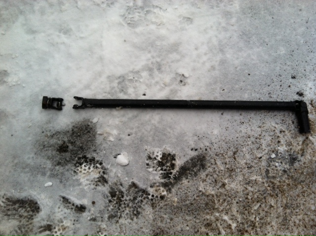

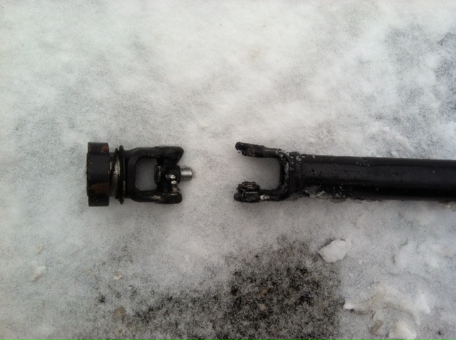

Well, I've busted plenty of shear pins on my gravel road but never a drive shaft. As you can see by the photos, it busted at the joint and because it's a welded piece it won't be easy to repair.
I have the 2410 scut with the 2360 blower. I may try calling the Kubota dealer because my dealer has closed and it's said that they share the same blower with MF.
Any thoughts?

Mine just blew out last week the U joint at the Mid coupler got taken out and the quick hitch assembly tore away from the front bumper. I surmised that the weld on the hitch plate that secures the square stock to create the mounting lip failed causing all this calamity. I was able to get a new shaft at my dealer that day $525.00 as they advised not to rebuild it due to its high rpm. I welded the hitch plate square stock back on and she is back in service what a mess.

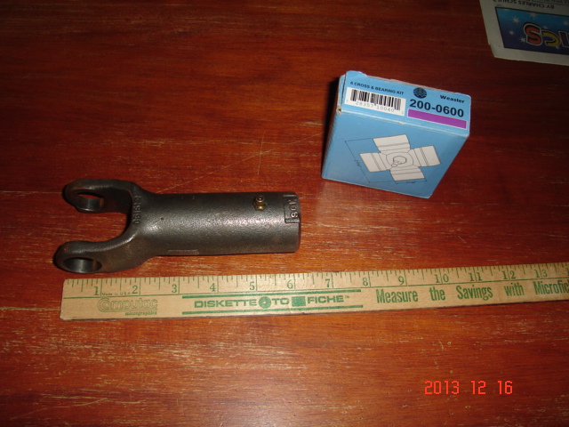

Here's some pics of my driveshaft yoke:
View attachment 350566View attachment 350565
Were you able to rebuild this shaft ? I bought the u joints at NAPA (thank you for the pics I pulled the part numbers from) But my dealer strongly advised me not to do so as it spins at 2000 RPM and they felt it would be a safety issue as well as a vibration issue. $525 bucks, but he had one in stock so I installed it.

The broken U joint center cross should not be repaired. Neither should the yokes. Welding a new yoke on the driveshaft is okay - so whole new U joint, reuse your driveshaft.
Thanks for the reply. I did try the local drive shaft shop and they would not touch it. But I did keep all the parts so if I do some travels to the southern part of my state I will find a more qualified shop and drop it off for repair.

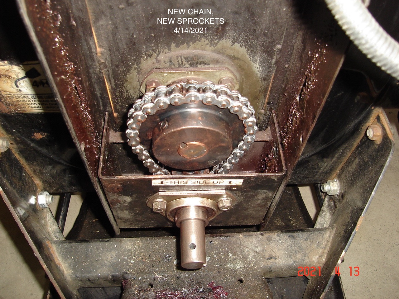

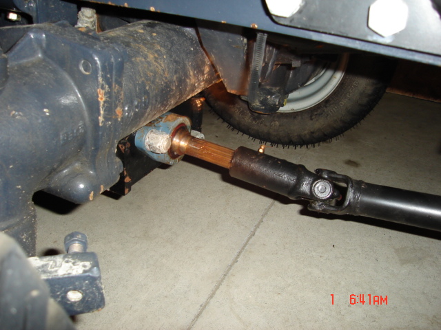

No, I never did rebuild it, because I never had the problem of that shaft coming off. Still have the yoke piece with the longer splined section, but haven't ever needed it. Still have the original parts on the driveshaft & quick-hitch assy -- but I DO check that shaft whenever I service it to ensure it hasn't moved and sticks out that 5+ inches.
PS - I did, however, replace the blower's drive chain & sprockets last year; old ones were pretty worn, with no more chain tension adjustment left.
