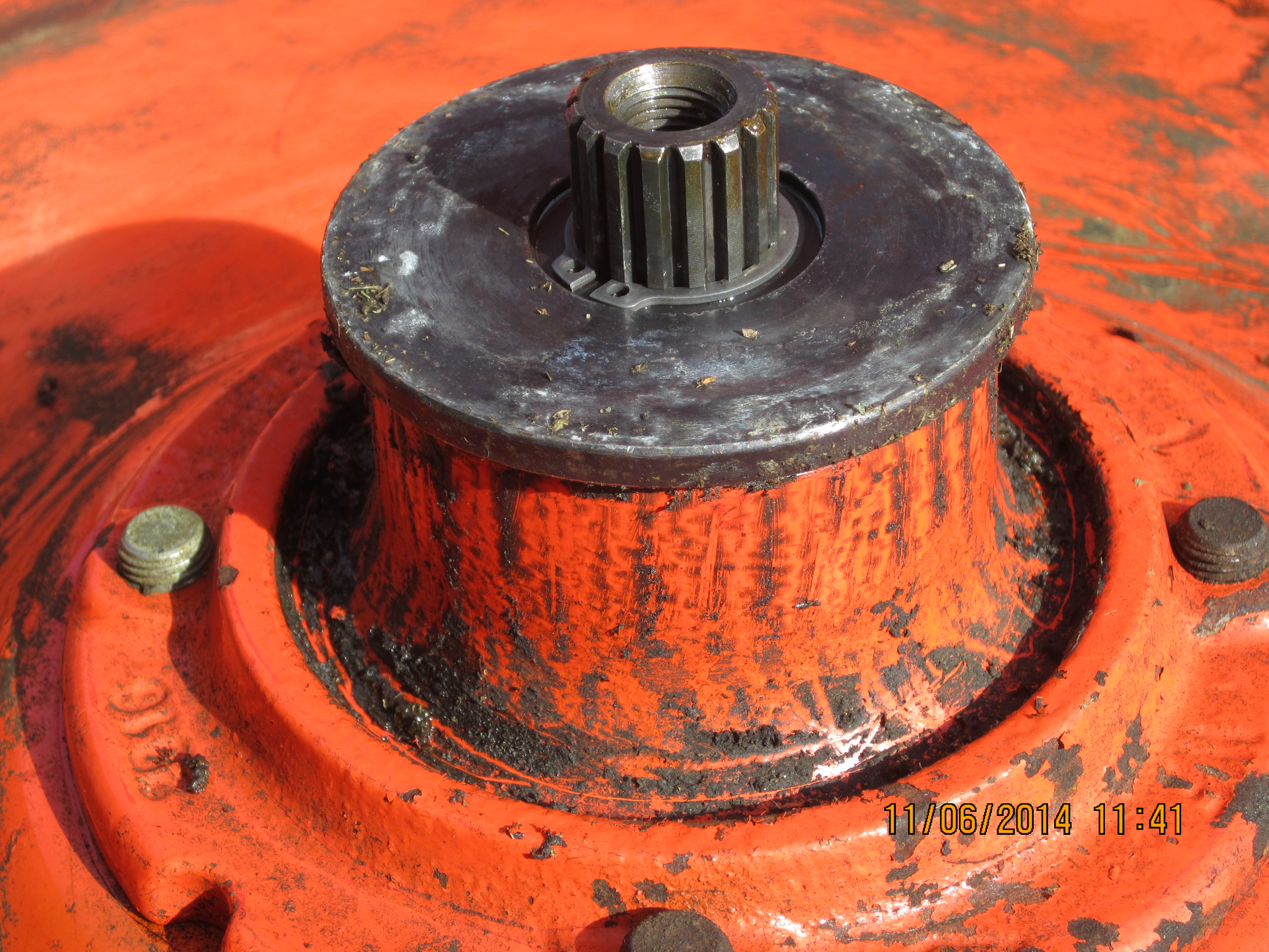

Busted spindle guard prognosis?
   / Busted spindle guard prognosis? #11
Why is grease oozing out of it??
   / Busted spindle guard prognosis? #12
I keep an extra set of cleaned up dust covers, those big washers, and the nut, along with as set of sharp blades ready when I service the deck each fall or spring (when I get to it). Those dust covers do take some "hits" now and then.
Sigarms split in the dust cover is allowing the grease to ooze out ... best I can tell. And he probably has no other damage.

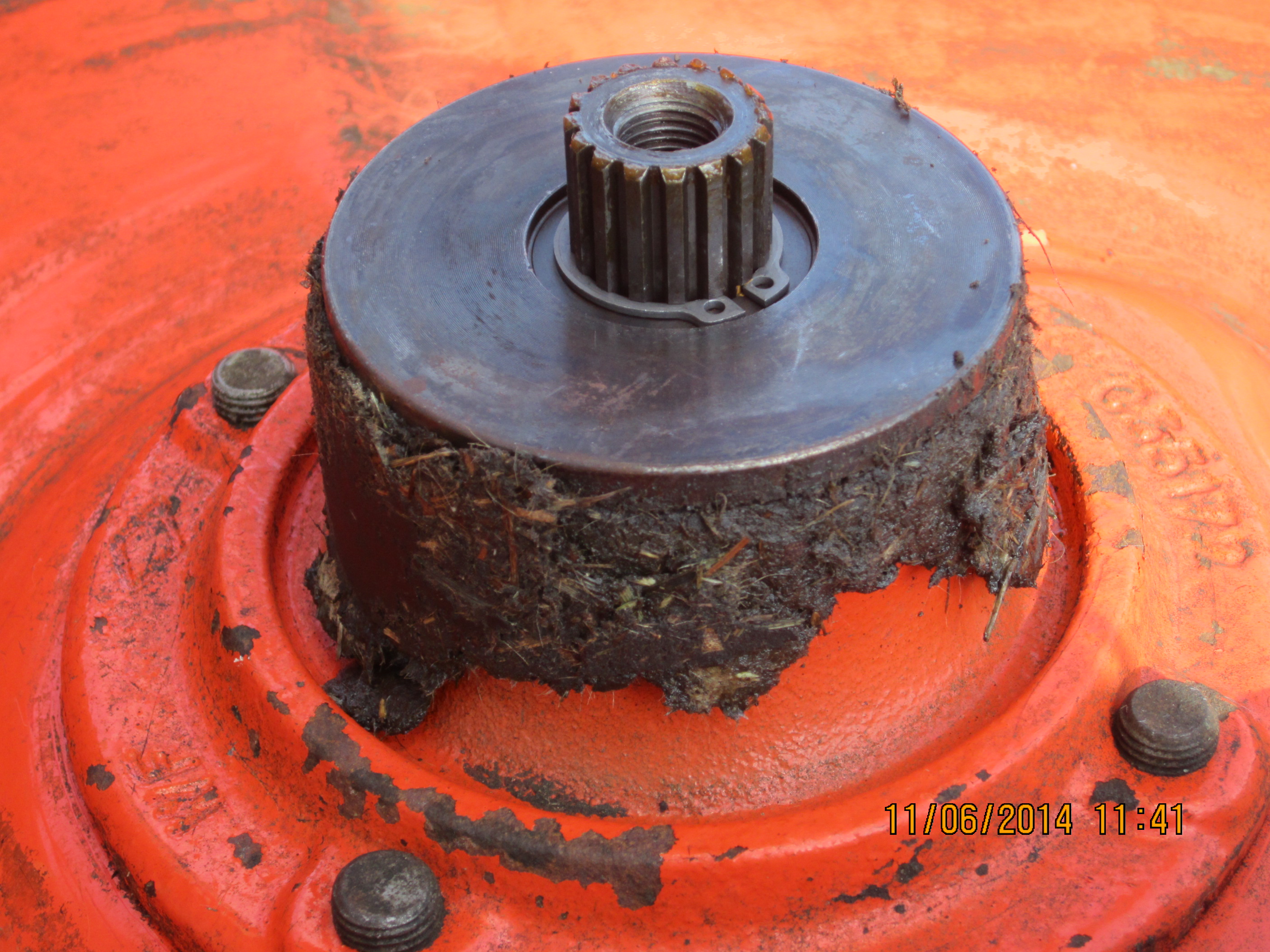

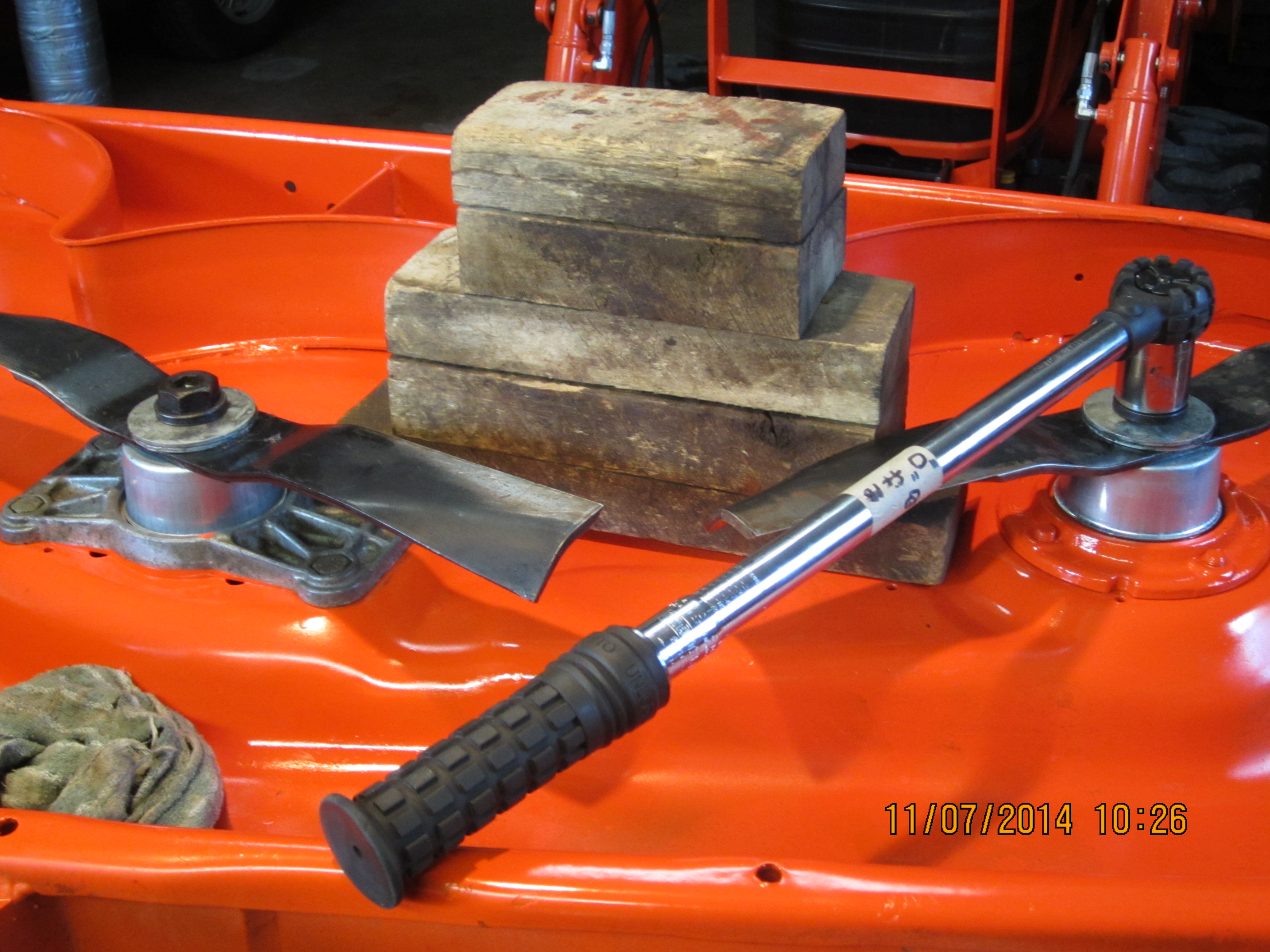

Thanks for the clarity Mike. I originally thought the spindle was cracked. Not sure I understand the purpose of the cover.
   / Busted spindle guard prognosis? #14
782.JPG783.JPG787.JPGMaybe these pics will show how the dust covers work or help protect the spindles from dirt and encase the grease.

   / Busted spindle guard prognosis? #15
I see what you mean - F3060 blade spindles do not have such a dust cover, and the shaft seals are oriented so that the old or excess grease will exit through the top seal.
It's probably good to have a cover like that in order to reduce chance of long stringy stuff from damaging the lower shaft seal.
