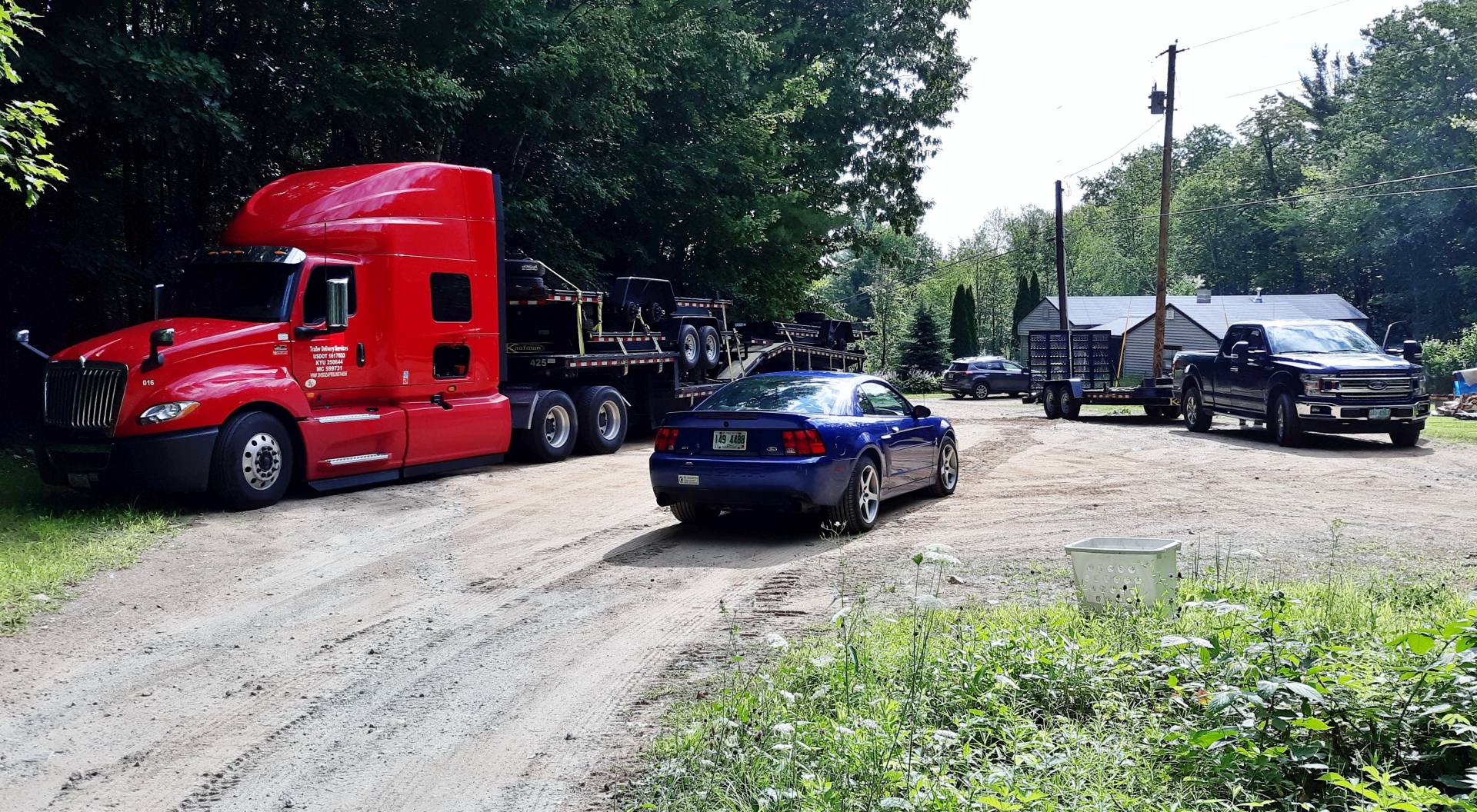

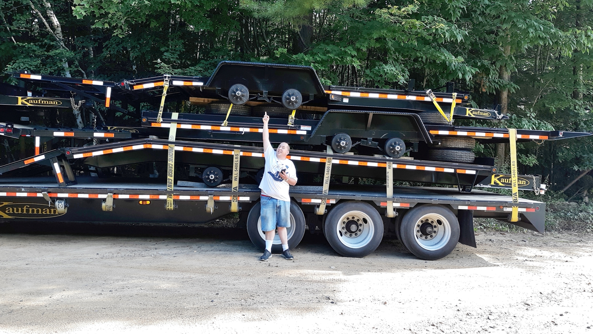

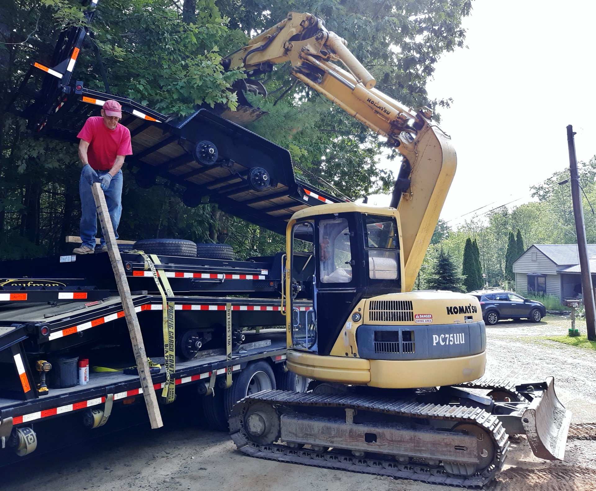

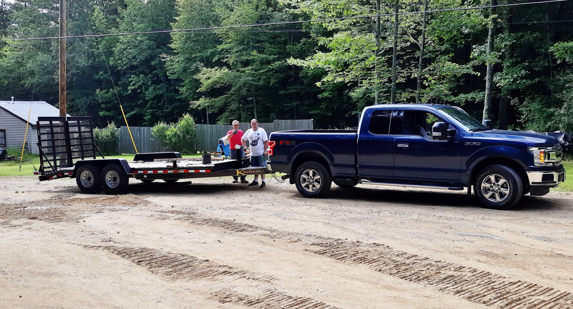

Re: Busy Wife This Weekend, Stepson got a L39 Hauler
Beside knocking down trees, an Excavator can do more than dig holes.
Trailer with 12K axles should be just able to haul the L39.

   / Busy Wife This Weekend #222
Did you buy a new trailer and have to unload it yourself with the excavator?

Come down to TN and I’ll load you up with more free rock than you can haul. I hate that stuff. It makes everything harder.
#224
Yes
Bought factory direct.
in all it was about $1500 less than thru a dealer

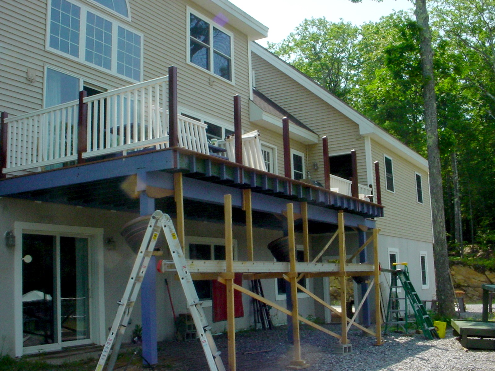

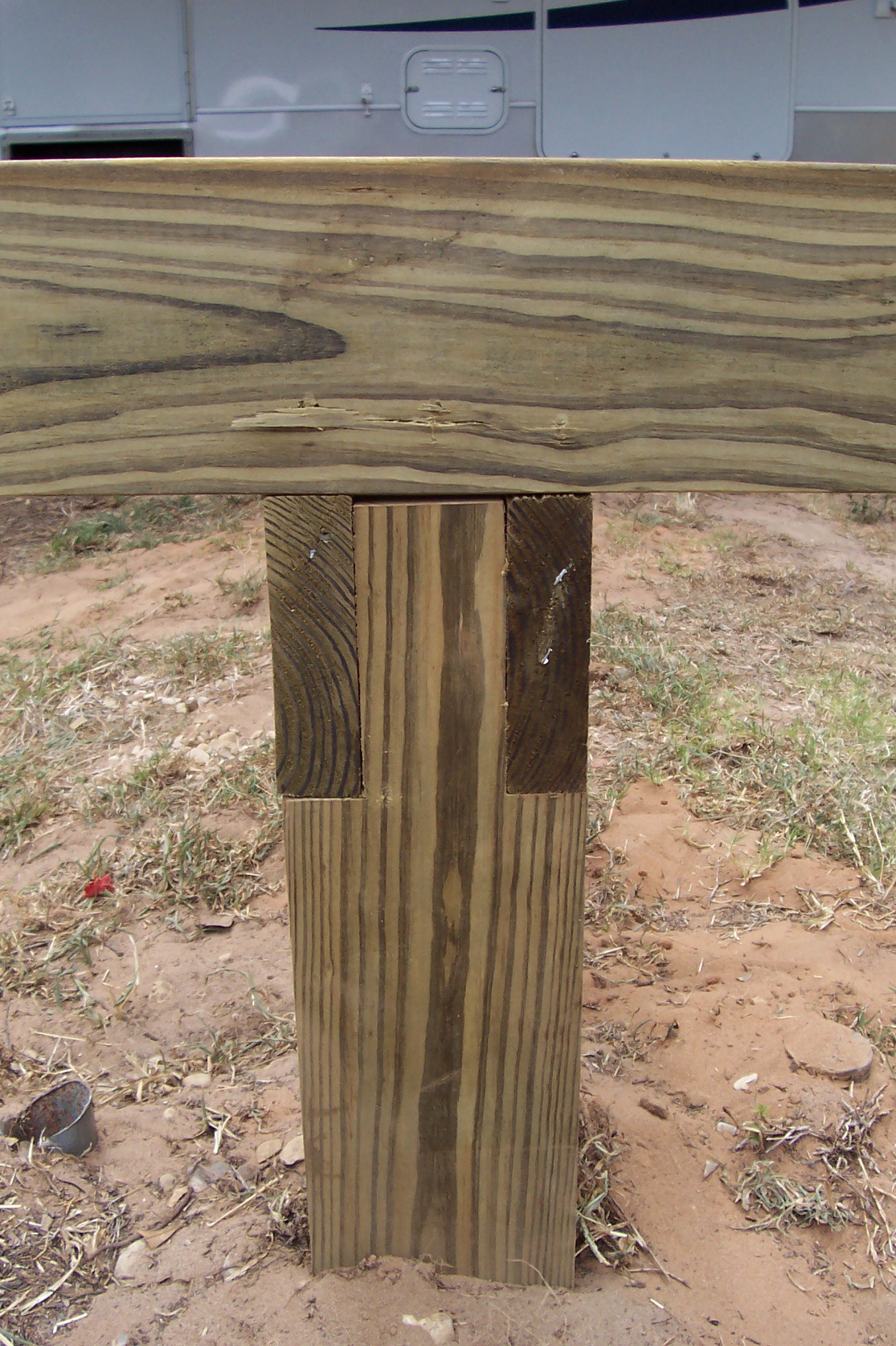

Mike... going back to post #138. How did you attach the rail posts to your deck?
Reason I ask, local "handyman/carpenter" replaced the decking on my 15'x45' deck while I was out of town. One end of the deck is 6' above ground and the other end is 18' above ground. The deck rails used to be so secure that you could sit on them without worry. Now, I would be afraid to even lean on them. It appears to me that the ground posts originally continued past the decking and served as the rail posts. It also appears that he cut them off at deck level, decked over them, and then toenailed the rail posts to the decking. He insists that was the way it was originally. I don't think so, but it's too late to debate the problem with him now.
I just need to find a more secure way of attaching the rail posts than his "toenailing" job, and yours looks very secure.

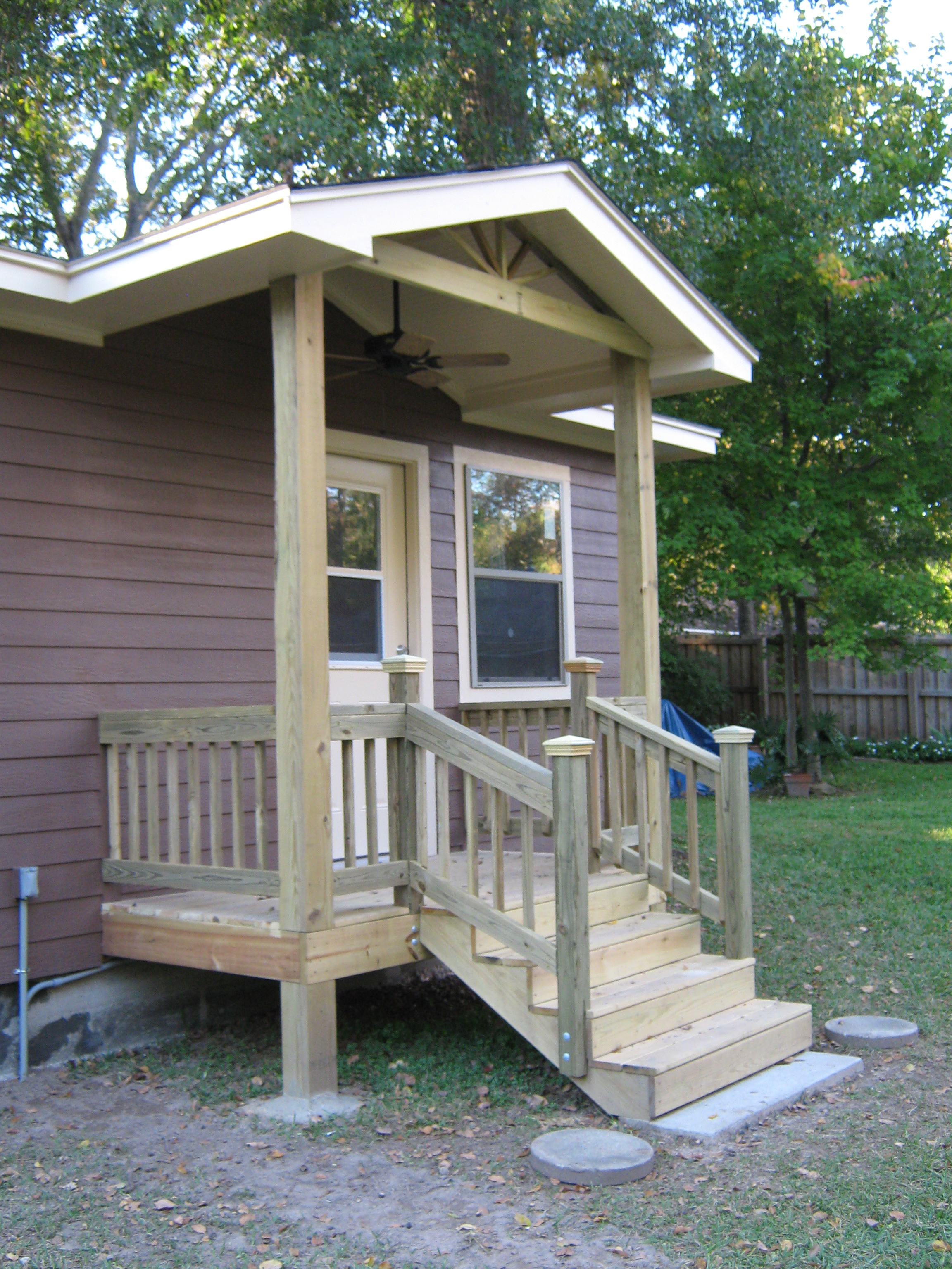

This is a picture of a shed that I built for a client. He wanted a place to sit and look over his yard, so I built a porch for it too. The picture shows how I attach my posts when not going all the way from the ground up. I attach them to the inside of joists and edge boards at the corners so I have maximum strength. They are bolted to the side board with galvanized half inch carriage bolts.
Ideally you want to remove the deck boards, but that's probably not a good option, so you might want to just remove them and install longer ones that bolt to the sides of the joists and edge boards.
Did he attach the joists on top of beams? Did you install diagonal bracing at the outside corners? Did he use screws for everything and avoid nails since they always work their way out as the lumber dries out?
These are my main pet peaves from DIYers and armatures.
These two pictures show the beams notched into the posts and how the joists rest on top of the beams.

Thanks, Eddie. I'll take a look this weekend to see if I can bolt the rail posts to the joists and the beams. That looks like a perfect solution. I think I can cut 4X4 squares in the decking with a sawzall and install new rail posts. He had reused the old railing so I need to replace all that anyway.
All he replaced, was the decking (2X6's), so he didn't mess with the joists, beams, or support posts, and yes, he screwed the decking down. The original deck was built as part of the house in 1976 and all the "undercarriage" is still in good shape believe it or not.
Combination of miter cuts and Joist hangers I bought online. Home depot has about 1/10 of the styles available. To the house, I has Pt Blocks built out from the house header jousts sitting on the sill Flashed in copper and a vinyl plastic cover/ moisture insulator. i then Lagged the PT deck header joist to that and used joist hangers for the decking joists.
O then used cement tubes to elevate the deck posts and 1" galvanized threaded rod and some what I thought were aluminum plates I borrowed from work to make adjustable supports for the deck posts. These turned out ot be magnesium and nearly burned down the workshop when I cut those plates!
I gang lagged together 40' of 4 Piece thick 2 X 12 PT lumber to make the outside deck header, attached the posts using some Cut to shape 8" wide and used my excavator to pick up and set the entire assembly. Much easier building stuff on the ground. Did same with stairs.

OK, I went back and looked again. Originally it appeared that you had somehow attached to rail posts to the decking. Then, I found this pic that I had missed. I can now see that the posts went through the decking. Thanks for the answer.
