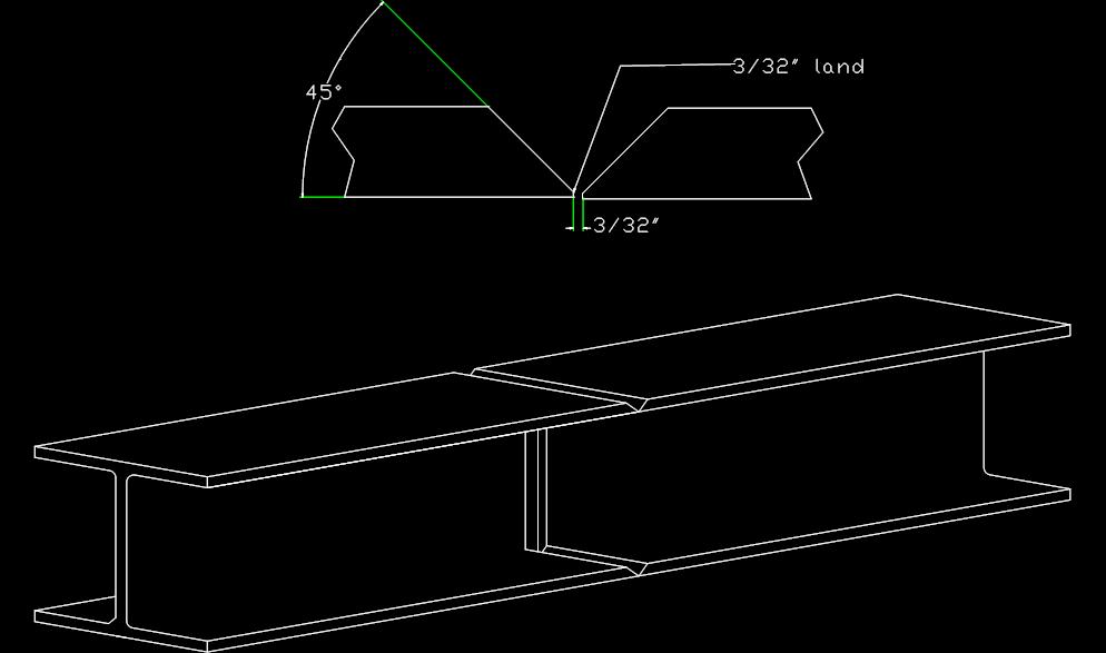

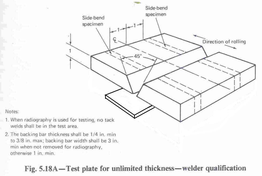

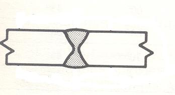

There are several ways to do it. Double bevel, two single bevels with open root, two single bevels with backing plate.
