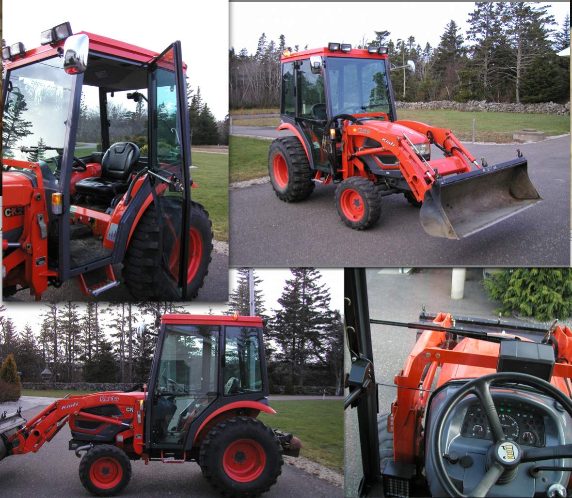

I own a CK25. I feel it to be a little under powered at times. I would go for the 30 or 35 if I did it again. Something I have heard and believe to be true, is that the new quick attach buckets are larger than the older type. Some have complained that they could not lift the bucket if full of gravel. I know that the KL130 does not seem powerful enough for a larger bucket plus the QA weighs a bit more and the bucket sits farther forwards, could be a problem with gravel etc. I am also in NS, Pubnico, Yarmouth Co. I have purchased a Horst 84" wide snow bucket. Awsome for snow but surely not for heavy material. I previously owned a Kubota B1700. The Kioti is twice as fun to use and more solid. I test drove a Kubota L3400 and liked the Kioti more. Its a heavy solid machine with lots of solid metal under it. The steering is unbeatable. The loader control is smooth and well positioned but needs the right servicing to keep up. You will read about it on this forum. Keep reading tips on this forum to keep it running well and keep it indoors if you can. It will last longer than you but they tend to rust if left outside. I built a sturdy cab for mine and love it. I could spend all day in it. I'm sure you will too.

Deon,
just had to say you did a masterful job on that Cab!:)
Bruce

....I also have to add my astonished compliments to Bruce's: Deon, that is a very, very professional job on the cab!

DEON GREAT JOB ON YOUR CAB WOW whatever your up to for work you should decide on building these cabs and selling them Great craftsmanship :)
