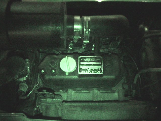

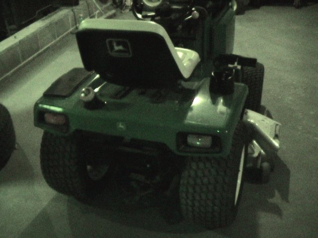

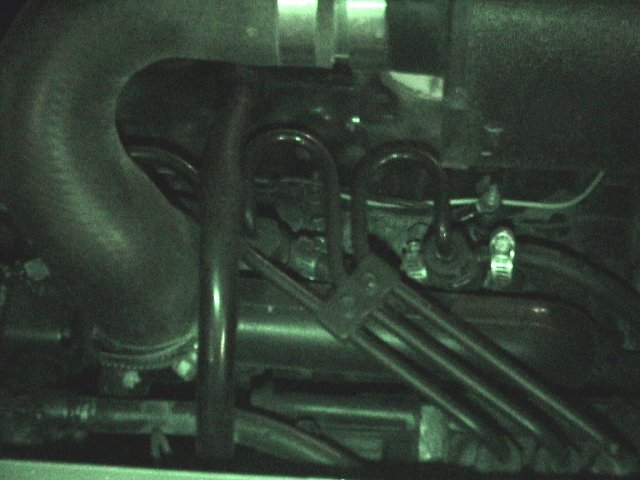

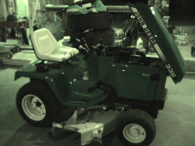

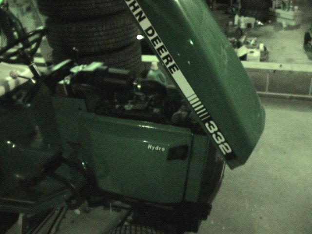

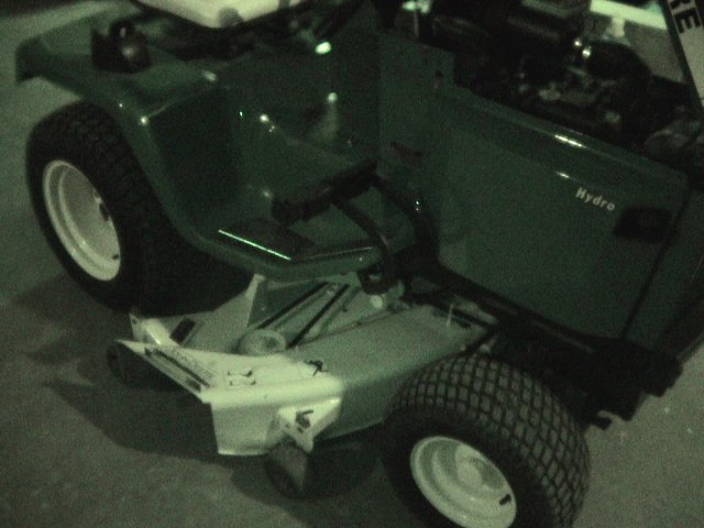

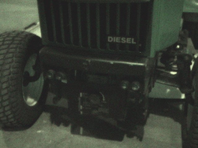

Folks,
I have a Ford 1310 4WD CUT w/FEL, KK BH, blade etc... I am tired of push mowing 2+ acres. Have toyed with the idea of a 5' RFM but due to slopes near the house and neck strain, decided against it. Have been looking at everything for the last 2 wks, both in stores and online, as well as here. I like the Simplicity conquest, Cub 2500-3000 series, JD x4-x700 series, for something of a lawn tractor IMHO. I happened upon a 1988 JD 332 in the local paper for $3200 and the guy dropped the price to $2700.00. The machine is imaculate, he replaced many items new, repainted the entire machine, all plastic, seat, deck look nice. 1300 hrs on the diesel. Drove it yest night, it is really smooth, appears tight, engine cranks right up. Slight tingy noise when it drives, I have heard in other threads that same comment, not sure whether to be worried or not. Bit ashamed to double up on the equipment here, but not sure my CUT is right for the lawn. Images attached, interested in opinion on its worth and future worries. If I pass on this I will likely buy a lower grade JD 304 or a simplicity, as I am just mowing lawn, have the real CUT for the rest and a JD 310 TBL for heavier stuff. I just thought that $2700 for the 332 vs the same for a x304 type (or more) might be a comparable risk. Images attached.
Thanks,
Fitz

Hard to beat a JD 300 series, especially a 332. Good tractor, good engine.
2700 is a bit high to me though...
   / Buy new or a Used JD 332? #3
The 332 diesel is a great machine, no doubt, if in proper order. The diesels can be an expensive venture to repair, but have a lifespan of thousands (3-4k or more hours) if well maintained and will save you a lot on fuel costs.
The sound you heard makes me a bit nervous though. I would spend a few bucks to have a pro ride along with you and check it out again to make sure there are no serious problems related to the noise. What makes me the most nervous is that this seller cleaned it up so well, put a lot of cosmetic improvements into it which could be nothing for a body shop guy, (then noticed the belt covers were not put on the deck- suspicious) and is selling it at such a low price- he might know there is a serious matter with it, and is trying to unload his lemon.
Don't take this info lightly involving the diesel- for instance the fuel injection pump alone costs $700.00. Have a pro take a ride on your prospect- then if OK, it's a great deal.

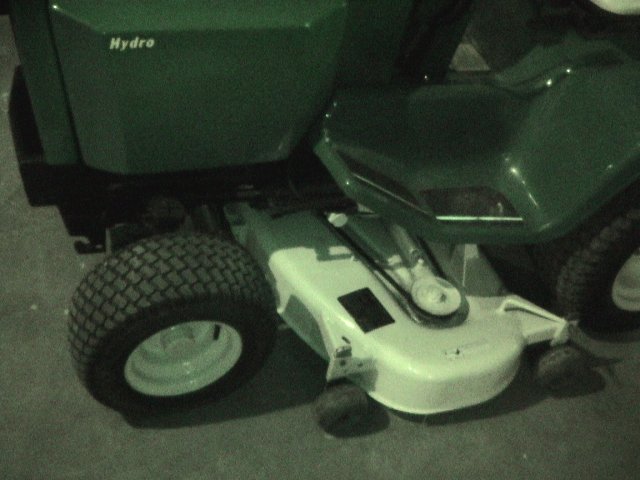

The deck covers are a common thing to be missing. They really are there more for safety and asthetic reasons. They tend to cause grass to build up under them, which rots the deck out. I personally prefer to keep them off, so it is easier to remove grass clumps.
The noise could be just regular old Yanmar noise, could be something touchign the driveshaft. If it starts right up cold, the hydro is quiet, the lift works and you dont see any leaks, its probably a good machine. Just look it over, if you see any parts not lining up, or stuff looks bent....pass.

The Deere 332 is an awsome machine, but I took the same caution mentioned above. It's all spiffed up cosmetically, including non-original "Hydro" decals on the sides, and I too think even lowerd to $2700, it's not that great a deal. The 300 series held a high value for a long time but the last couple of years has seen prices come down. The only thing bad I have ever heard about the 332 is that the cooling system is touchy about having the radiator and belly screens kept clean to prevent over heating. And if the Yanmar is ever seriously over heated, it can be very VERY expensive to fix. But having said that, keep it clean, and good air flow and it can last as mentioned above 3000 to 4000 hours. It also developes a lot more torque that any comparable air cooled gas engine, should you ever want to use this in the garden plowing or for snow removal.
