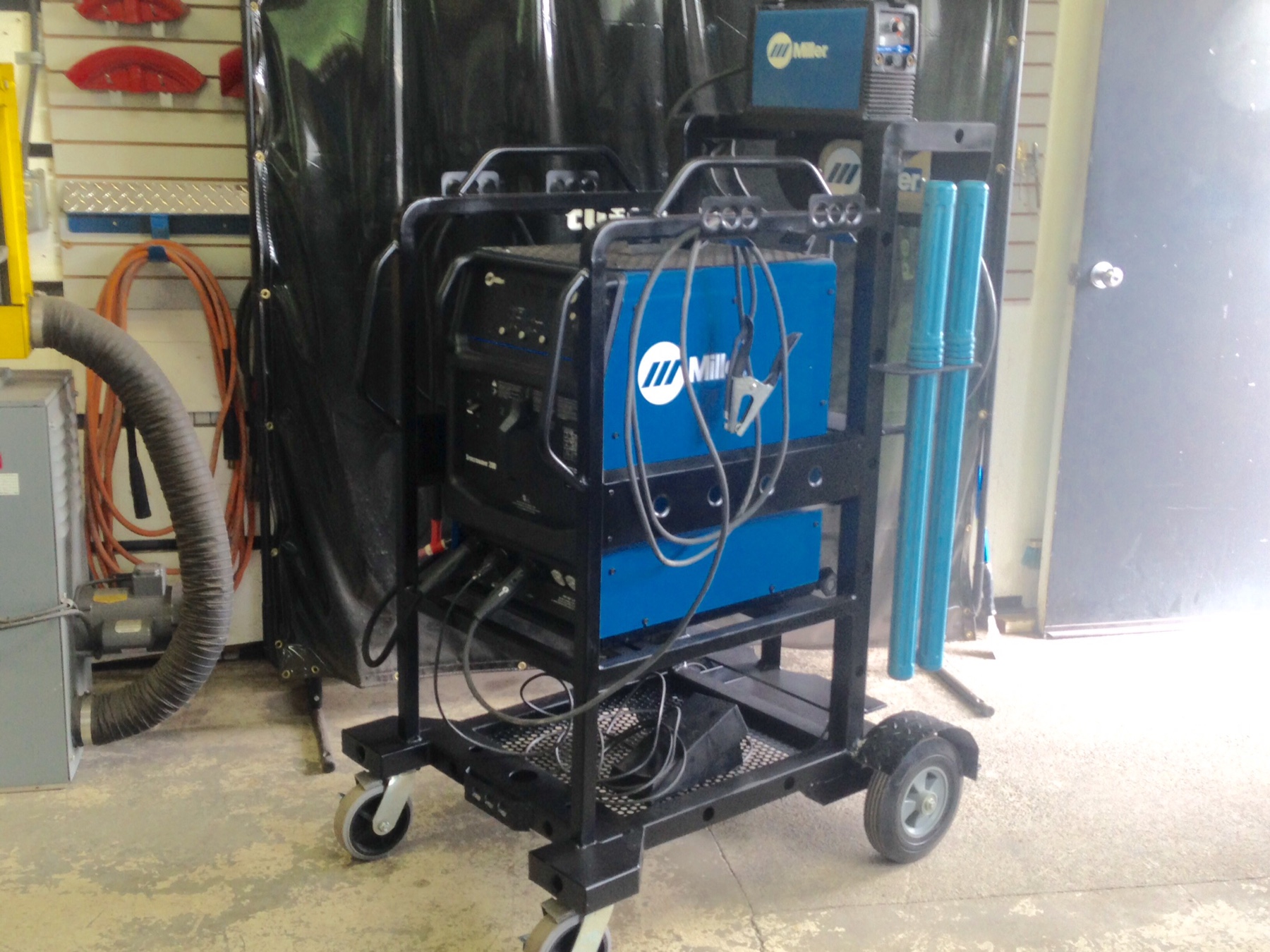

By "our area" I mean British Columbia. I built the cart for it but the buyer didn't need it so I kept it. He was happy to find such a low hour machine, still under warranty.

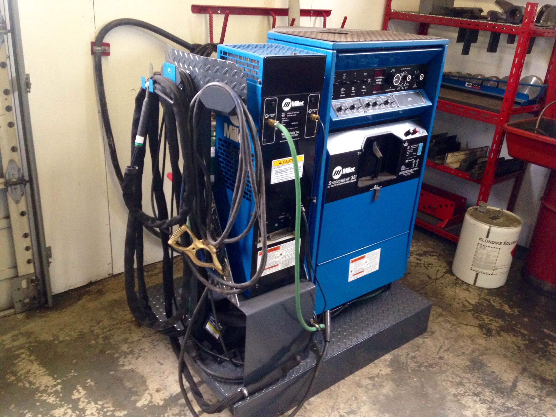

Don't despair. There ARE deals to be had occasionally. I watch Used Victoria/Vancouver and set alerts for Kijiji BC.
Here's my $850CDN ($570 USD) 351 S'Wave after "cleaning it up".
