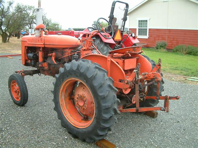

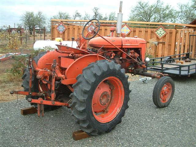

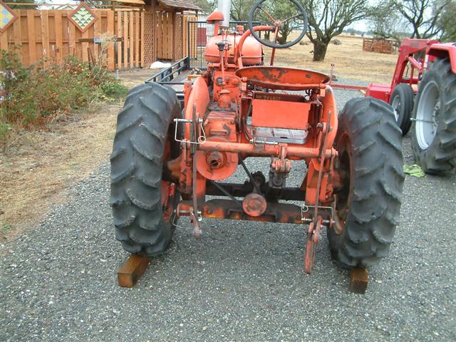

Two years ago I found a 1951 Farmall Super A with a mid-mount 6-ft sicklebar mower and 3pt hitch for $1300. It's in good running condition with the exception of 1st gear (the fork in the tranny needs to be adjusted).
DSCF0126 (Small).JPGDSCF0127 (Small).JPGDSCF0128 (Small).JPGDSCF0129 (Small).JPG
It's less than 20 hp but with only 6 acres of mowing/landscaping, it'll work for you. And there are other types of mowers available (check eBay) for the Super A.

The post above this one about the SuperA, that is a size bigger than a Cub and he is right, it will work well for you but I don't think they have live PTO, 2 stage clutch or Hi-Lo rearend. But if you find one at that price, jump on it while you look for what you really want. It will come in handy for gardens or finish mowing. That really is a cultivating tractor though.

I mentioned the Super A because I was trying to stay within the OPs $2K budget.
