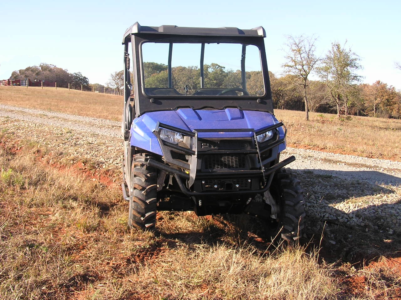

UTV Purchased - Model, Manufacturer, Model Year
Polaris Ranger EV, 2013
Purchased New or Used
New
Yes Would Purchase Again
YES
Favorite Features
30 horsepower AC Induction Motor. No warm up time, just get in and go.
No, Would Not Purchase Again Would purchase Manufacturer, Model, Year instead because of X, Y, Z reasons
