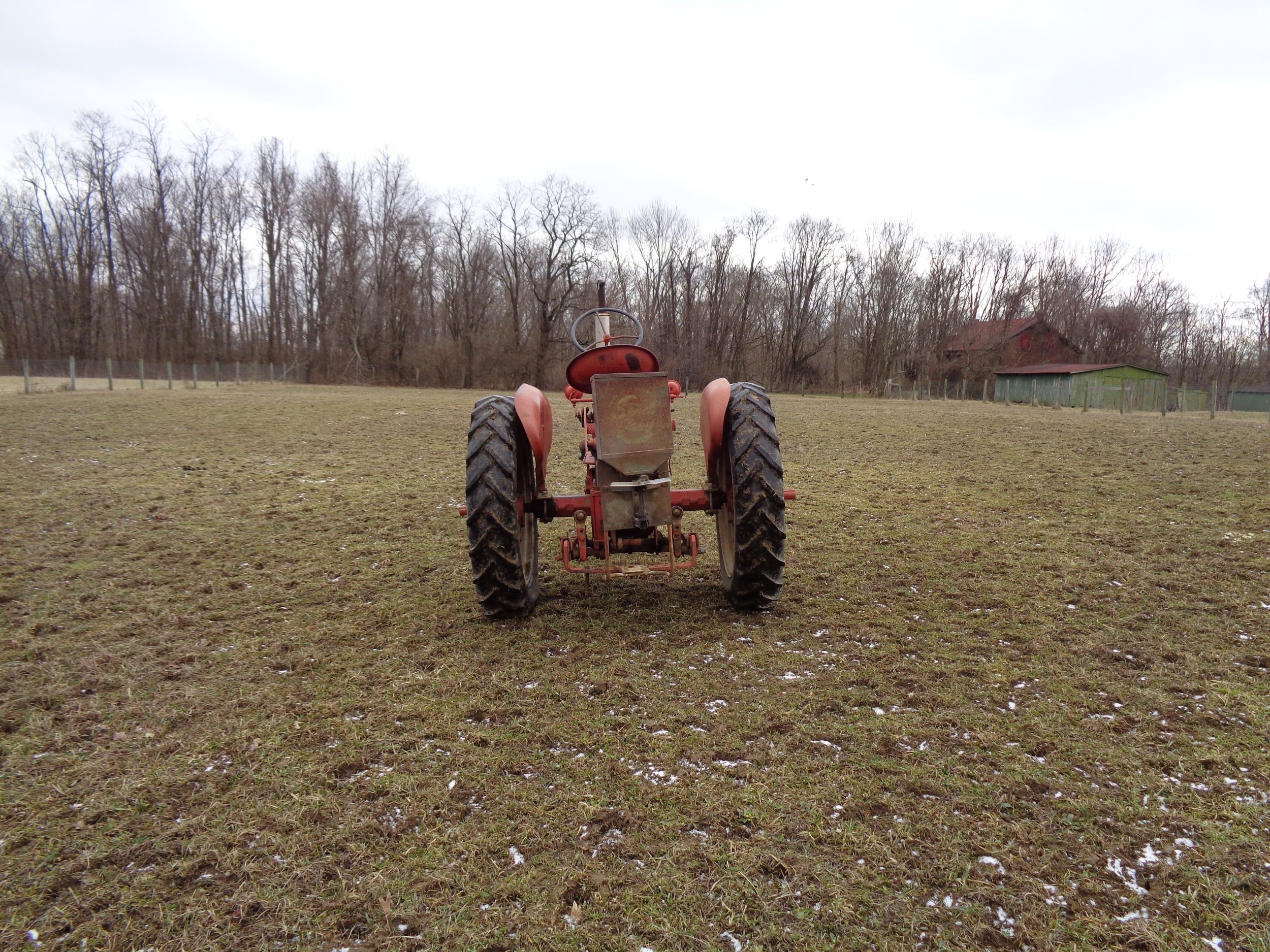

I love my old Garber Seed Easy I do most seeding with. I only do 6 acres so it's perfect for me. It fits on any tractor with a drawbar and PTO. A straight piece of radiator hose is the PTO shaft cut to fit. I only use it on either of my Super C Farmalls so no worry of needing another "shaft" for a different tractor. It only holds about a bushel of seed so that's something to consider, but read they make a larger model although I've never seen one.
It will spread around 20' wide on a perfect little or no wind day. I frost seed most of my grass taking advantage of freeze thaw cycles here the last 2 weeks of Feb./ first two weeks of March honeycombing the ground to pull the seed in. It works very well here if you have the proper weather.

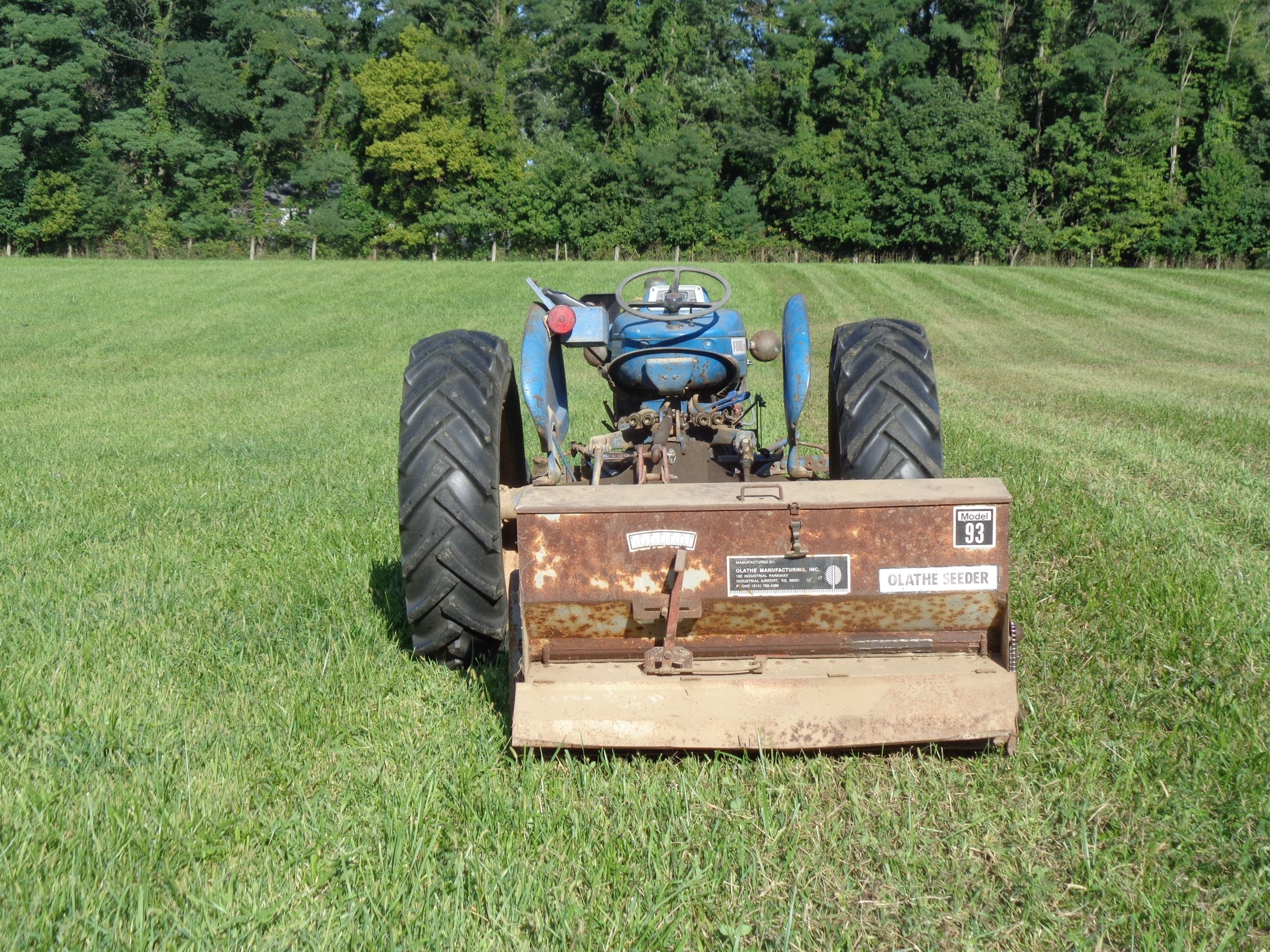

For Fall planting of Timothy I use my Toro Slit Seeder. Bought it at a school surplus sale for $100 so little investment. I use it to get positive ground contact to get it started in early Fall. These can be rented for around $175 - $200 a day. They are only 4' wide, but can seed at 6-7 mph. I've had good stands of Timothy mixed in using it. Only bad thing they are limited on seed size, whereas I can sow Oats or Rye on the garden using the Seed Easy.
The spread rate decal is still underneath the lid on the Seed Easy which comes in handy. I only reseed every 3-4 years so I have a tendency to remember the exact rate. Being it's only 6 acres I have a tendency to seed a little light and if there is any seed left in the hopper go crossways on sections of the fields that were a little light on grass.
I also like the fact the Seed Easy is light, and I can hang it on the wall of the machinery shed until I need it again.
I've never used a Herd, they look like nice spreaders.
