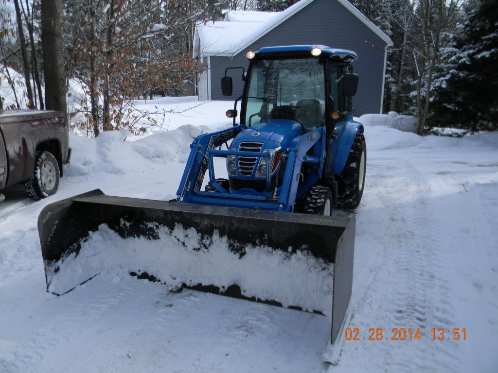

That's a big and heavy pusher box. Mine is 7'6" wide but only about 30" high and weighs about 800 lbs. That 1400 lb. box would work better on a full size industrial tractor but may be too big for yours. I don't have the bounce with mine.
Yeah it's built for heavy skid steers, definitely not for CUT'S. He practically stole it off Craigslist, otherwise wouldn't have bought it.
