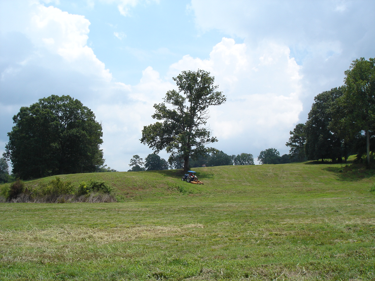

I found all the oil filters at Napa and I was able to pick up Wix fuel filters (with drains) at O'Reileys. I put 14 hours on it this weekend mostly bushogging with an 8' cutter on hilly terrain. It ran that entire time on a tank of fuel so not too bad on fuel. The 4 wheel drive was great, could not have cut half of what I did without it. My only gripes are the emergency brake doesn't hold well although the foot brakes work fine. Also I wish the lift arm lever was a little higher. The stop on the lift lever doesn't allow you to bypass to let the implement all the way down. The stop has to be unscrewed and reset if you want to drop the cutter to the ground. The tractor is very stable on the front with the 1600 lbs cutter. The lift was strong and had no problem picking the entire cutter up. The little 3 cylinder pulled the cutter fine and up some pretty steep inclines too. Here's a few pictures I took.
Fueld up and ready to go. The Duel. My brother does the main cutting with this 9540. I do all the trimming work...
