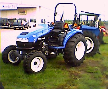

Hey fellow TBNr's,
I have a question for the HST owners out there. I was test driving a HST (NH TC45D with SuperSteer) the other day. It was my first time to ever drive a Hydro. I had a very hard time getting use to the sudden jolt you get when you take your foot off of the peddle to change directions. I have used Shuttle shift tractors in the past and there is a natural feathering when you change directions.
Is this sudden jolt something you learn to avoid with feathering the pedals or something you just have to learn to live with?
Other than that I really loved the tractor and the hydro.
Thanks for the feed back,
   / Buying a first Tractor; HST or not? #77
<font color=blue>Is this sudden jolt something you learn to avoid with feathering the pedals</font color=blue>
Yes, and pretty quickly, too, in my opinion, but it'll sure surprise you when you aren't accustomed to it.
