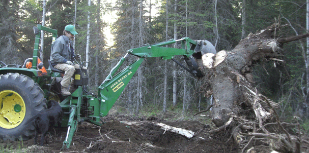

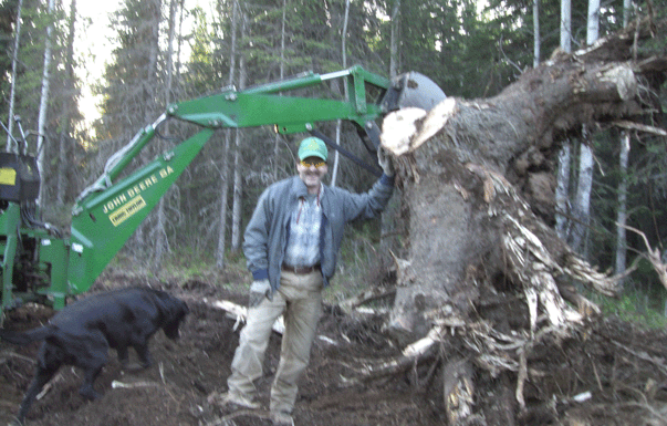

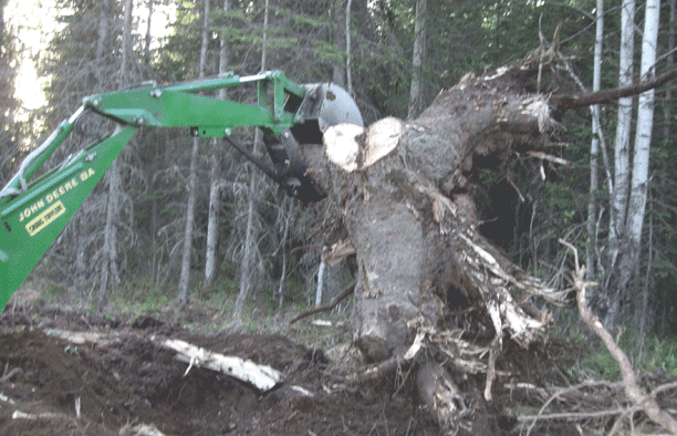

The 8 series of hoes are powerhouses! I loved my 8B that I had on my 970 for the past 3 years.
I dug some stumps that were downright scary big! I'll try to post a couple of pics with one of the bigger stumps that I dug last summer.
'Course the thumb attachment did help a little but...

OK.... let's give this another go! Or maybe it's go number 5 or 6 or... well, I've lost count of how many times I tried to crop these things!
Does using *.jpeg file types make things easier?
Anyways --- the JD 8 hoe is a great workhorse. You'd have a great time; er... you'd be able to work HARD if you get one for your 990.
AKfish
Oh yah, I'm 5'10". So, that stump is pretty fair sized!

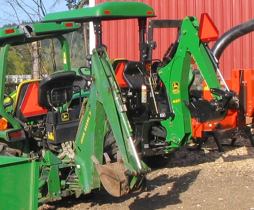

dfkrug, the swing chains hold up OK. The two times that I had them break where always when I was moving the machine off to one side or the other by raising the rear of the tractor off the ground with the hoe and then using the swing to move to the right or left. Evidently this must put pressure on the chain and caused the link to break. I think Deere no longer uses this type swing system on the newer style hoes.

Correct. JD has not used that swing design since the earlier JD7s and
apparently JD8s. Dual swing cyls since then on 7, 8, 47, 48, 447, 448.
