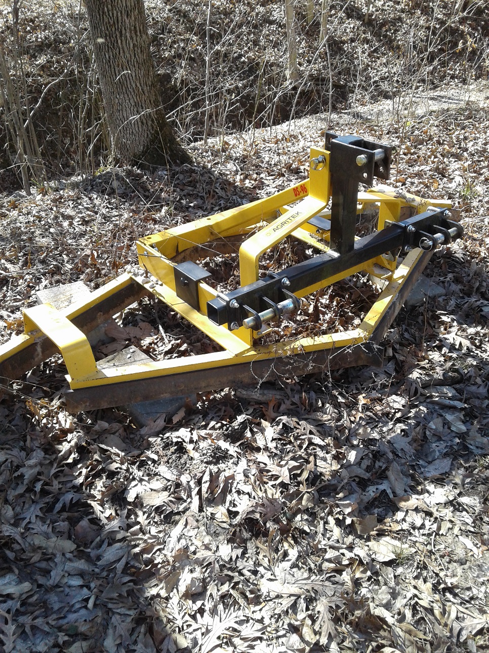

Angled blades move material from side to side. One straight blade cuts material and moves it along until it is needed at that point of the blade width. I would want a scraper with two blades at opposing angles.
Like this one? Really needs hydraulic top link for adjustment on the fly.
Driveway Scrapers - Agritek Industries Inc.
