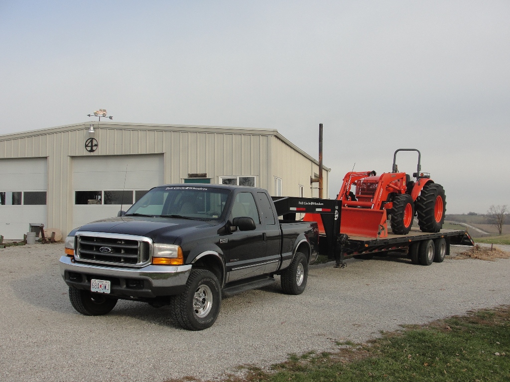

I'm a deck-over guy. I feel they have wayyyyy more utilitarian use than the lower decked tilt. For example I haul my tractor with 10ft brush cutter a couple times a year.
A dual wheeled trailer also pulls more stable and has the ability to move with a flat tire. I blew a tire at 70mph with two Jeep Buggies and a UTV on. Other than rubber scattered on the hiway it was no big deal to get off the road and repair the flat.
As for ramps. The dovetail is about the same height as the tilt trailer when it's not tilted. I removed my ramps and never use them. Very easy to find a spot to load/unload without them. I built a small hump in my parking area that I can approach from either end and load/unload.
My tractor with FEL weighs 9710.
I have a 28+4 deckover that weighs 6840. I pull it with a Superduty Diesel that weighs 6850.
So when I'm loaded with my tractor my GCW is 23,400.
I bought my trailer used. After I added new tires, some brake work and a little wiring I had $4200 in it.

Sorry, I shoulda looked at your links to the trailers before I posted earlier.
I'm a bit concerned about the trailer capacities on those. They are 14K capacity trailers. They weigh 5K. Your tractor weighs 9.5K. Though you can park forward as far as you can and transfer some of that weight to the truck, you are still going to be bumping the trailer capacity. You blow a tire on one of those trailers at hiway speed and you are gonna want to be free of the trailer.... Maybe consider a heavier trailer. Look for a used to save the difference in cost??
I purchased my trailer to carry weight. I park my tractor to capitalize on that. I only put enough weight on the truck to pull comfortably.

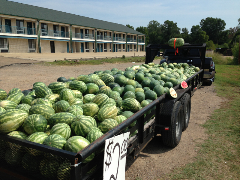

It's a hard to give ya advice since I have low boy and deck overs and dump trailers . Each has its place . I like the lowboy pipe rail goosenecks best for haul me m7040 or any tractor that will fit easyer on and off . And 7k axle of bigger trailer will be fine . Not all the weight is on the trailer .
Here's my trailer I use the most for my tractor its a 24' 7k axles But i have also went to 14 ply tires just to be safe . there rate at 4800 pounds each . I haul melons all summer with it about 10,000-12,000 loaded just the melons .
