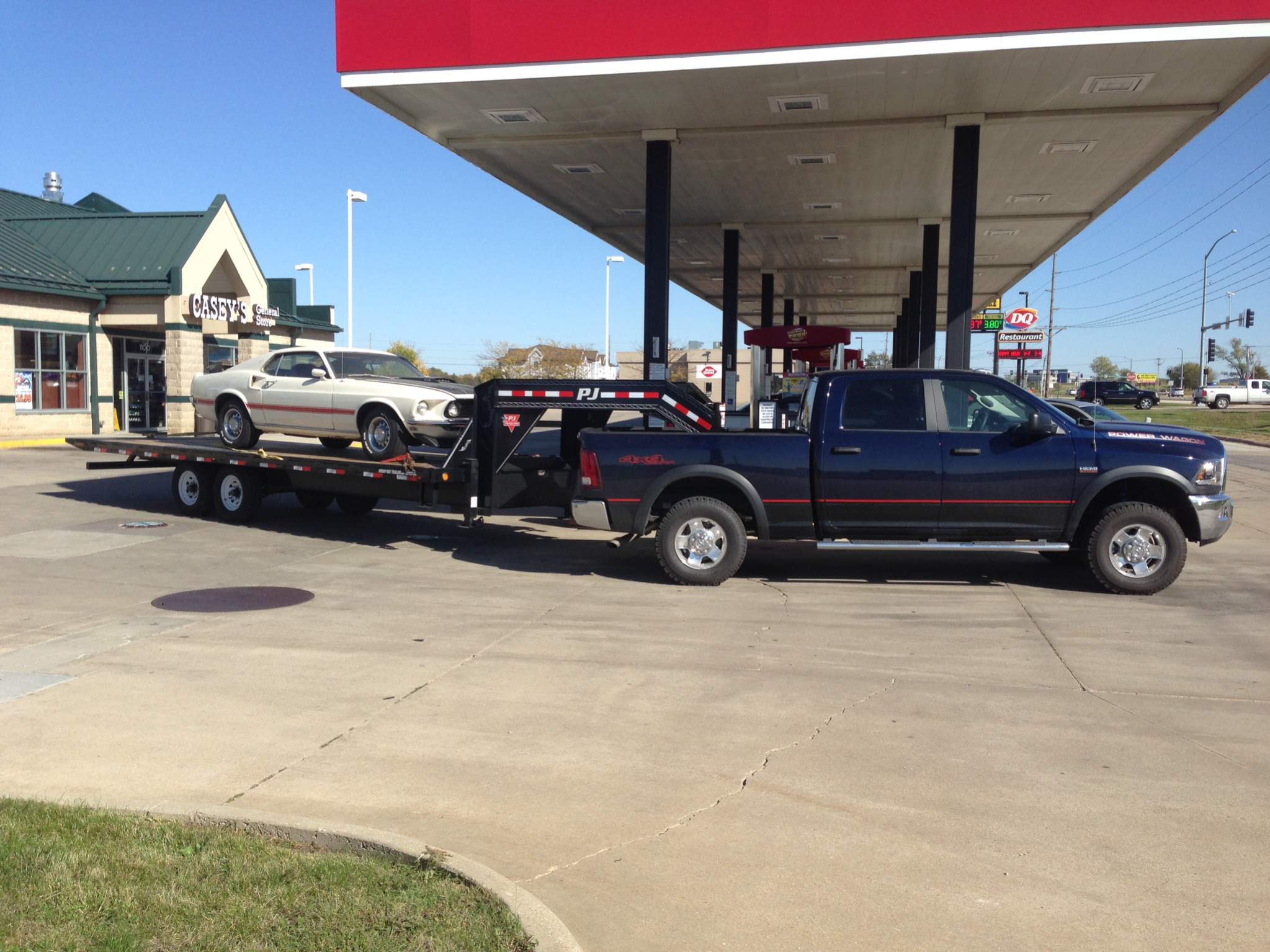

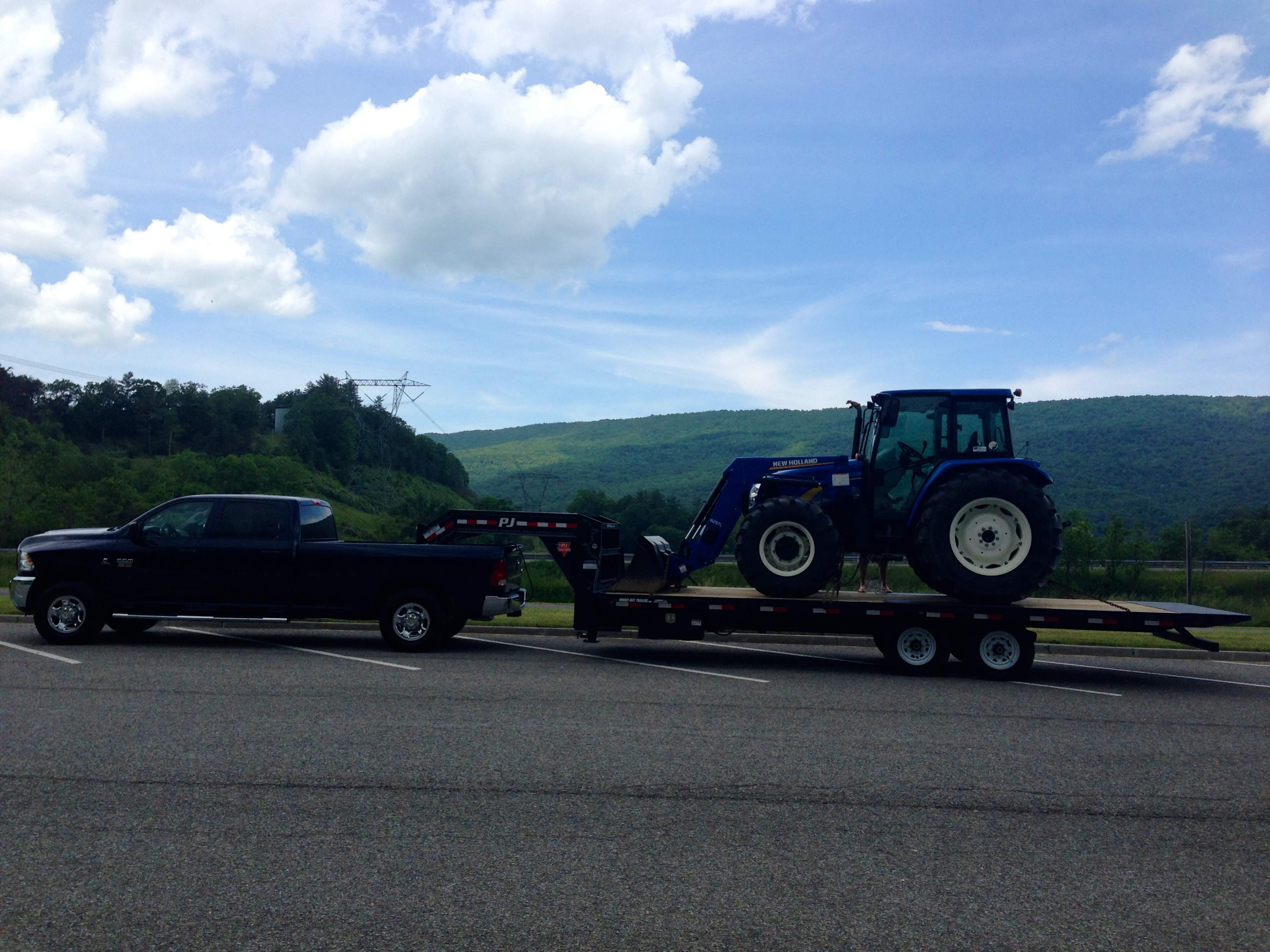

Here is an option for you. 24' full tilt deck over. I chose this one for the flexibility it offers. IMG_0500.jpgIMG_0001_2.jpg

Here is an option for you. 24' full tilt deck over. I chose this one for the flexibility it offers. View attachment 357549View attachment 357550
I looked at that model, too. Thanks for the pics. That's one big NH tractor you're pulling there on them single axes! :thumbsup:
I really am leaning towards the tilt deck lowboy. I like the idea that I can load things other than high-ground clearance equipment on there.

Yeah it's a T5050 pulled it 1000 miles not one problem. I ran between 70 and 75 most of the trip. Next time I have it loaded I'll run it by the scales and see just how much the total load is. It'll be a while before that happens though it's used on the farms and they are all roading distance.
   / Buying a new GN trailer: tilt or deckover?
#15
That's pretty encouraging to hear. From what I see online, that tractor is around 8500lbs?
95% of my heavy hauling will be 30 miles round trip or less. Any hauling at longer distances would be with a lot less weight.
