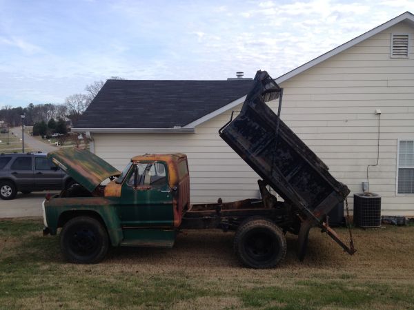

I'm sorry, was mistaken about the 2 speed axle on the '81 truck, it has only single speed axle, and the '68 was not a f-350 but a f-500 has 2-speed axle with 361ci engine, here is a photo of the '68.... I think would make a good fixer-upper;) but the braking is something I haven't considered, I'm sure it will most likely have 4-wheel drums, But I have converted front drums to disk on older cars and light duty trucks, it would be a matter if the conversion parts are available for a larger series truck,

The F500 uses the same cab as a 350. Check the cab mounts.
That's probably a 5 yard box give or take. You shouldn't have a problem towing your tractor while hauling a load.
I can't remember if a 361 is an FE or FT series. Both are good. Both are thirsty.
Make sure it will pass the safety lane, and be sure to check on license cost. You might want to give your insurance agent a call to see if they'll cover it for what you intend to use it for.
The truck itself is like any other truck. Just check out all the normal stuff.
67-72 were basically the same. Some of the mechanical stuff through '79 will interchange.
Looks like a fun project.

As an owner of a 1988 F600 flatbed dump, to do it over again I would buy a F350 or F450 with a dump trailer big enough to haul my tractor.
Some of the things to look at on that 68' are: It will be slow when empty and worse when loaded, 6 MPG when empty, if it has 20" split wheels tires are expensive and hard to find but at least you only need 6.
Does your tractor lift high enough to dump into the bed? Insurance is high since it will be listed as a commercial vehicle. And then the brakes. Converting a medium duty truck to discs will be very expensive not just for the front axle hardware but you need to convert it to a hydroboost system also for pedel pressure. How many times a year are you going to use it?
I don't want to discourage you, just that I've been down a similar road. I bought the truck to work around the house and now I end up working on it before I work on the house because it will sit for 6 months at a time. But it did make a cool project.
