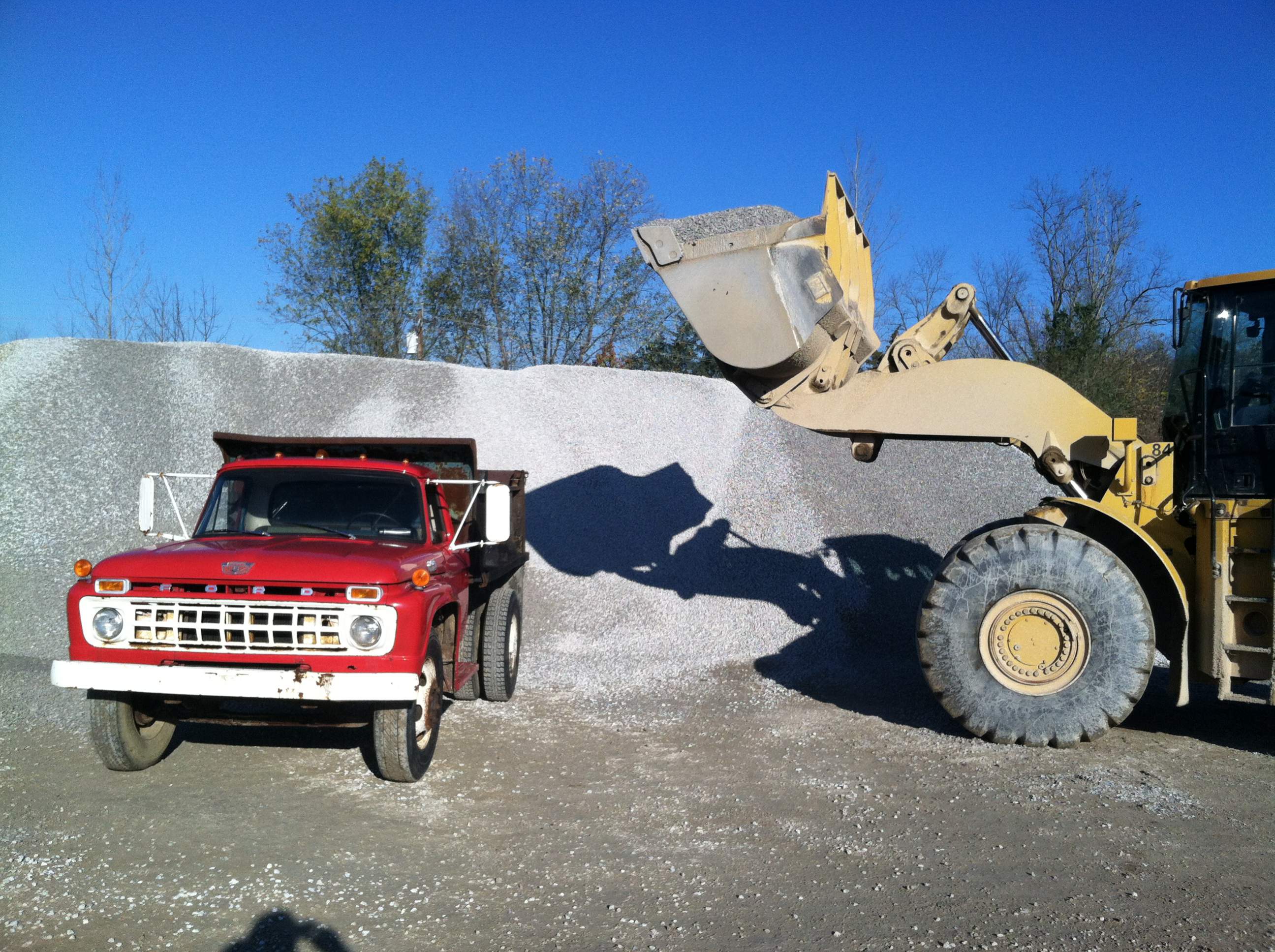

After owning a 76 Chevy C30 12' dump, which I constantly overloaded due to a the large bed and ample big block power LOL I moved up to a 65 F600. Its just a little heavier than your F500. It has the 330 FT motor (same series engine as your '68), 4 speed and 2 spd rear. The one ton dumps are great for mulch and dirt, etc, but its just too easy to overdo it. You'll end up making 5 trips with the smaller truck to equal what the big one can do in two loads.
Even with the rear stuck in hi gear she'll take 5 ton easily and gets similar mileage, and will climb any hill at a walking pace. 4 wheel drum brakes are power assisted and will stop the 20k lb truck in reasonable distance.
I prefer it to the newer trucks that may have slightly higher GVWR but more emissions/electronics/etc. To me the '65 feels like a large F100, and was thousands cheaper than an f450 diesel. I've got $1500 in it, including a set of nice recap drive tires.
Beware certain 80's F600 and 800 trucks with hydraulic brakes - they used a complicated Lucas setup that is a pain to service. They also had 500+ cu in gas motors that were pretty piggish.
